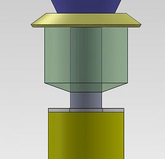

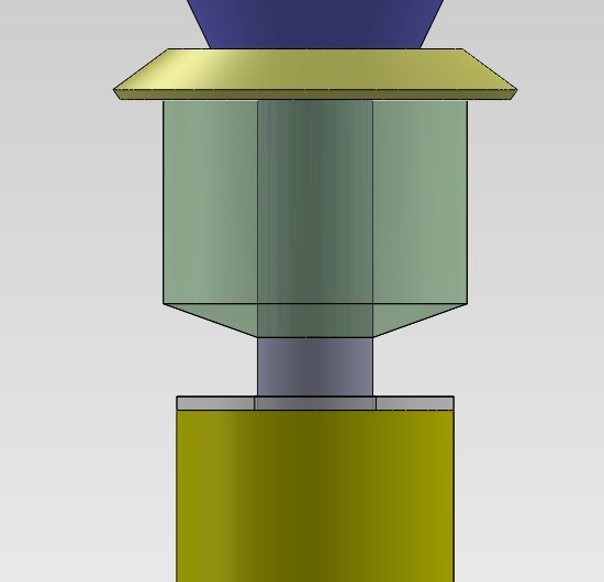

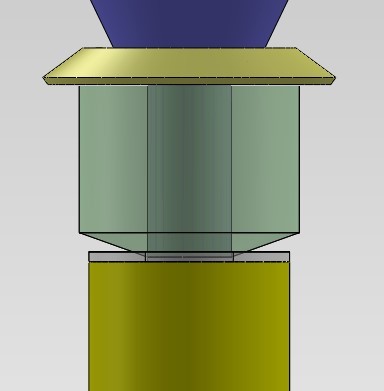

    The E46 M3 only has a small amount of suspension travel. On a stock car in the front, you only have about 1/2-inch before the strut touches the bump stop. This is normal and there are a number of reasons for doing it. It's BMW's way of creating a progressive spring and a "flat" handling car, minimize camber loss, plus probably to meet specific government handling requirements. Stock ride height up front is 14.25" from the hub center to the fender edge on my '05. By going to a "conservative" 13.75", it's now resting on the bump stop before you even encounter a bump.
    Here you can see a graphic of the strut body (yellow), stock bump stop (green) at stock ride height. Koni Sport shocks are the same length as stock, or at least within a few mm.

    Here you can see what a Koni/Dinan setup looks like while just sitting there...

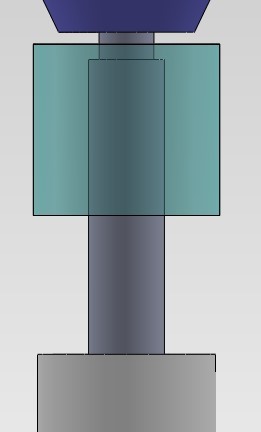

    Many aftermarket shocks are shorter, so that lowering can occur without immediately running on the bump stop. For example, the KW V3 strut is a full inch shorter! Here you can see how it looks at the same stock ride height. They also use a different bump stop geometry.

    Of course, there is a practical limit to how short you can make the strut before you actually need it to hit the bump stop, and prevent your wheel from crashing into the fender. This number is going to vary based on your particular wheel/tire specs and alignment, so it's hard to say what that limit is. On my car, that number is 11.5 inches from the hub center to fender lip. At that point, the wheel hits the inner fender. (stock alignment, 18x8.5 et38 with 245/40 PS4S).
    So as you can see, absolute theoretical maximum travel is only 14.25" - 11.5" = 2.75". In reality, the max it can achieve while still allowing some buffer is about 12". So 2.25 inches of travel. It's not much! By lowering your car that "conservative" 1/2", you've given up almost 25% of the available travel!

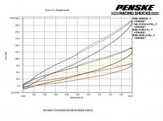

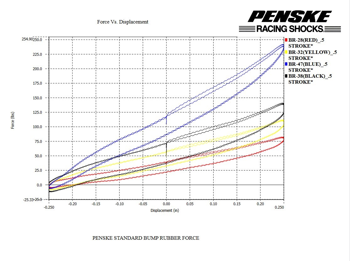

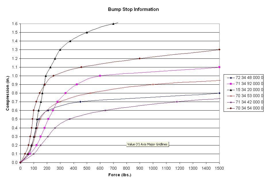

          Welcome to the world of bump stop tuning! The geometry/shape and material will affect the behavior of the bump stop when compressed.
          Because of the McP strut is more-or-less (for better-or-worse) becoming the de facto front suspension, the OE's are putting soft front springs for ride, then tuning the bump stops to suit their needs.
          Bump stops are not all the same. A good bump stop manufacturer will publish Force-Displacement info on their bump stops. I attached info from Koni and Penske.
          If you are a believer in the Flat Ride concept, then the bump stop is critical to how your car will behave at the limits.

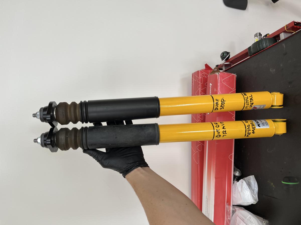

                My findings exactly. I added a 1/2” shim to my Dinan front springs above the spring hats to bring travel back to stock levels. My tired bump stops measured 1” of free travel before hitting the bump stops with the 1/2” spacers. New front bump stops are next up on the list as the tired ones are partially collapsed from the previous owner’s lowering spring install.
                For the rears, I did this (also measuring 1” free travel on my Dinan springs and 5mm spring pads):

                  Absolutely! My personal opinion (coming from the motorcycle world) is the bump stop should be used as just that - a bump stop. Using it has an active suspension component generates rather progressive spring rates. Those progressive spring rates are not matched by progressive (position sensitive) damping. I think of that feeling when driving hard in a corner, and the car starts feeling 'bouncy' because the ride frequency just doubled and the damper can't control things. On an electronic-suspension this can be addressed to some degree.
                  Also my opinion, but I am not sold on the Flat Ride concept. It is based on 2 justifications: referencing OE vehicle parameters (which are compromised), and "fast settling" (which only applies in one very specific vehicle speed/damping situation). I have run a rear-bias stiffness and I'm not in love with the feeling or handling. It feels as though it pivots around the rear while I prefer something more balanced.

                    Fascinating. Did you change anything in the rear? What did you feel from shimming the front up?
                    The rear Dinan springs are pretty nice - linear rate 475lb/in, and barely lower it (only 3/8").
                    The fronts are too short and too soft. They are only 175lb/in and lower it anywhere from 5/8" to 7/8". They should be more in the 250-300 range, but.... then that wouldn't have worked from a packaging standpoint since they already have 0 preload, and the stock fixed spring perch would not accommodate a helper spring. Shortening their travel internally could have been a solution, but I am 99% sure the Dinan Konis are just regular off-the-shelf Konis.
