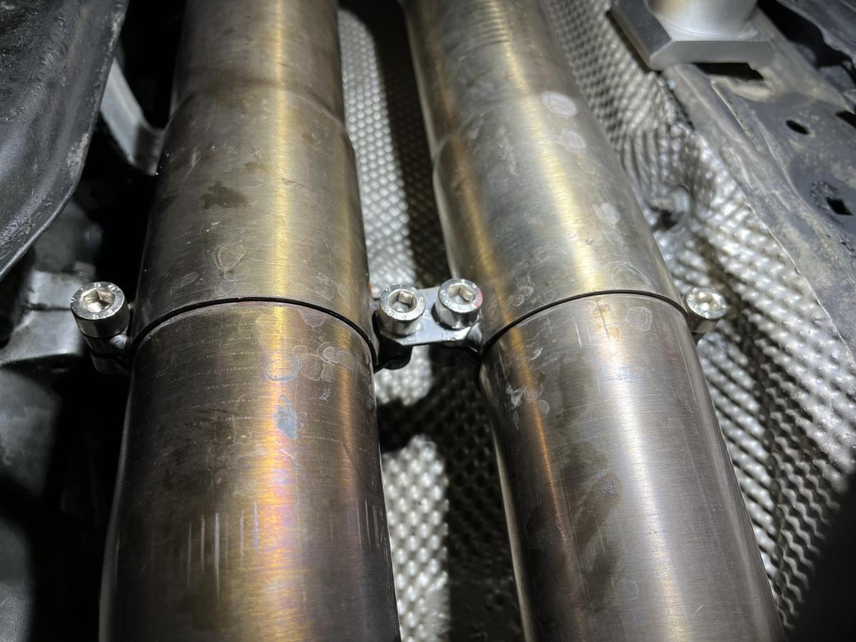

                        And if you’re like me and you hate unnecessary vibration at idle, make a little plate to attach to the header bolts:

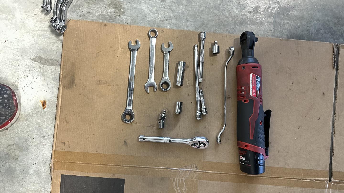

                            In case anyone wants to know, I used the tools pictured below to remove and install the 18 nuts (don’t think I used the longest 1/4” extension tho). To minimize back pain from reaching over the engine bay, I removed as many nuts as I could while the car was on the ground; with the old CPI headers, I got 17/18 nuts from above. Nine of the long studs came out with the nuts, thankfully. The Milwaukee ratchet helped save a ton of time when I was removing the old hardware (10/10 would recommend), but I chose to not use it when installing the new hardware to reduce the risk of cross threading anything.
                            To install the new stock/short studs, I grabbed two of the old nuts and used the double-nut method. Given how short the studs are, you’ll want to use as little threading as possible to allow the stud to bottom out on the motor. Two to three visible threads were all I needed for the second nut, and I lightly snugged it up against the first nut. This worked really well for me and only took about 45 mins. IMO you should stick with the stock length studs. Longer studs will make you hate yourself - those N55 studs may be easy to install, but tightening the nuts will be difficult.
                            I was able to tighten 16/18 nuts from above. Took me 40 mins to tighten all 18 nuts. There was one nut on cylinder 4 that was a little difficult to tighten bc a hard line was in the way; a little patience and my wrenches helped take care of that.

                            Edit: I lied. There is rattling under the pass floor, so I’m going to see if adding a small plate helps.
                            Click image for larger version  Name:	BCAC8A23-642C-40C0-A3B8-151473A39EF3.jpg Views:	0 Size:	174.1 KB ID:	197914 Click image for larger version  Name:	FC45A6EE-1516-453C-AEA4-AC17EADF4060.jpg Views:	0 Size:	157.8 KB ID:	197915
