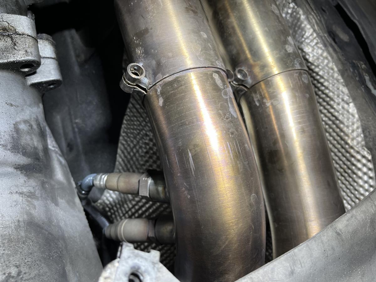

                            It’s a good time to install a wideband O2 sensor instead of a bung or two! You’ll thank yourself later when you inevitably want a tune.

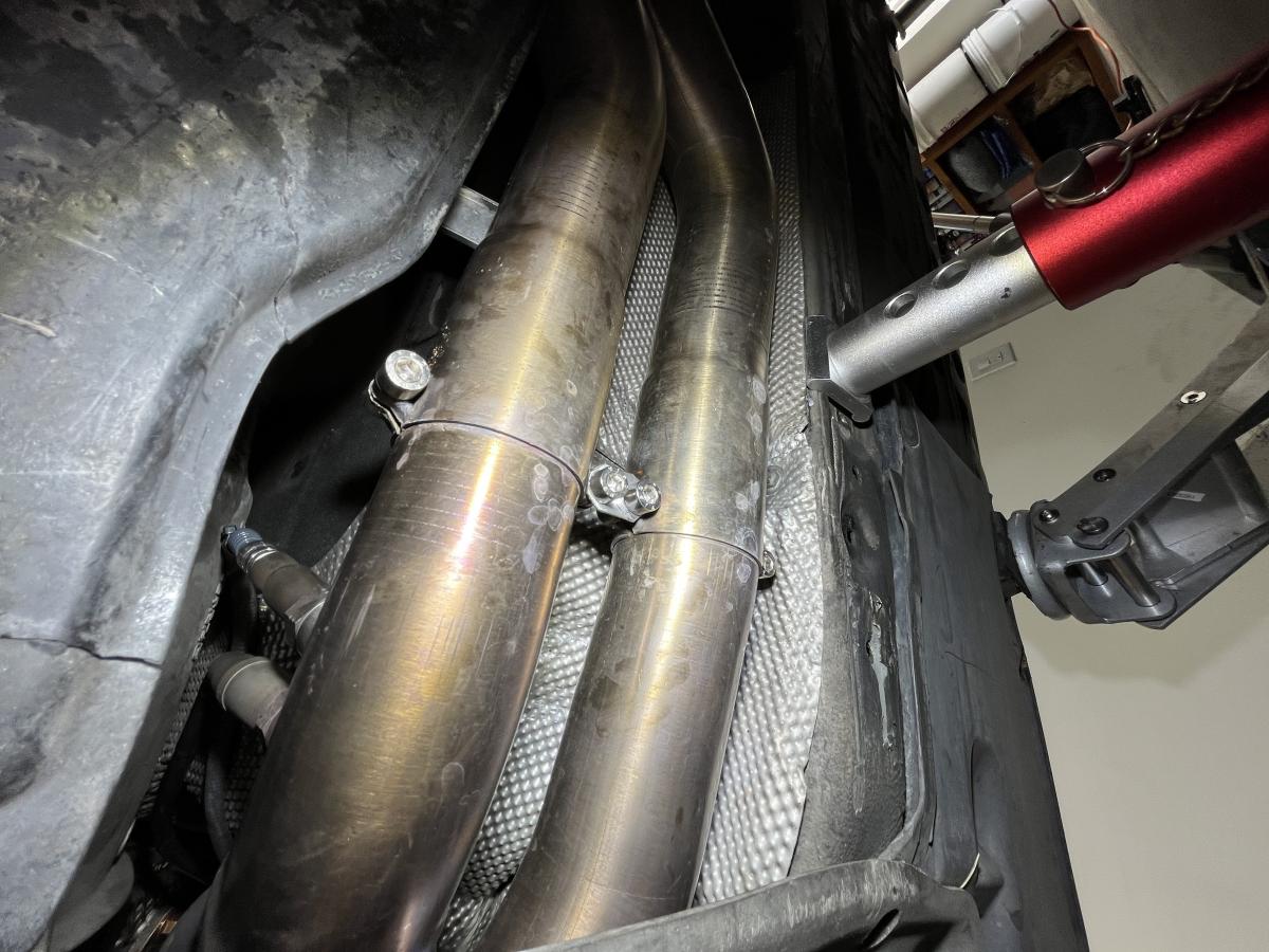

                            pro-tip: bolting a .063” plate between the inner two section 1-2 fasteners will eliminate the vibration at idle and 2-3k RPM with the SSV1 headers/cats
                              Grrrrr. This is exactly what I will need to do -- install a wideband sensor after headers were installed.
                              Hard to tell from the photo, but is there enough room to swap sensors without taking things apart?
