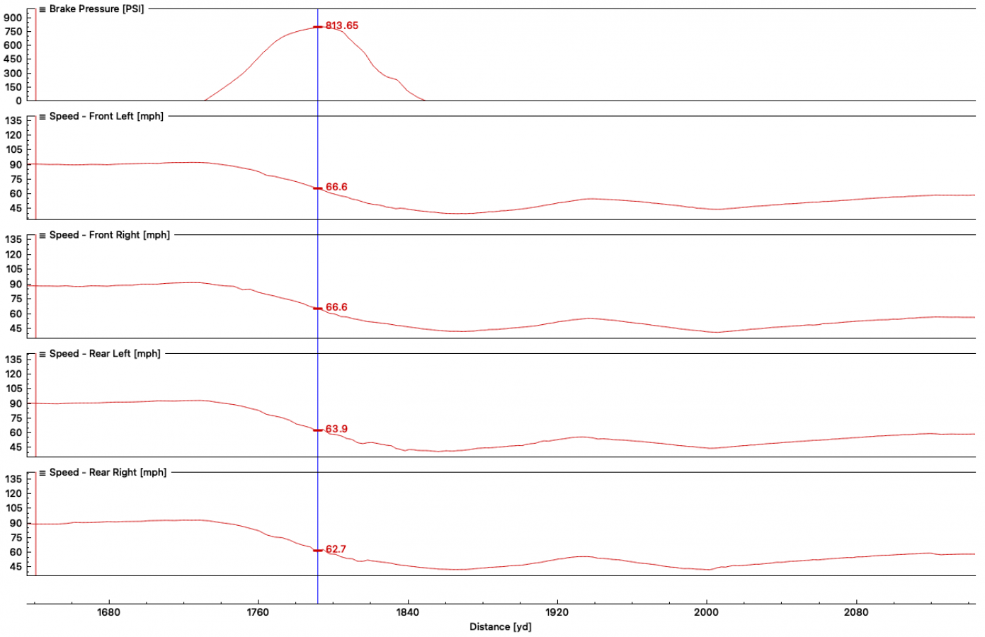

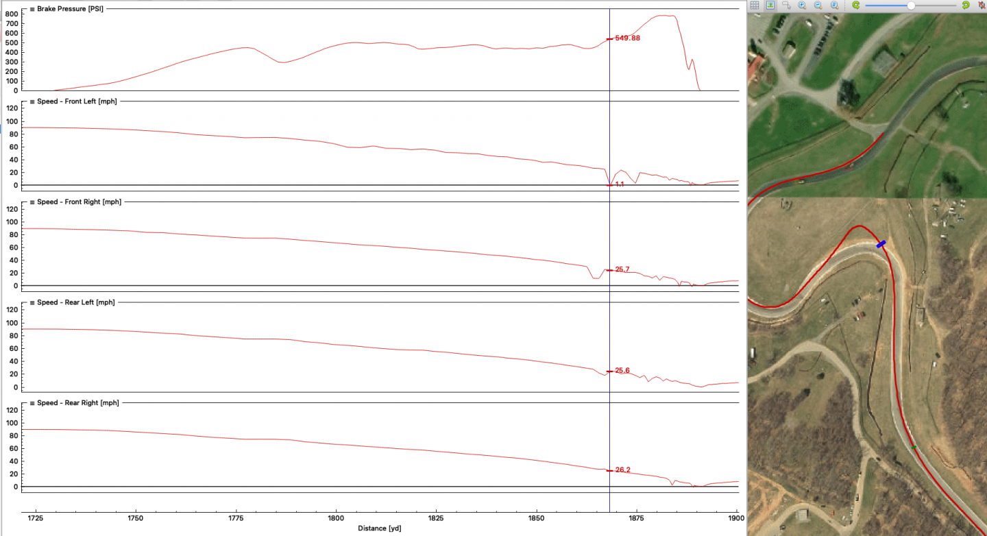

                  For those that like looking at data. You can see that I applied the brake smoothly, you can see brake pressure build up at the MC (these pressures are coming from the factory sensors). So its not like I jammed on the brakes suddenly. You will notice the wheel speed traces go nuts but that isnt until I am off track and in the grass where slippage would be expected.
                  Initial braking point (fairly early for T5):

                  First indication of wheel spin:

                  Blue line on the map will show you where the car was during these events.
                    I'll note that the position plot (L to R) suggests you were offline on the left painted curbs in the braking zone for T5.
                      The map overlay isn't the most accurate. Its not in the screenshots above but looking at the T1 trace it says that I basically hopped the curb and completely cut the T1 corner which I think I would remember .
                      The ICE mode kicked in on initial brake input way before the painted curbs in T5.

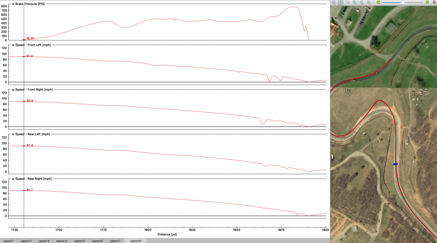

                              Fast forward over a year later and this issue still plagues me every time I am on a push lap going into T5. Similar trace as above nothing really pops out to me as a root cause other than the rears starting to lock up which is expected when braking hard downhill.
