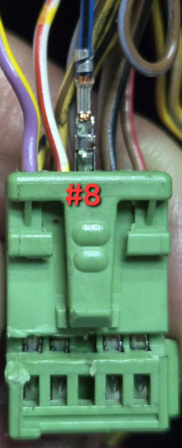

                Resurrecting this post- i am adding touring wiper stalk with the S button on the end to use for M track mode button. My ZCP was convetted years back with cruise control and radio and i love using them. Now i am adding the wiper stalk and need to find the OG wire for pin 8 to X10170. does anyone know the wire color of pin 8 x10170? It was removed but should be tapped up somewhere under the dash not being used but i can't find it under there and i don't know what color wire to even look for? Picture is the cruise control pin 8 wire. I need to find the M track mode wire. Thanks

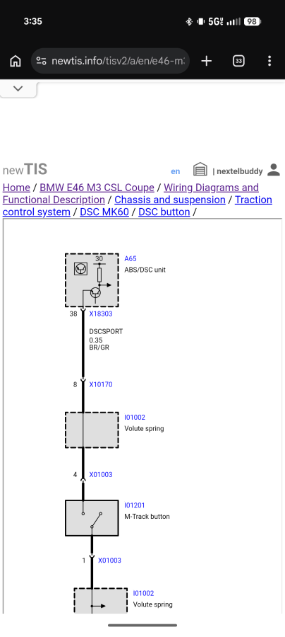

                  In ZCP/ CSL, Wire for x10170 pin 8 to DSC pin 38 is brown / grey

                    I found it. Thx
