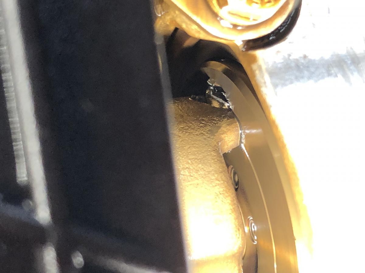

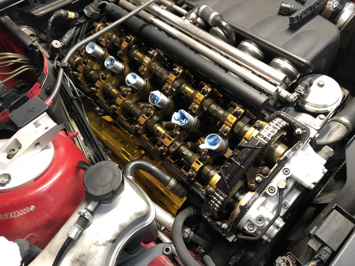

    Over the weekend I was installing a new valve cover gasket while trying to chase down a nasty oil leak thats been dripping on my headers for a while. While in there, I decided to do a quick visual inspection of the VANOS and it looks like i have a broken tab. The other one is still fine…but I know that means I’m on borrowed time.
    I’ve spent the last two days reading and searching and there’s a million routes I could go. I’m looking for input on the reasonable amount of parts I should replace and address right now. Also, I’m utterly confused on Beisan hub is only $400 but the one from Dr. Vanos is $800/$750???
    From what I’ve read thus far, at a minimum I need to replace the exhaust hub and the oil pump disk (it looks damaged from the broken tab). I don’t have any symptom or misfires or rattles right now, but i am at 103k miles on the engine.
    What is really necessary while I’m in there? Any other items that might go due to metal fatigue like I’m seeing on this exhaust hub…particularly those that might cause catastrophic engine failure? I want to do the important stuff now.
    lastly, anyone make a replacement for that hard line with the impossible banjo bolt on the valve cover? It’s such a PITA while doing the valve cover gasket I’m dreading taking it apart every again…impossible to align

    Can't comment on the dr vanos vs beisan stuff, but can help with this. Start that banjo bolt before tightening down the valve cover and get it finger tight. Torque once the valve cover is all torqued down. Much easier to get it on that way.
      i actually tried that route first. i read online that it was the easier way to approach it. but for some odd reason, that was even worse. what eventually worked was getting the cover on, torquing it to spec THEN i was able to get the bolt in...but barely. thankfully it threaded in by hand then tightened with a wrench but it wasnt easy.
              Keep the oil pump disk, but send it to Beisan to have new smaller holes drilled. Don't exchange for a pre-drill unit but keep your original disk.
              For the EX broken hub, I would buy one on Ebay for around $250.
              As the about the metal drain tube, I stuffed the cave with tissue paper to avoid the crush washers falling in, then no issue to thread the banjo bolt at all with my hand - left or right -- once the VC was torqued down.

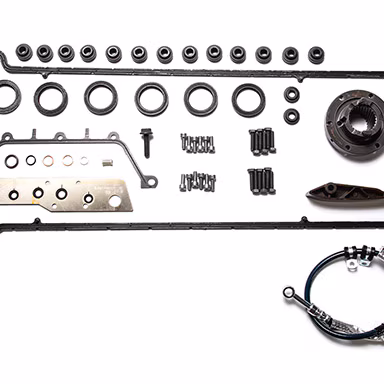

                Upgrade your failure-prone S54 VANOS exhaust camshaft hub, upgrade the VANOS oil pressure hose, and replace VANOS filter/gaskets/hardware.
                VAC hub is good. Unlike most people who hate, I've ran mine for 20k miles. It does great and the play is gone. Do not buy another stock one. Keep your oil disk. The price you would pay for a redrilled disk and stock hub is more than an upgraded one. Heck, my oil disk is a little bashed up from the original failing but the VAC fit perfectly. I linked a kit through Bimmerworld because they're currently my favorite seller at the moment. Probably the best customer service put of any online parts retailers. You can get the disk for $600 at Turnermotorsports but I wouldn't trust them. Beisan Systems is where it's at.
