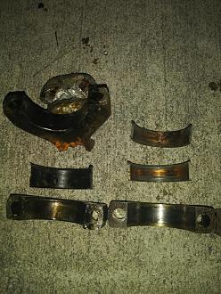

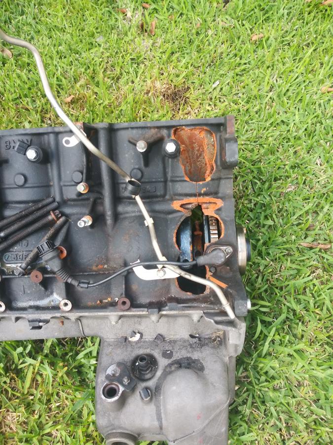

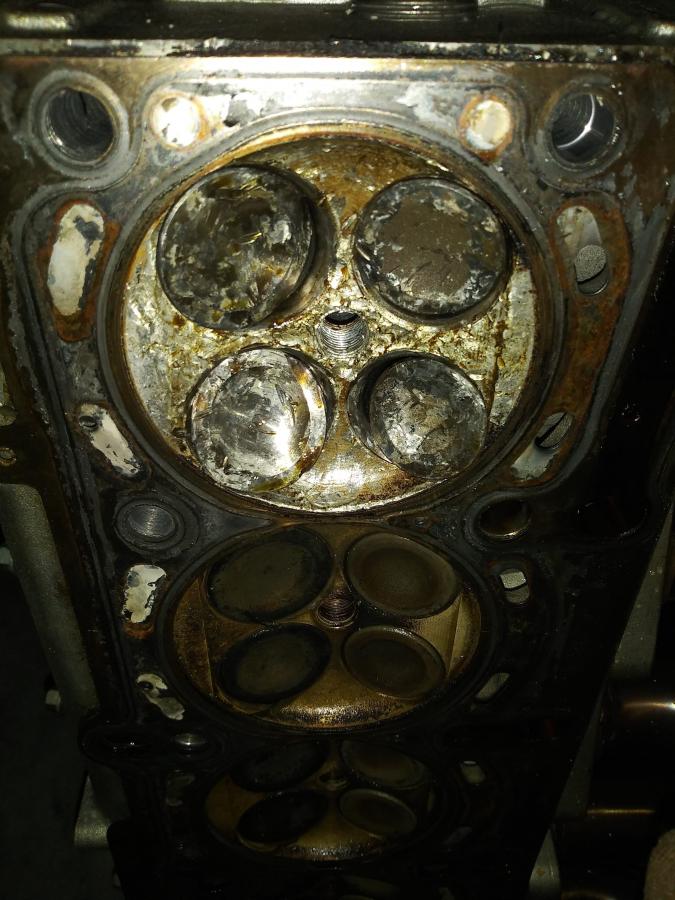

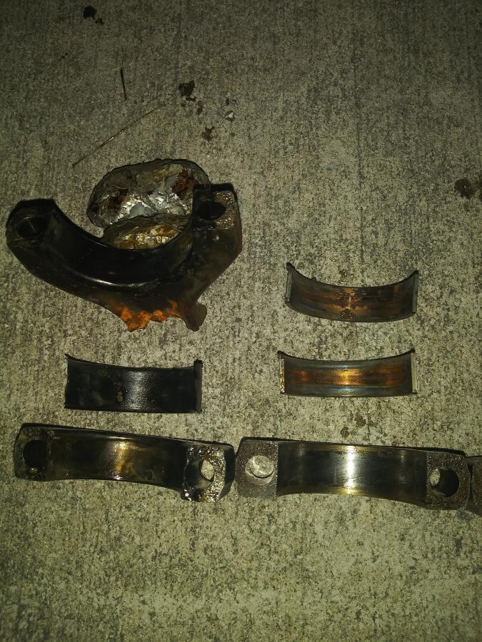

Well, it's sad to say that my engine is no more. What's even worse is that I bought the car last year in May, so I was able to enjoy it but didn't expect to be in this situation so soon. I believe rod bearing 5 gave out and piston 5 decide to make an exit through the side of the block. Before it left though, it was able to tap the head and bend some valves. You can see the damage in the pictures below. Maybe it's still salvageable lol.
A quick glance at the bearings didn't really show excessive wear but I'll have to double check when I get the chance. But, to add salt to the wound, I planned on replacing the rod bearing in August when I was out of summer school. Oh well.
