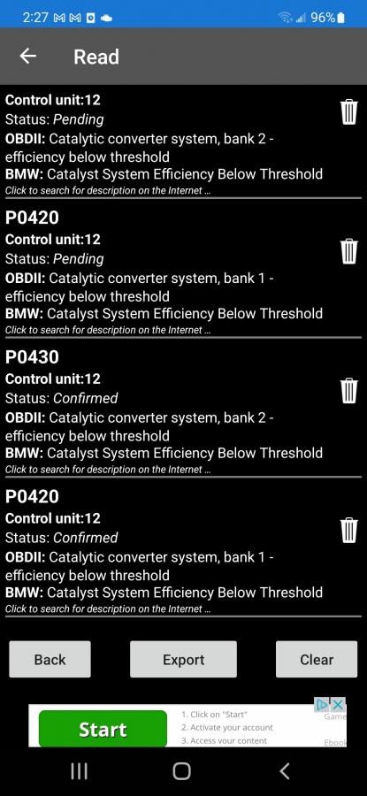

    Installed supersprint headers and cats last winter. Replaced all o2 sensors at the same time. I've put on about 1k miles on the car since then. Today the service engine light came on with codes P0420 and P0430 at the same time.
    Could use some help on where to look first. What are your thoughts?

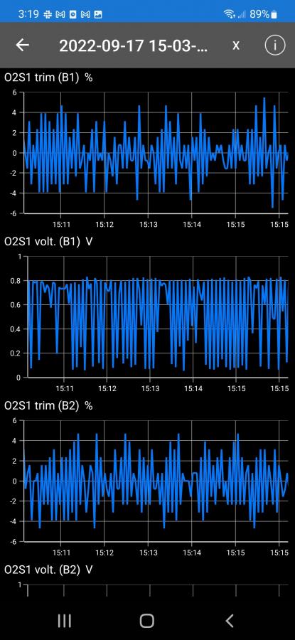

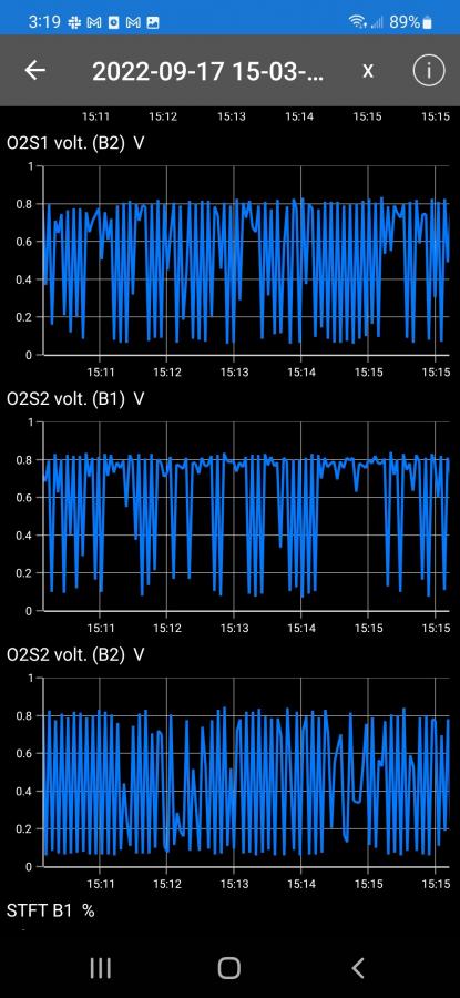

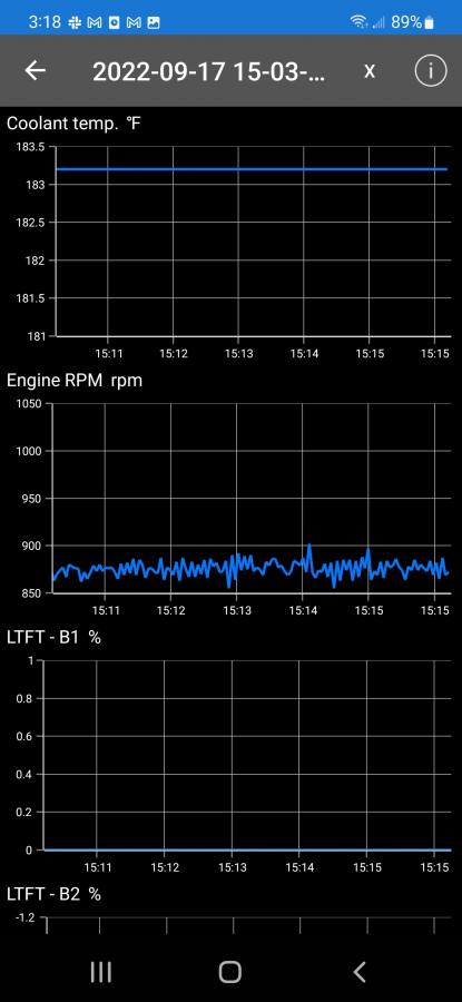

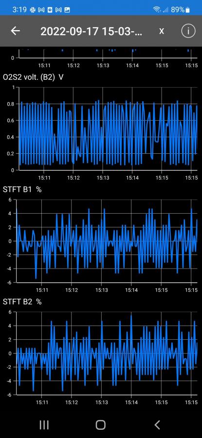

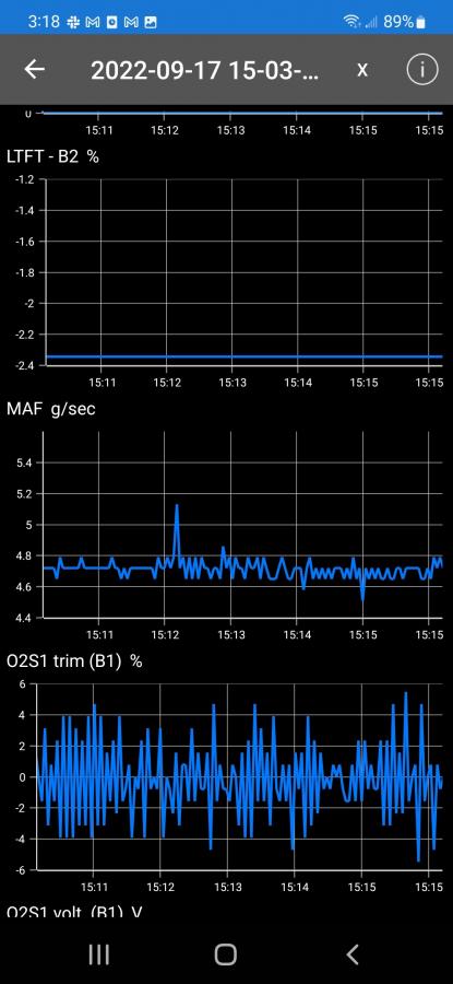

            sapote Finally got a chance to take the logs. Screenshots below and CSV logs here https://docs.google.com/spreadsheets...it?usp=sharing.
            Not sure how to read the data or what to take away from this. Please let me know if you see anything unexpected.

              It seems as if the CATs are doing nothing, the voltage reading should be steady, not cycling same as pre cat sensors.
              o2s2 b1 and o2s2 b2 should be ~0.6-0.7 volts and look more like “flat” lines. Did they forget to coat the cats? Seems like you have empty substartes.
              make sure car is warmed up before logging the data.
                Car was warmed up, but only via idling for 10-15 minutes. Wasn't driven. Will drive around and take more logs that way.

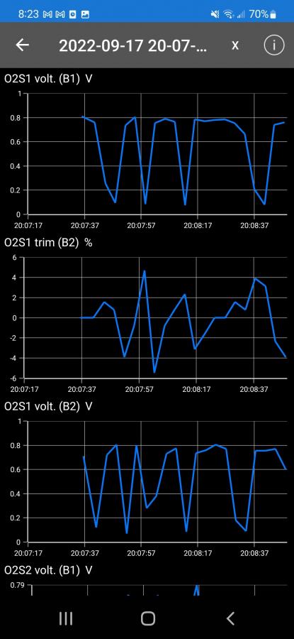

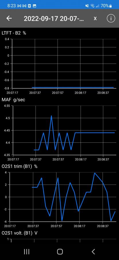

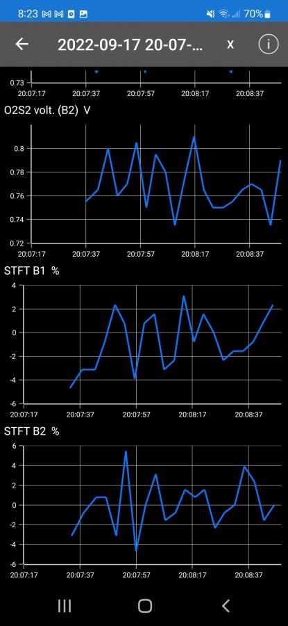

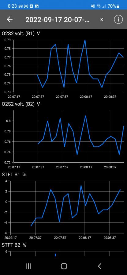

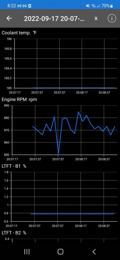

                  Screenshots below are during warm idle after a 1-hour drive.

                    Your cats are faulty, assuming you O2 sensors are good, but based on you data, they are, otherwise you would see a flat line. Basically the rears are seeing the same as the fronts. If you have warranty, use it.

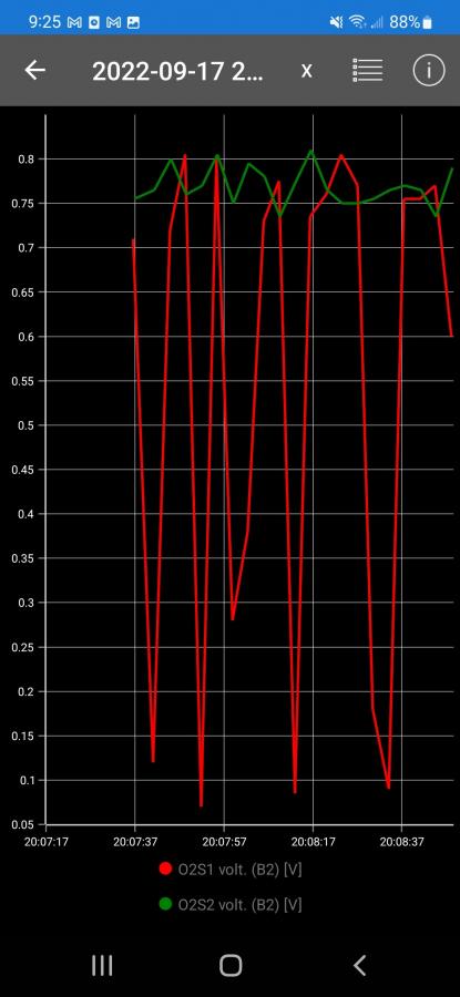

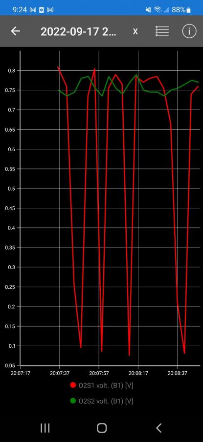

                      Damn, just to make sure though - the y-axis on those charts is a bit misleading. From the O2S1, the y-axis is from 0 to 1 whereas for the O2S2 the y-axis is 0.7 to 0.8 - comparitvely it's certainly more of a flat line than the O2S1 if you plot them on the same axis. Here's screenshots when plotted together.

                        Oh! What a dumb I am!!! I did not look at the scale in detail. They seem to be fine, what i understand is that 0.6-0.7 is correct, yours fluctuate to up to 0.8, perhaps is just that is outside the spec.
