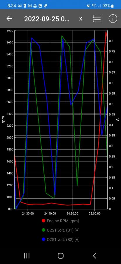

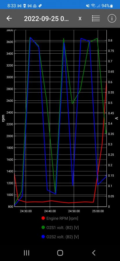

              The saga continues!
              I had cleared the codes some time back and when I last took the logs, the check engine light was not on.
              Today, the check engine light came back on and I started logging again in case there was a difference in behavior. Fortunately I quickly came up to a stop light within a minute of the CEL and got some decent idling data.
              The results look quite different than last time: both o2s2 sensors were showing voltage drops. Does it take some time once you start idling for the voltage to settle, or is it expected to be immediate?

                No, once the o2s2 sensors are hot, they should read stable. Seems your cats gramage may not be enough to convert gases.

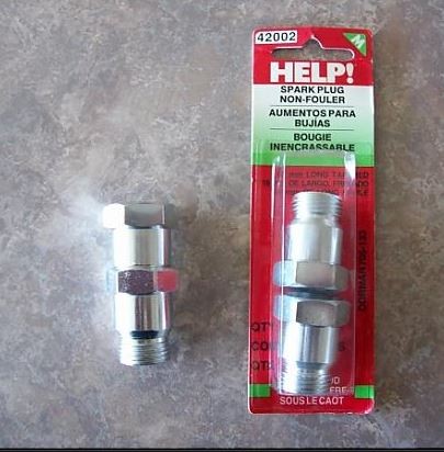

                    I ran into this issue a few years back with my Supersprint setup, but if I'm not mistaken I only pulled up code P0430. Installed 2 non-foulers on each post 02 and solved the issue for me.
                      That can work and is cheap, that's what I did on my WJ jeep after I had the cat removed as it was clogged.
                      You can also get little spacers with a bit of catalyst in them to help them chances, never had any experience with them. Fabspeed (meh) makes a pair that sells for $295 and and then there are numerous similar items for significantly less on ebay/Amazon.
                      Not much space up there where the post-cat O2's are, I don't know if you could stack 2 spark plug de-foulers and still have room for the sensor itself.
                      Example of a cheap O2 spacer.
