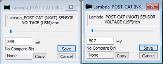

          You should be able to adjust post cat values using Lambda_POST-CAT (NKAT) SENSOR VOLTAGE (USM)lean (K_LANK_USM) & Lambda_POST-CAT (NKAT) SENSOR VOLTAGE (USF)rich (K_LANK_USF).
          Max allowable value is 1000mV.

            Thank you!! So presumably those are the thresholds around 0.45V that the DME uses to determine whether a crossing event occurred. I’ll give it a bit more leeway, 0.35 and 0.55 or so and see what that does with the DTC reenabled. I should probably log the readings too and see what nearly new SS/HJS 100 cells look like on the current tune.

                  So far so good with the codes turned back on and lean/rich thresholds given another 0.05V of leeway. I haven’t driven it a ton but the catalyst efficiency code used to appear pretty quickly.

                            Yep, it doesn’t work. You can go almost as wide as you can on these thresholds and the HJS cats will still throw the code on long highway drives. Anyone who says they have “turned down” the sensors in the tune has just turned off secondary O2 monitoring. They must not get up to a high enough temp on those light load situations when the catalyst testing is running.
