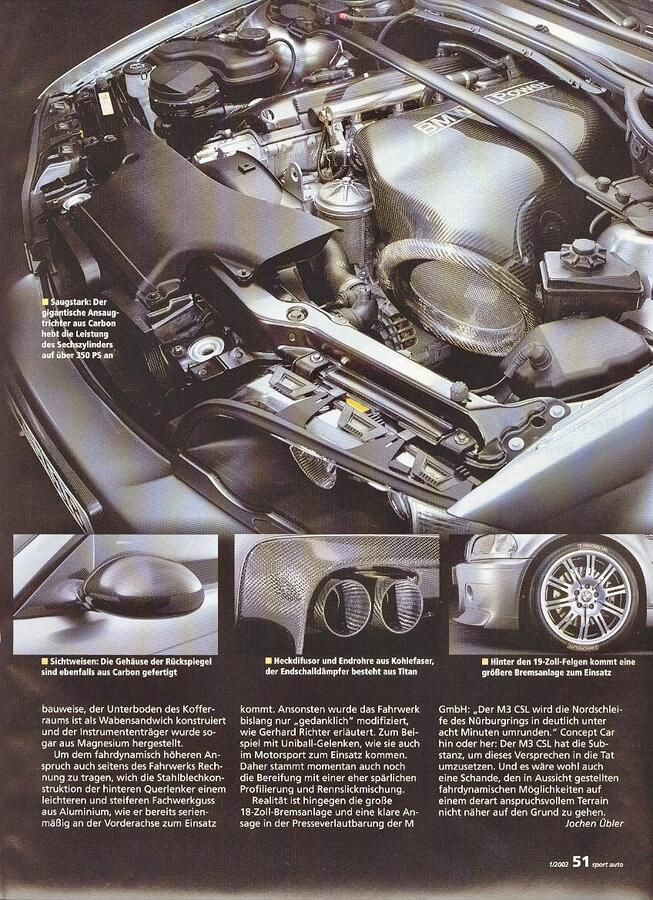

        Ducting from the grill... As the saying goes, a picture is worth a thousand words. There are differing view points equal to Baskin Robbins’ 31 flavors (of which none are wrong intrinsic value wise) so I’ll hand it off to the pics to “speak.”
        CSL prototype engine bay snapped by Sport Auto, published in January 2002.

          I'm looking at a similar airbox. The issue is for proper ducting you need to move the radiator and oil cooler. This is for racecars only as per Bimmerworld and other sources. If you're not prepared to relocate and remake potentially both rad and oil cooler, don't bother.

            I understand that ill have to move the radiator and oil cooler, I need to upgrade both and get AN lines for my oil cooler that'll feed into an inline thermostat. How would the piping work, I assume just buy universal silicon hosing nd cut and bend it to size right? and Which brand are you looking at, I know there are a few others similar to this but Im going with BimmerWorld because I want to buy more form them in the future, and well their reputation.
            And Motosport 24/KK Automobile does race cars and engines for our cars and infact they have this type of intake, and they sell a piece of carbon that allows the radiator to lie down along with the oil cooler, using the front apron to cool it. They use an e46 m3 radiator at least it looks like in one of their photos (Similar upper plastic pipe)
