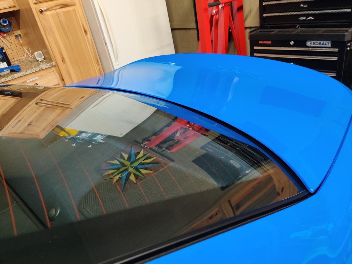

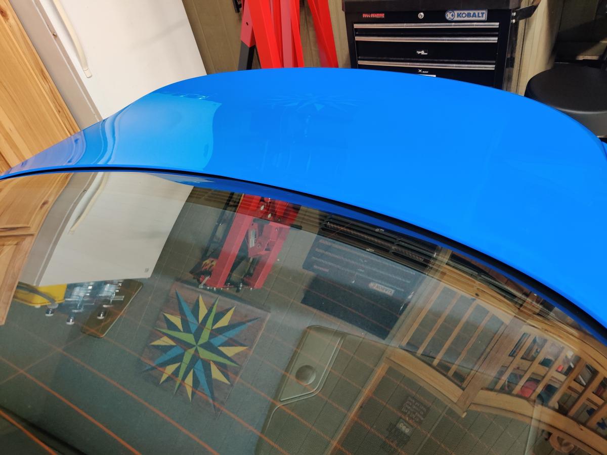

                  Karbonius trunk lip. I will say that I needed to slide the trunk back away from the window or it pinched slightly along the bottom center of the window otherwise. Once slid back, it aligns perfectly with the rear edge lines of the car.

                    Casa, thanks for posting those pictures. Is it an illusion or is the middle much closer to the glass? With the Slonik trunk, mine basically touched the glass even after I loosened all 4 bolts and slide the trunk as far back as possible. I raised the trunk enough the make it flush with side quarter panels. I was getting big gaps on the side and no gap in the middle when my brother has a OEM CSL trunk that is basically perfect with minimal adjustment.
                    If fitment is off on all replicas, I may just order a OEM trunk, I only wanted the carbon for the weight savings.
                      It's slightly off. All the body lines are perfect but the trunk does touch in the center of my window if not adjusted.
                      To me, the weight savings is worth it. I still think the trunk is amazing. Quality is extremely good everywhere else.

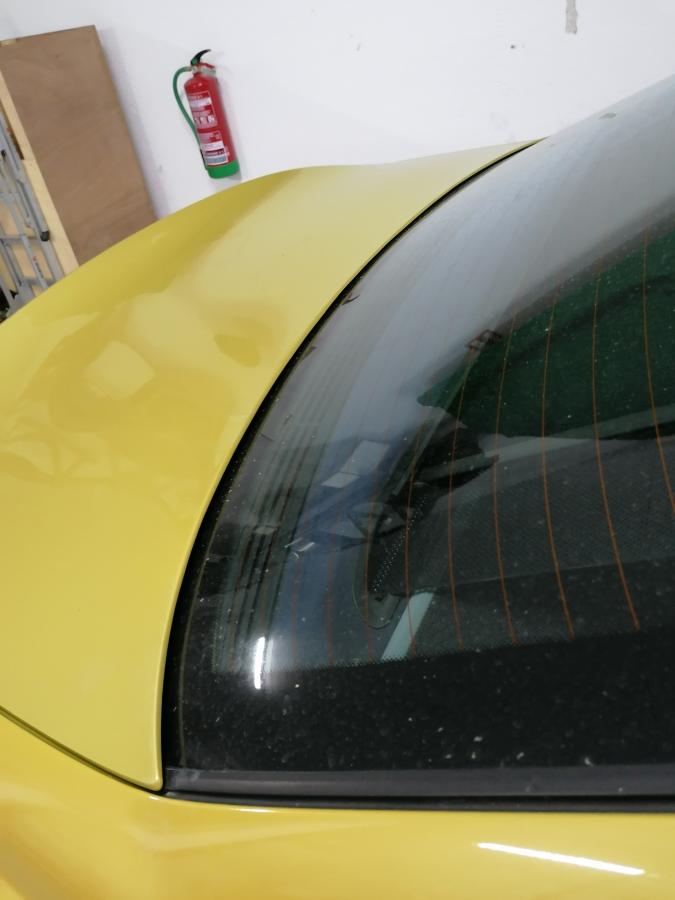

                        This is the difference in how 1st and 2nd Slon trunk was packaged. 1st trunk had thin camo gift wrap and a single layer of small bubbles, trunk flew around banging against corners and because of this corner cracked. 2nd trunk was very well packaged.
                        I definitely don't want to unpackage the trunks since this is the second time I packaged them, I am hours into packaging. Since trunks are not mine(credit card company refunded me), as much as I think fitment is off, I want them to get back to Slon in good shape.

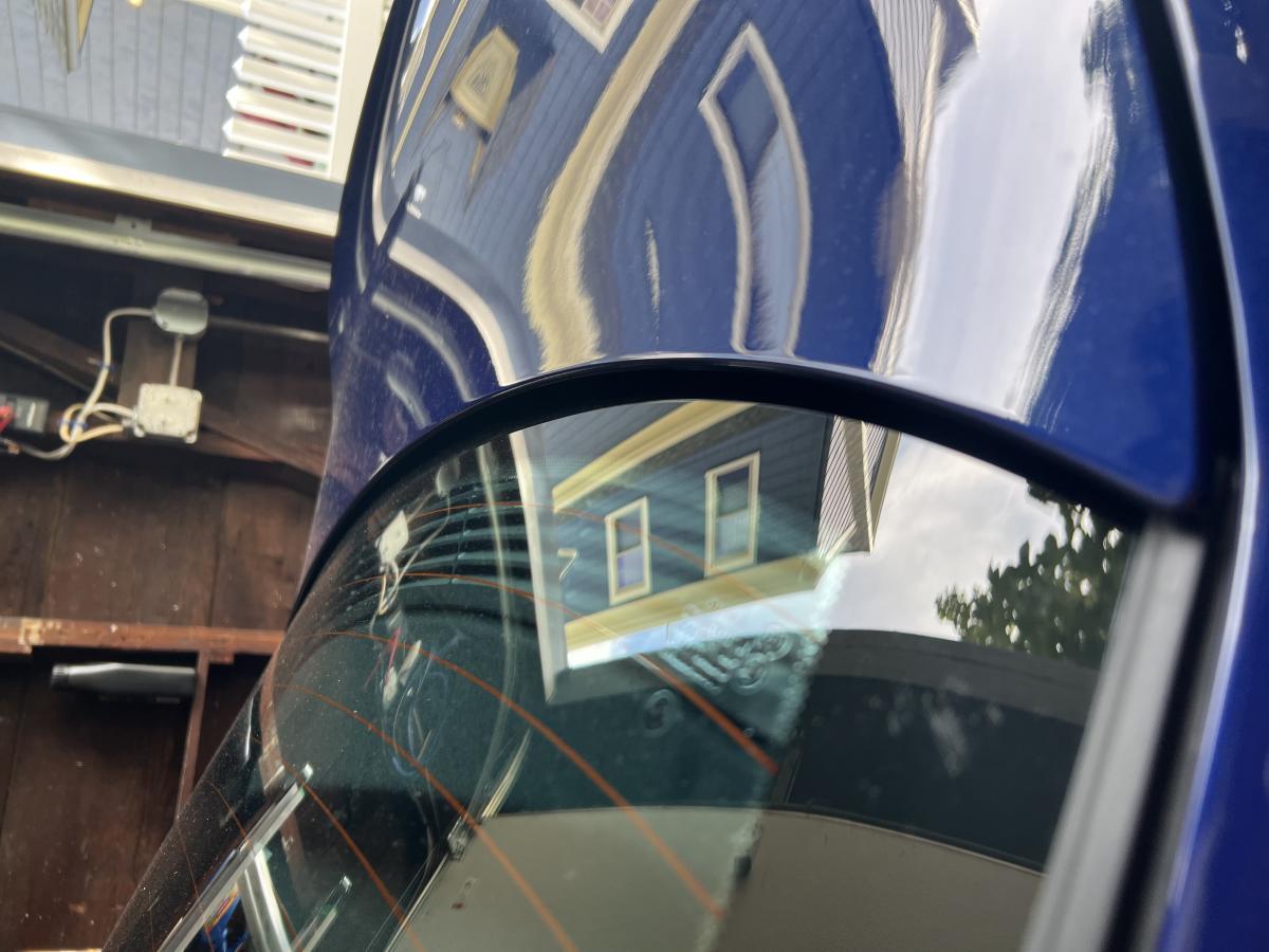

                                Here is my OE CSL, freshly adjusted by me. The Status Gruppe rep that came on my car from the PO touched the glass like a Slon
                                edit: forum image rotation bug 🙄
