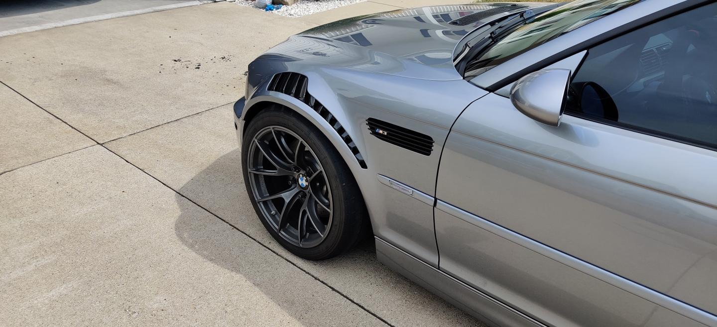

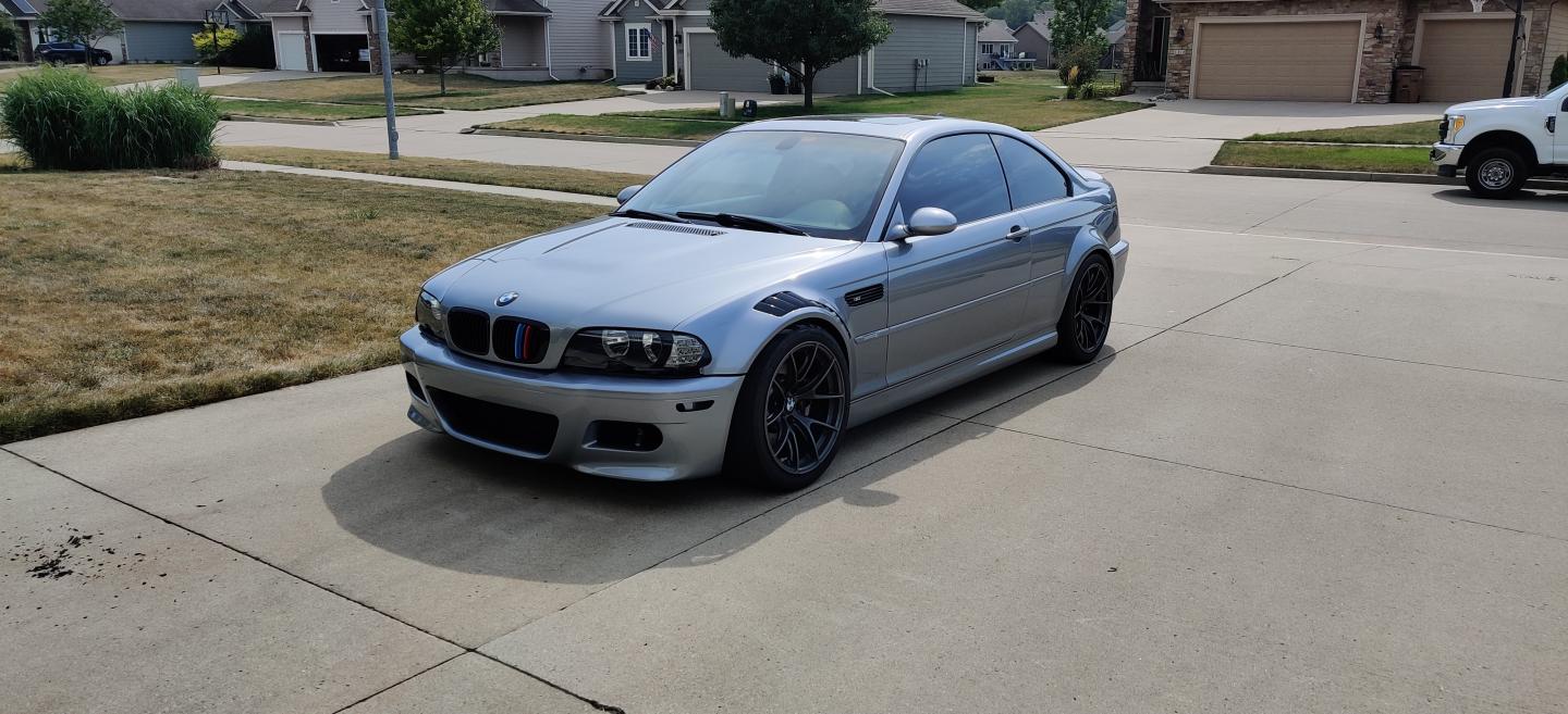

    After ordering the fenders back in January from ECS I finally have them fitted to the car. I would say that quite a few adjustments had to be made to get proper fitment but nothing crazy had to be done. Some of the top holes had to be made larger to get an adequate gap to the hood. Attachment points for the fender grilles had to be trimmed so they would snap in and side marker lights holes had to be enlarged. All in all I'm very happy with how they turned out. They appear aggressive but still fit the style of the car in person I believe. Click image for larger version  Name:	IMG_20220806_162448.jpg Views:	0 Size:	150.8 KB ID:	179714 Click image for larger version  Name:	IMG_20220806_150714.jpg Views:	0 Size:	148.1 KB ID:	179715 Click image for larger version  Name:	IMG_20220807_173504.jpg Views:	0 Size:	86.1 KB ID:	179716 Click image for larger version  Name:	IMG_20220807_173625.jpg Views:	0 Size:	75.7 KB ID:	179717 Click image for larger version  Name:	IMG_20220807_173456.jpg Views:	0 Size:	95.7 KB ID:	179718

        Would you mind sharing your wheel size, tires and alignment specs? These have 15mm extra clearance vs stock correct?
              18 x 10 et25
              Yokohama a052 in 275 I think
              Alignment has changed so I'd hate to quote how much negative camber I have at the moment. I'd guess over 2 degrees.
              Yes they're reportedly 15mm wider than stock. I would agree with that as my bumper was wider than my stock fenders but now is flush on the passenger side and barely in on the driver's side
