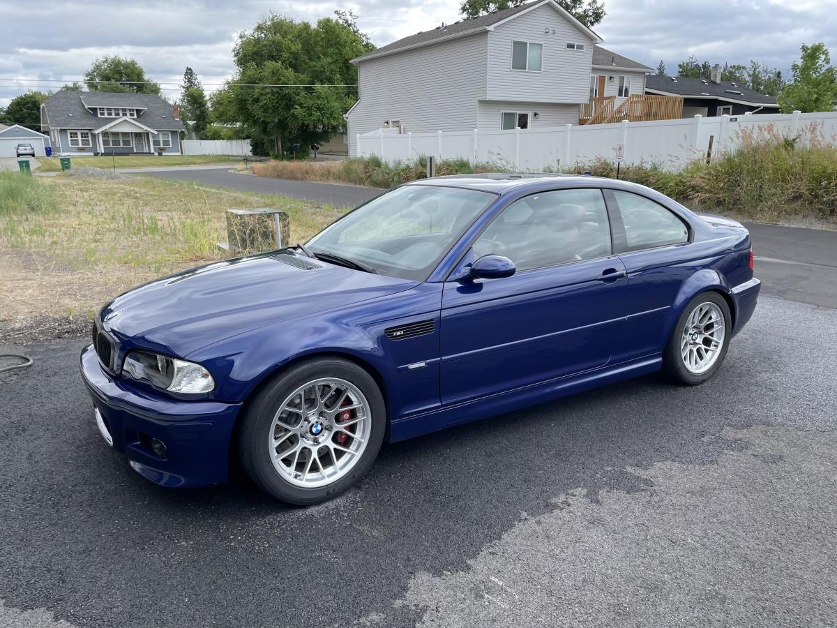

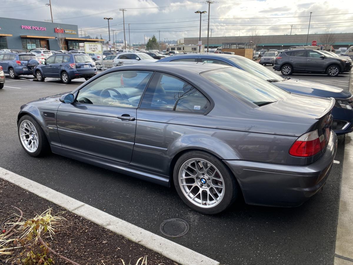

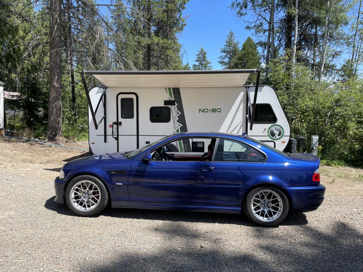

      275/40/17 on the blue m3, 255/40/17 on the grey. The smaller tires are much easier to fit. These are on 17x9.5.
                  Do you know what offsets you're running on the grey car?
                    The wheels are +35, but I need at least 10mm of spacer to clear the 996 brakes, so it’s somewhere between 10 and 15 mm spaced out front and back.
