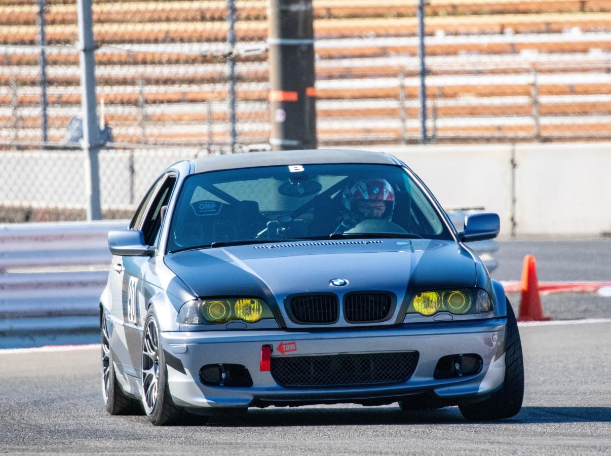

I have a 330Ci with an S54 that is my (almost) dedicated track car (weight: 3293#). I am running Bimmerworld's TA16 wheel (17x9 ET42) with a 255/40R17 tire. A 255 tire is certainly enough for the M3 chassis.Originally posted by S14 View PostIs 255 enough tire for the heavy E46 M3 on track?
