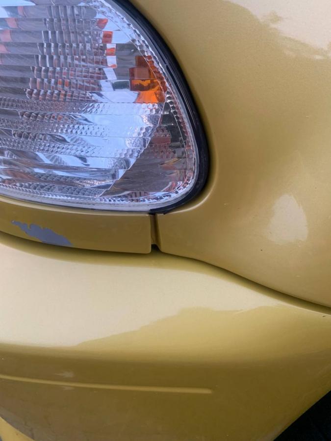

    The paint on both my headlight trim pieces started to come off recently. (poorly prepped before paint, it seems)

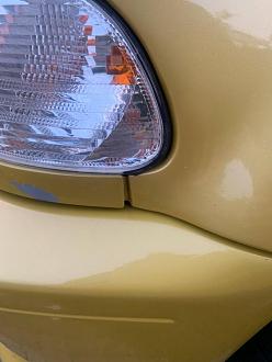

    The issue I've always had with the car is them never sitting flush, see the image below.
    Pushing on it hard doesn't seem to help at all...

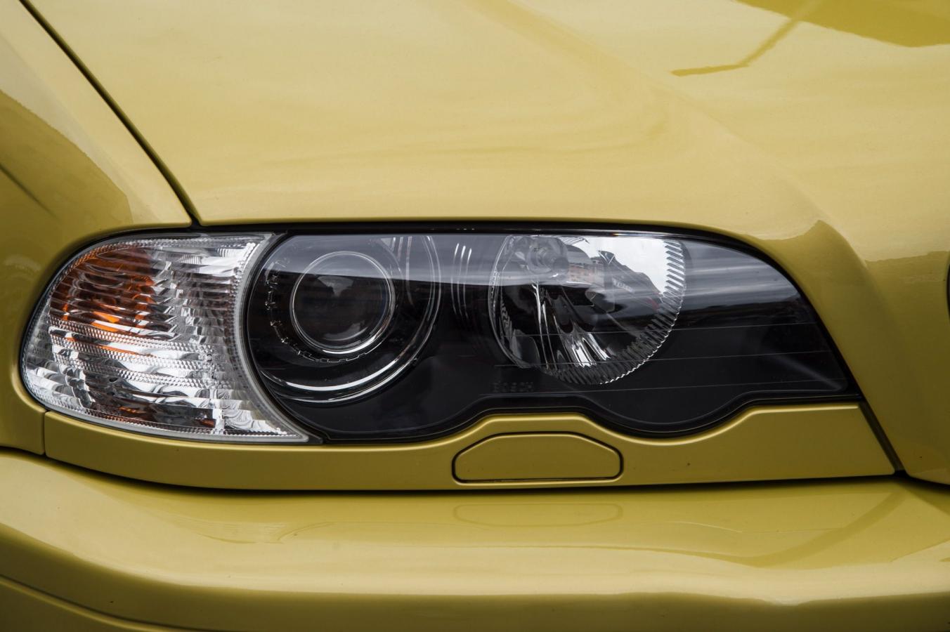

    Image from Google of how it should be:

    So yeah, anyone knows how to get this to sit flush?
    I don't know how you'd get them to be tighter to the fender, but I know that the tab that that they attach to can get bent, so if (once installed) they protrude a little beyond the fender, you can bend that tab inwards a little. Or vice versa.
      Thanks, I have that same situation and I'll be trying this as well
