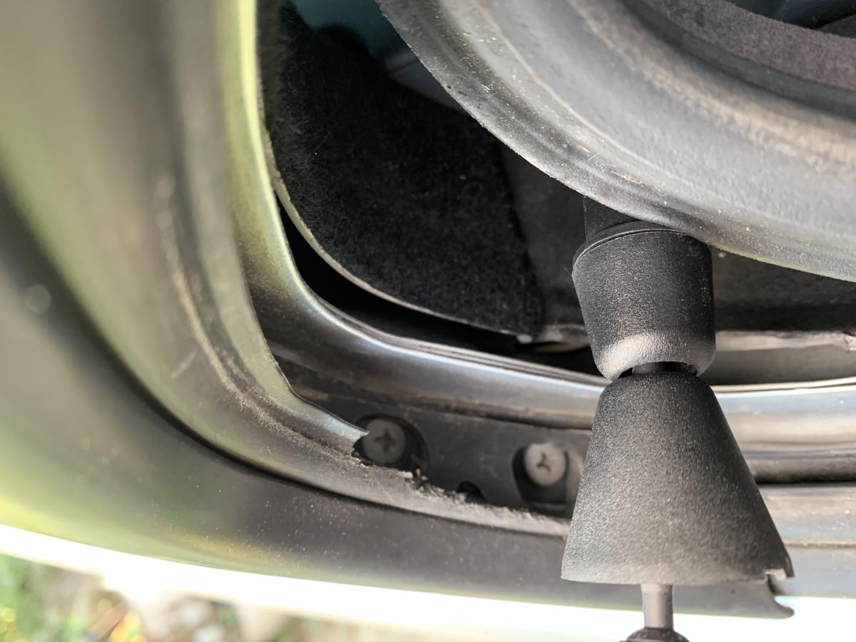

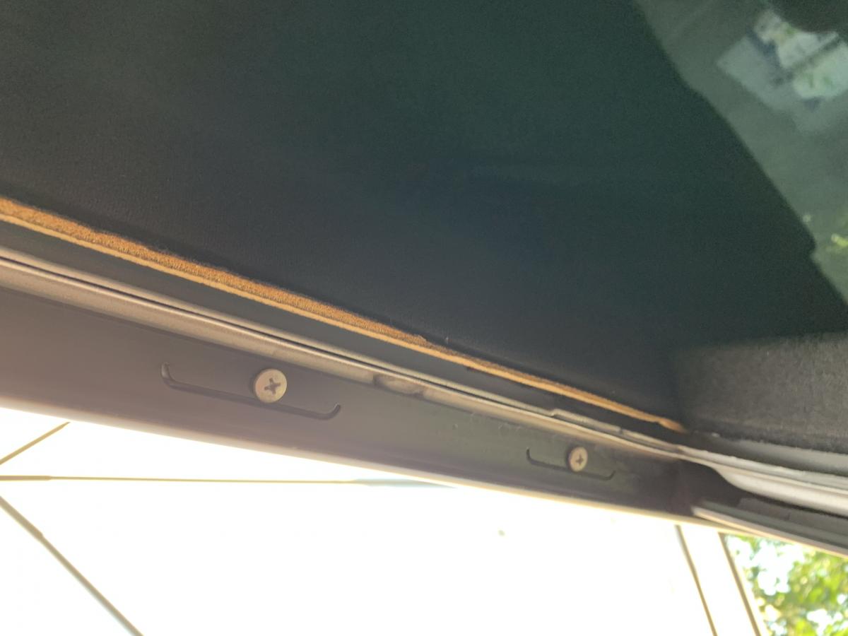

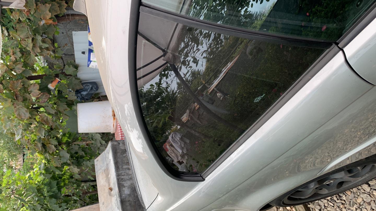

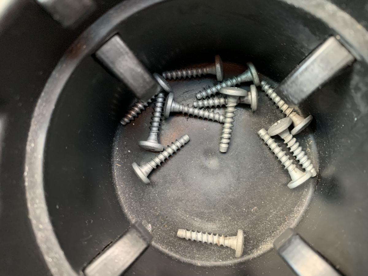

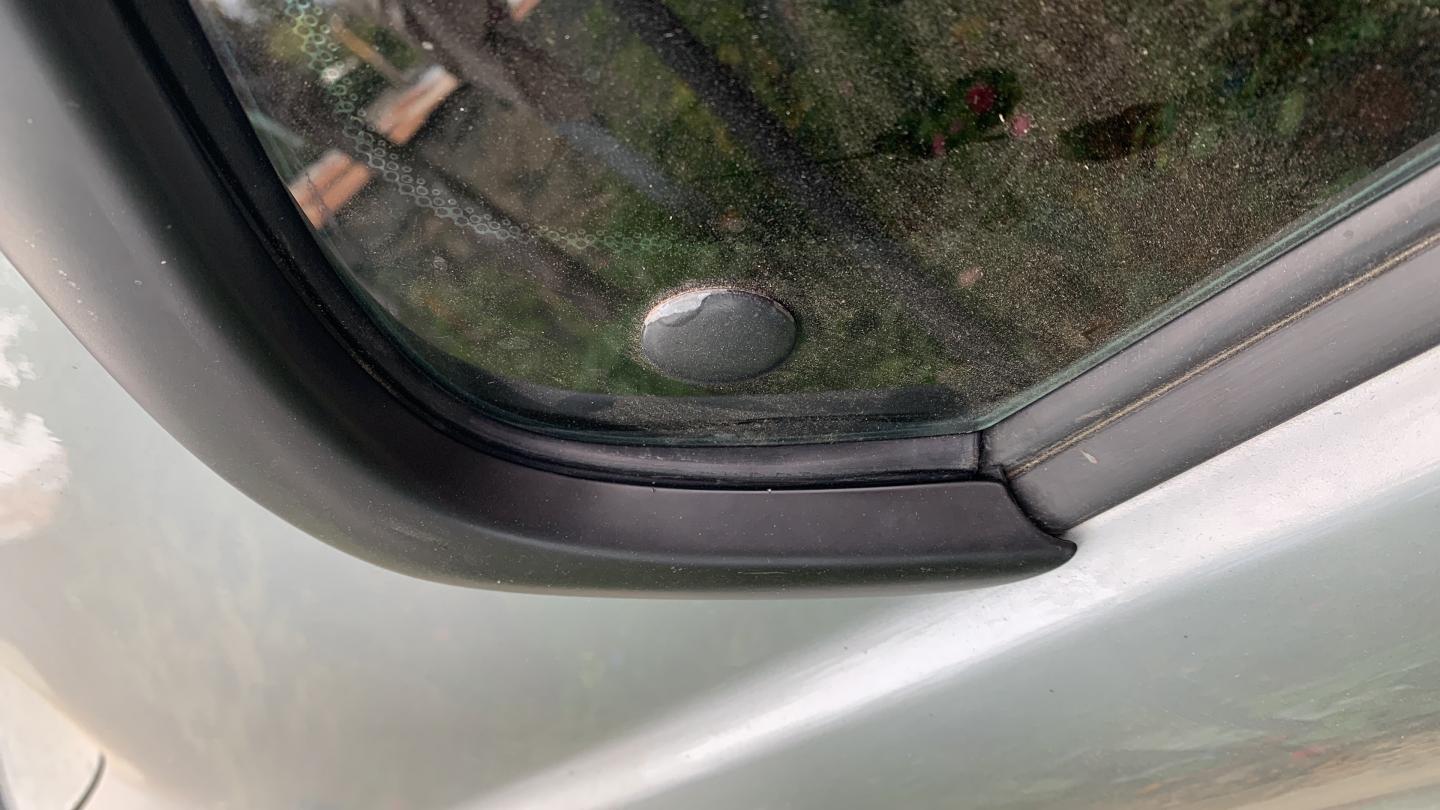

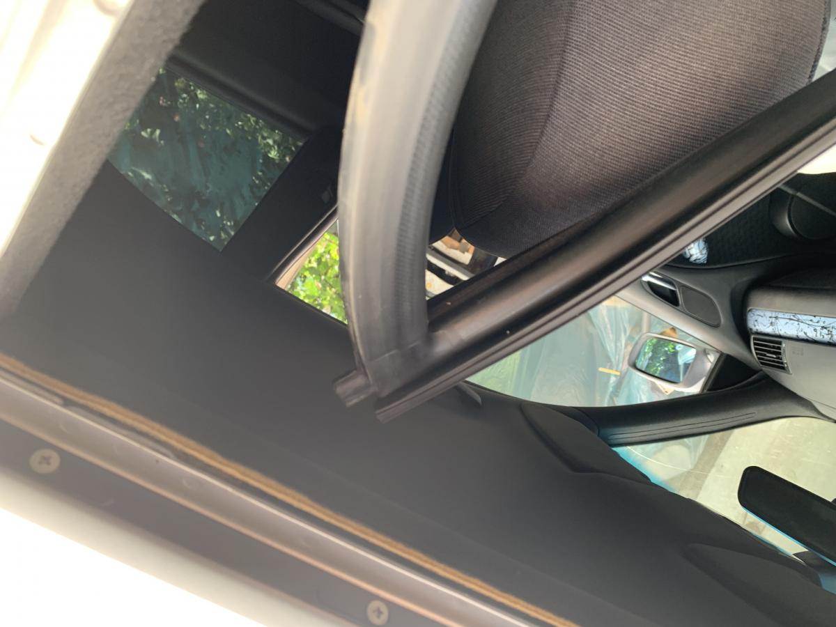

                              So for anyone looking to change them, here are some pics and explanation.
                              There are a total of 16 screws, 4 of them are smaller, 12 are a little bit longer, starting from the back we have the 4 screws, then the rest of them, you must remove the back window gasket from inside(you can work without removing the back windows), and the dooor one aswell, and you will se the screws, unscrew them all and just pull gently the shadowline out, replace the rubber and put it back easy peasy, final result are the last 2 pictures.
                              A while ago i changed the black trim aswell( the long one underneath the small window).
                              Any question you have, feel free to ask and will help ​
