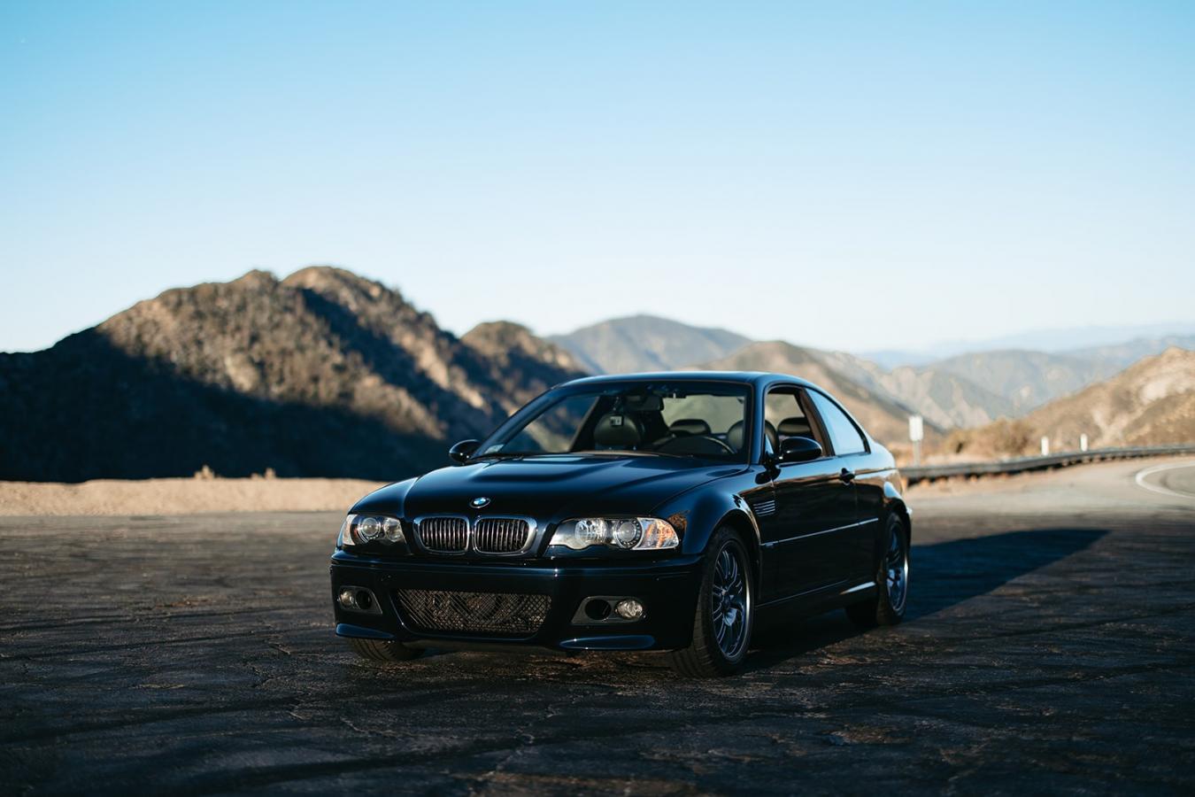

    Pic for click - Click image for larger version
