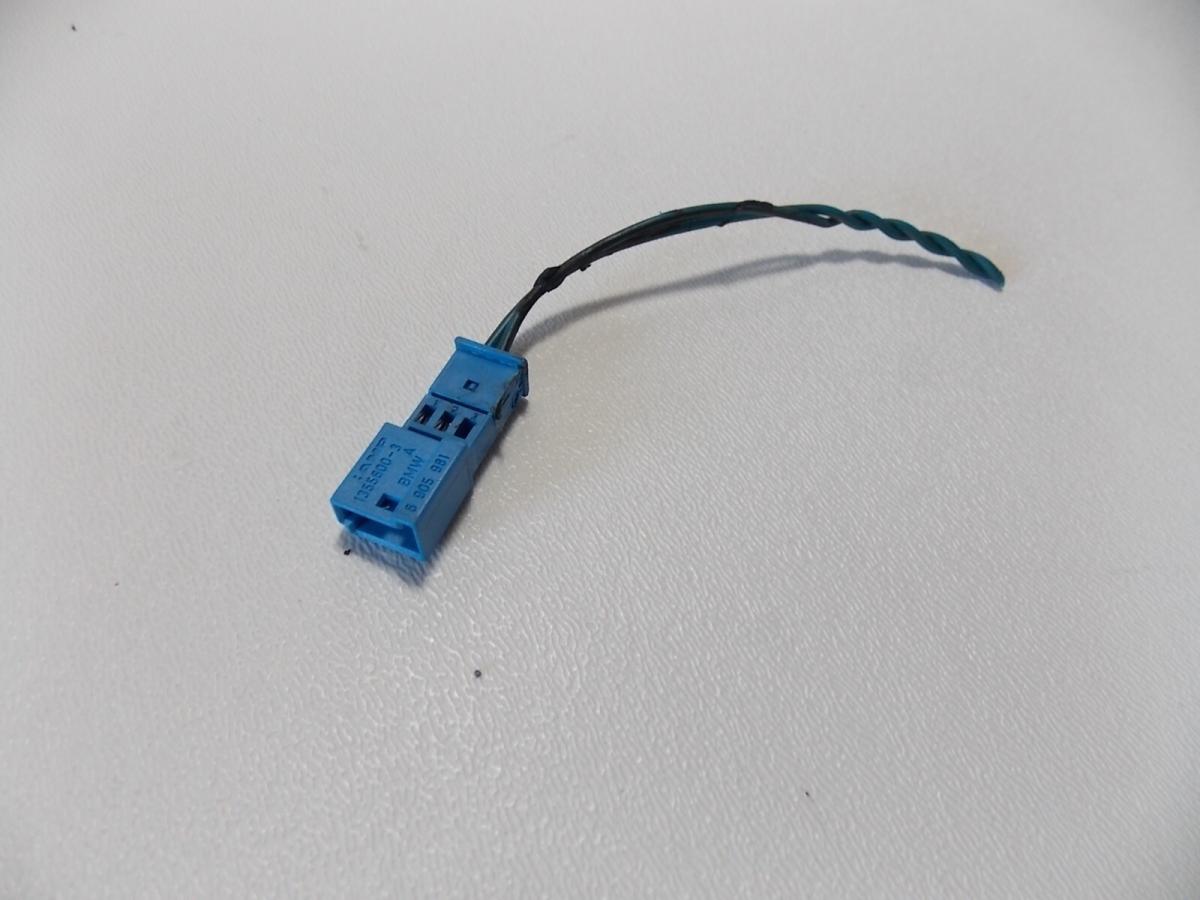

        Any chance someone has their thinned out audio harness lying around? I am looking for the 3 pin connector that connects to the front tweeter:

        Thought I would check here before buying the connector and wires.
