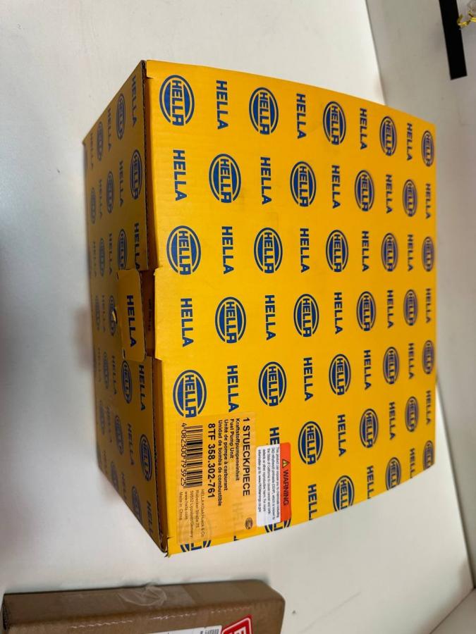

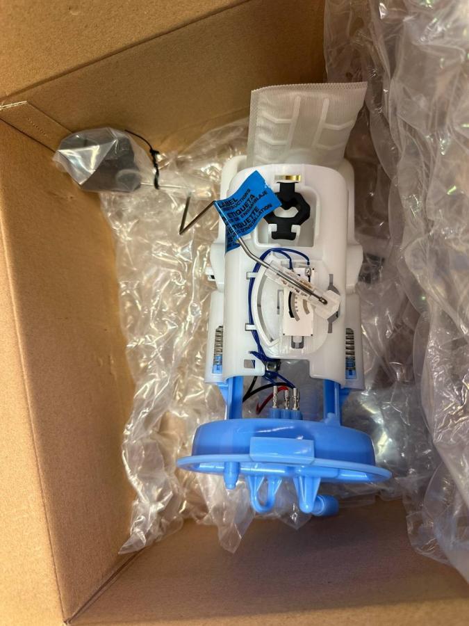

                  Just an update because I hated finding old posts with no resolutions, in my case it has turned out to be the fuel pump. I bought the Hella branded one new for $105.43 and I've never had stronger startups!

                    Thanks for bringing closure to this thread for others who may experience this very same thing.
                      #40
                      Agreed thanks [mention]E46 M3 [/mention], I stumbled upon this thread due to showing the same issue. Will likely be grabbing one of those fuel pumps !
