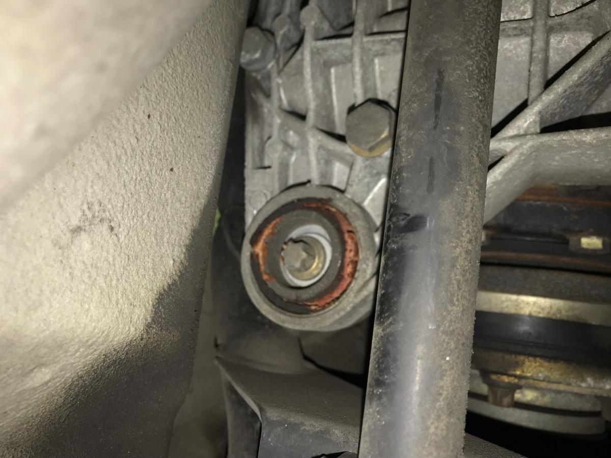

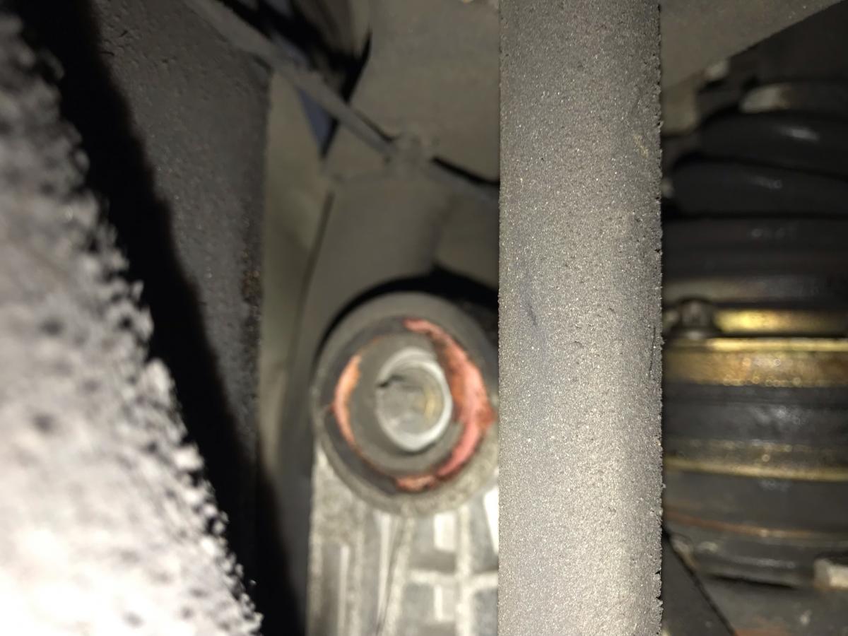

                  Turns out, rear diff bushings are totally shot. At 81.5k, no track time, arguably driving like a grandpa--totally shot. I guess these just rot away....So, off to the shop as I'm not setup to do this at the house--unfortunately.
                    Curious. How did you diagnose?

                        Truthfully, months ago I got under the car to check things out during my oil change. I noticed the rear bushings just "looked" off, but didn't think much of it. Fast forward to yesterday, I took the car to an indy shop I've worked with for years and while on the lift, you can wiggle the diff. I've had this car for 15 years, since 27,000 miles and when driven, it's mostly highway, and never abused. I've got a video, but unable to post it here.

                          Rear diff cover bushings.
