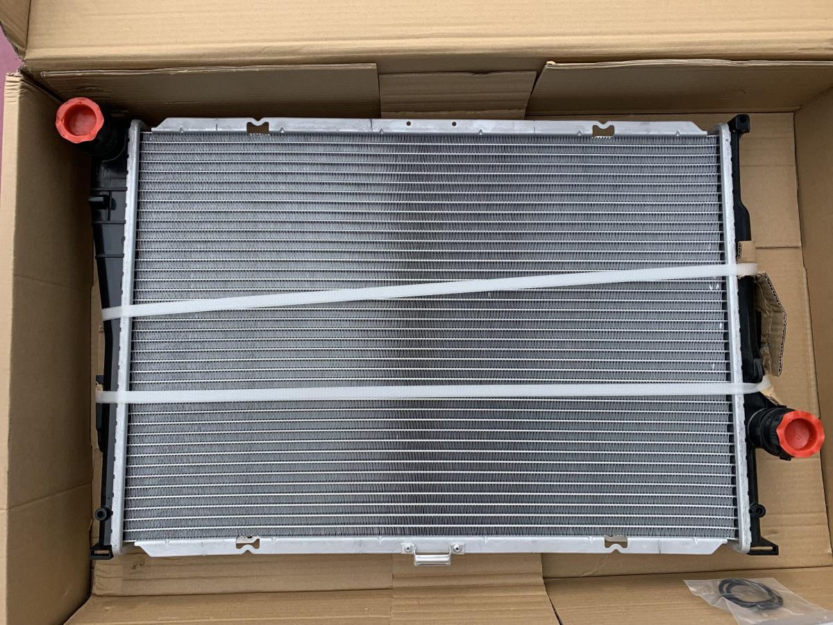

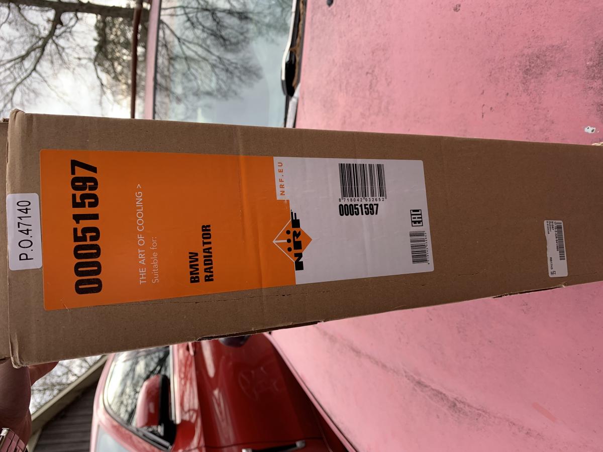

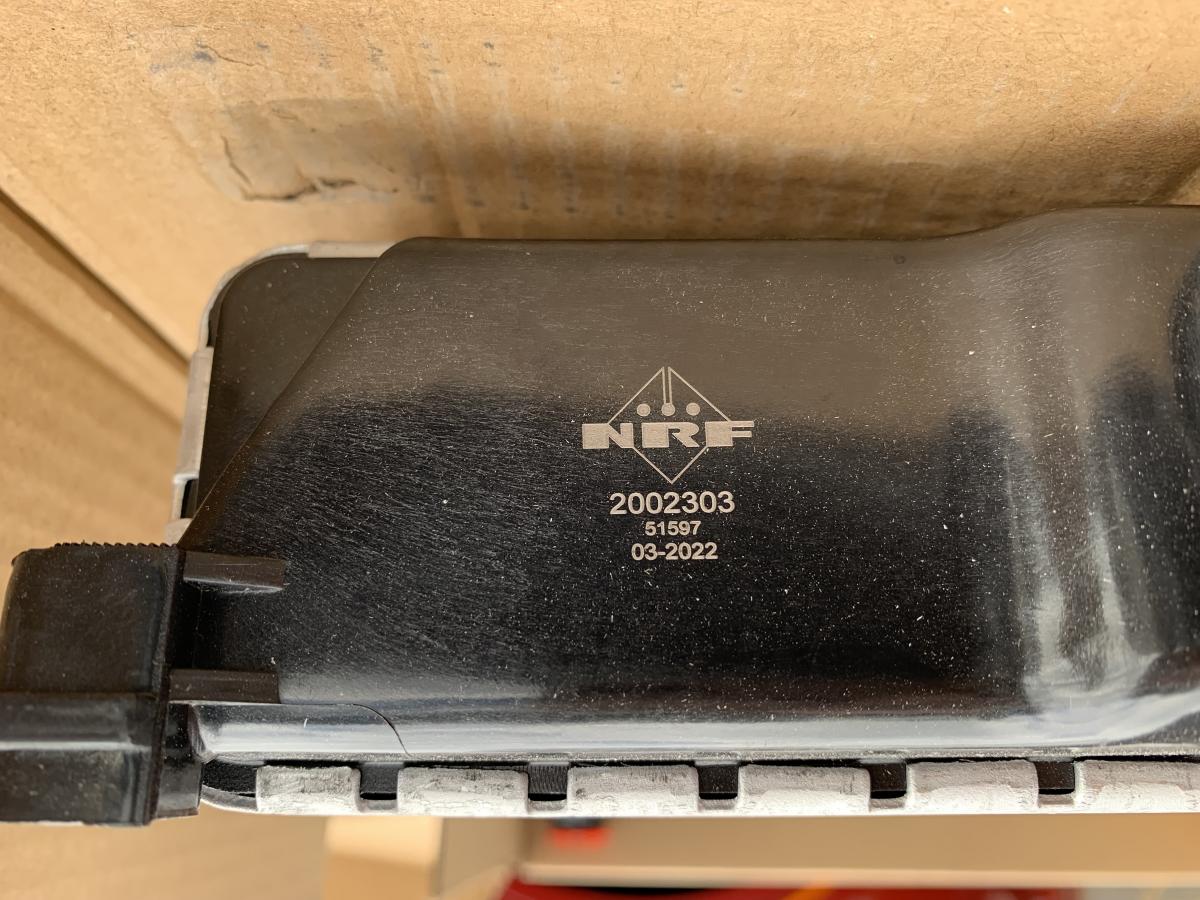

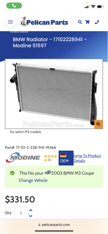

                    Just in case anyone bought one from Pelican, I received mine a couple days ago and it is an "NRF" (Netherlands Radiator Factory) branded radiator. Contacted Pelican and sales rep was insistent that it's the same part despite the very apparent branding discrepancy. "It's the same part number and we've sold a lot and no one has returned it so it's good" was his reasoning. Disappointing service to say the least. It seems the suspicions you guys had about the supplier change was on point.
                    So, anyone have experience with NRF? The end caps are a shinier plastic compared to stock but still feels decently dense and strong.

                    I purchased a Modine from FCP and was sent one of these. After fighting the thing for an hour due to misaligned top mounting screw hole, I measured it next to the genuine piece and turns out it's taller.
                    Did you have any issues with fitment? Not sure where to go from here.
                    also tagging Cronenberged

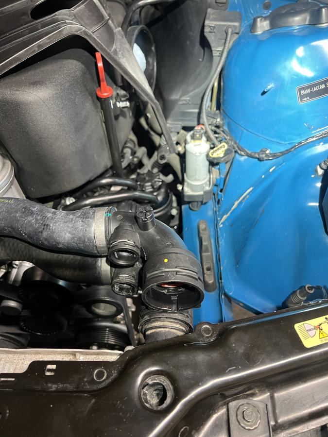

                            correction on the upper rad hose fitment. the radiator isn't the issue. the rein hose is. with the two hoses lined up on the thermostat housing this is how the hose ends up.
                            rein on top
                            genuine on bottom. genuine fits with minimal tension.
                            this still leaves the issue of the upper mounting hole not lining up. this seems to be due to the sliding bracket on the radiator. can't quite pinpoint what's wrong, but something is offf.
