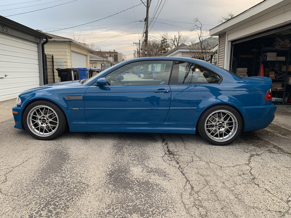

    I got lucky and scored some recession special BBS R-GR's locally here in Chicago. I currently have OE ZCP's installed and am planning on installing my Porsche 996 BBK retrofit soon and understand that I will need spacers to make the BBK work with the ZCP's. The R-GR's I picked up are 18x10 et25 and 18x8.5 et38, do any of you guys happen to know if these require spacers with the BBK?
    Here's a pic of my car with the ZCP's!

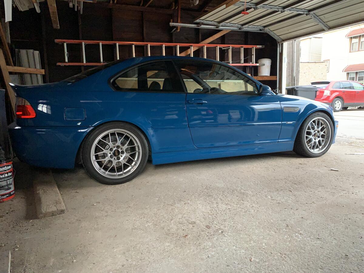

      Just put the RGR's on today. Need to install the BBK and the KW V3's I have sitting around. I should have never sold that Evolve box, or SuperSprint exhaust of mine, ugh. Anyway, anyone local to Chicago want to buy my old ZCP's? Newer MP4S, wheels are slightly curbed due to previous owners inability to park.

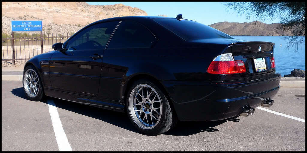

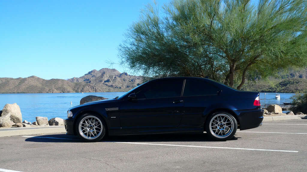

ID:	2648 Sweet wheels, this was my favorite set when I had my E46.
