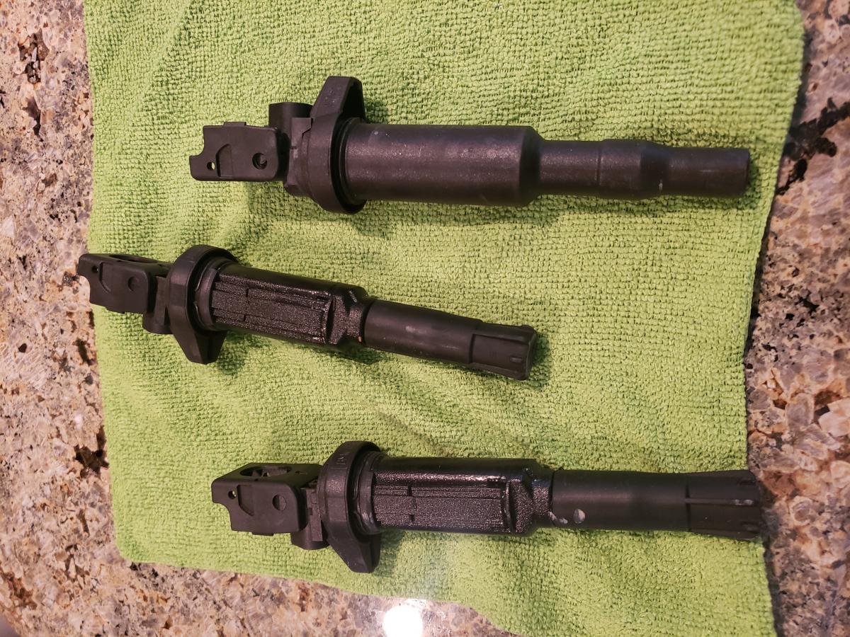

    So I'm just about putting together a replacement engine, to swap into my M this weekend. the replacement motor has BMW 6 coil packs. My motor has a mismatch of other BMW coils, Bosch, and Eldor.
    Took a pic (attach)... which coils should I go with? This is what I have on hand between the motors.

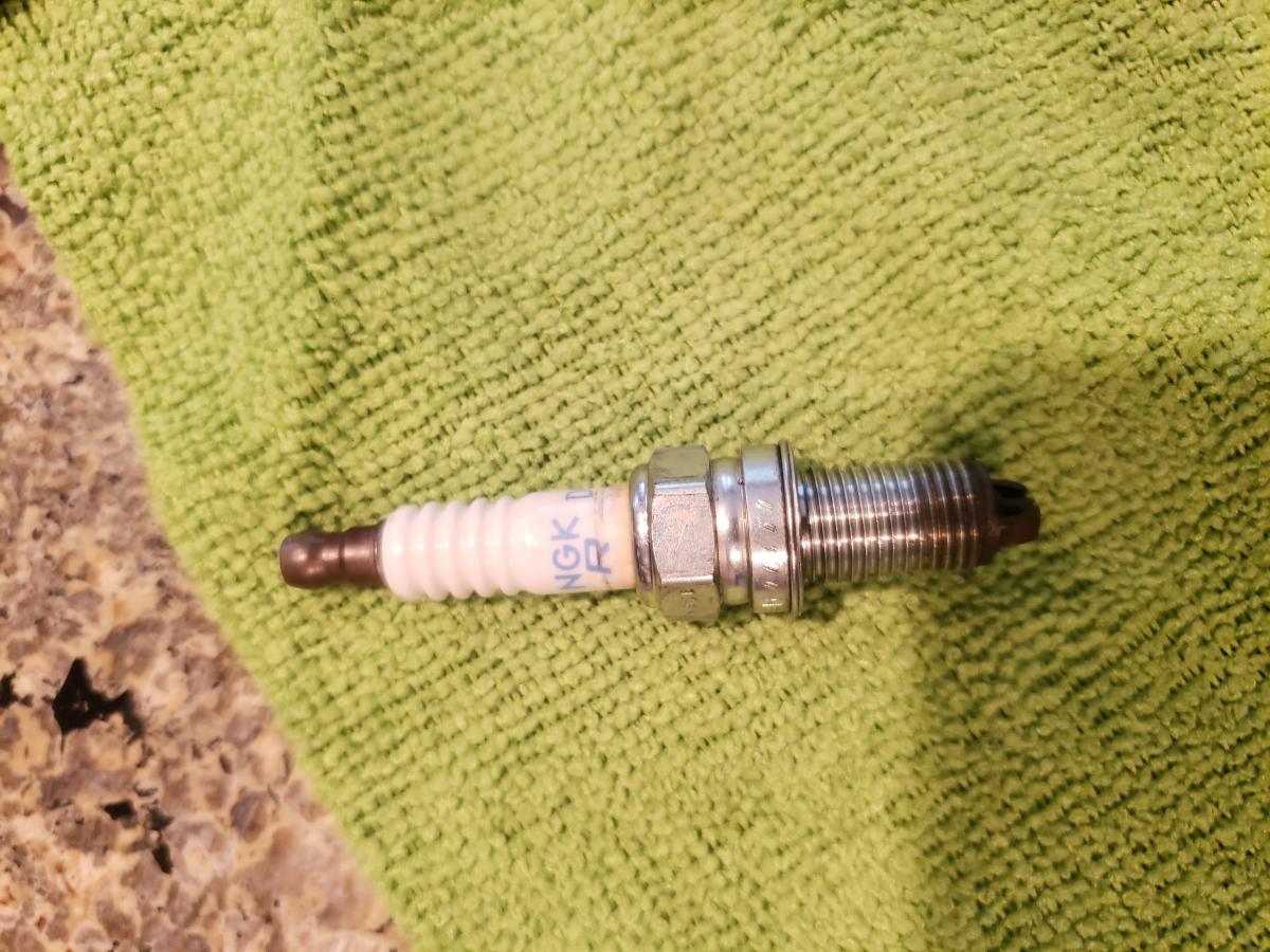

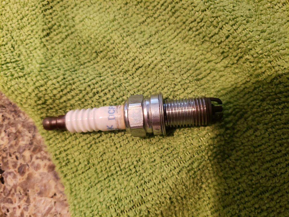

    S54 engine-- NGK spark plugs for the S54 should be 2 prong not 3 prong (edited)
      These are the ones I have... are these not the best ones?
        those are 2 prong and look proper (OEM).

                I believe 2 part numbers are both correct from BOSCH for your coils. The one you mentioned x4470 and 0221504464. I wonder what the difference is between the two part numbers are.
                  In your picture, the two coils at the bottom are the older style that originally came with the engine, so most likely have higher miles than the rest. The top one is the updated Bosch coil and work great in my experience. Eldor became the OEM supplier after Bosch and now BMW uses Delphi coils. It might be best to go with the 6 matching Bosch coils and keep the Eldor (and the other coils) as a backup. They should all have a date stamp, so you could also choose the coils that are the newest.
