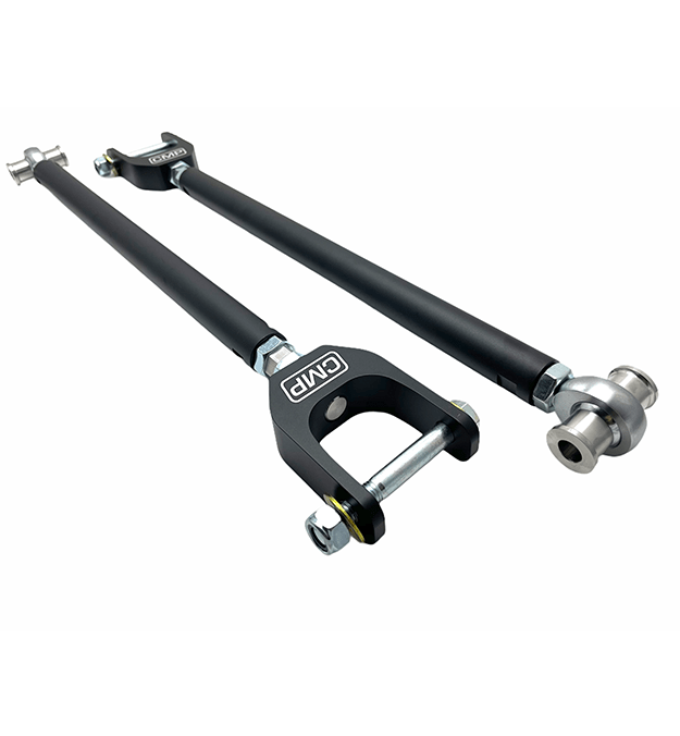

      I'm personally a big supporter of bearing mounted lower camber arms. Why do you feel rubber is best?
      From my perspective, they don't increase harshness as cornering forces build slowly as the car rolls, springs/bar load up etc. The lower arm also experiences about double the force (in the opposite direction) of an upper arm in double arm setup so in terms of geometry consistency removing rubber in the lower is far more effective.
      There's also reduced suspension binding as the bearing's don't add torsional force when hinging.
      If you don't mind me plugging my own Tones, I've pasted a link. They're aluminium construction with camber adjustment made with a stainless steel jack screw at the wheel end which makes life easy.
      Fits: All E36 & E46 Non-M, E36 & E46 M3 (excluding E36 hatch). Benefits:- Increases rear camber adjustment (Suspension Tune-ability)- Adjustments made at the wheel end of the arm (practicality)- Provides consistent camber geometry (stability)- Free pivoting spherical bearing (no suspension binding)Note: A beari

            The CSL "camber arm" comes with a bearing.
            This for me was enough justification to disregard any rubber options. I went with the ones from CMP as linked above.
                  Sadly the genuine CSL rear arms went NLA a long time ago.
                  I have used the TMS rear camber arms for about 8 years. They are actually the race kit as apposed to the street version.
                    I went from stock to the BW monoball bearing rear camber arms last year and didn’t notice any NVH increase. Also running Ohlins R&T.
