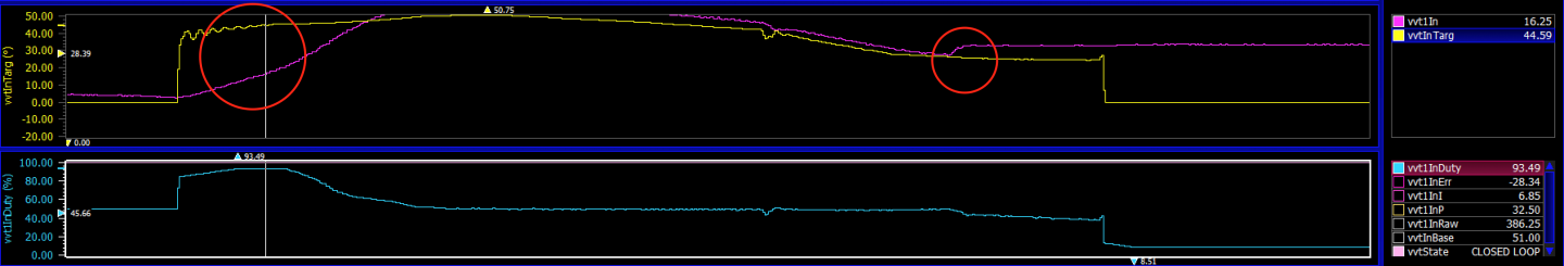

    I am having an issue with the intake cam sticking intermittently. It will lazily move to its target position, then not return until seconds after. The picture below is 2000rpm-5500rpm log, yellow is the target, purple is the actual position, and blue is the duty. It increases duty to try to get it to move, which it does slowly. Then it increases more towards the end for no apparent reason, then does not return to the target after. The solenoid, vanos seals, and diaphragm springs are all new. The exhaust cam is also working fine.

                            Curious why is there ringing in the yellow trace? That’s the ECU target cam position? Would think that trace would be clean.
                              Without a clear time base then it's hard to say it responded fast or slow. What is the delta time during the purple line ramping up?
