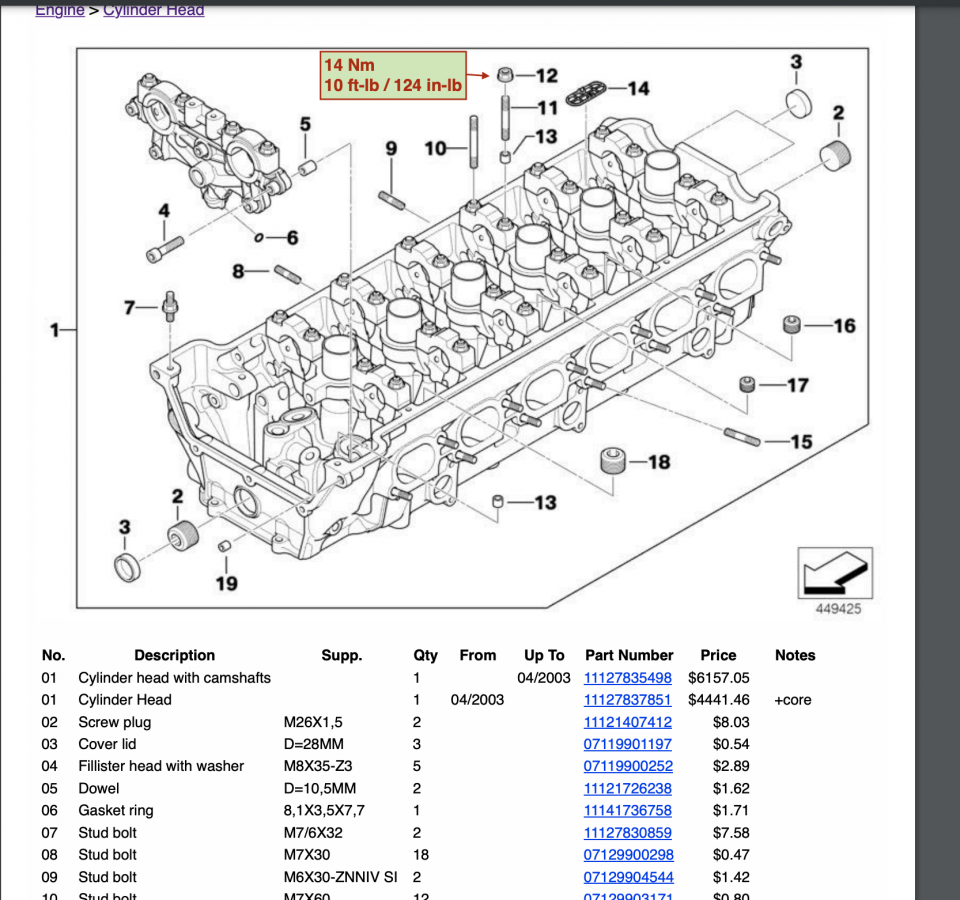

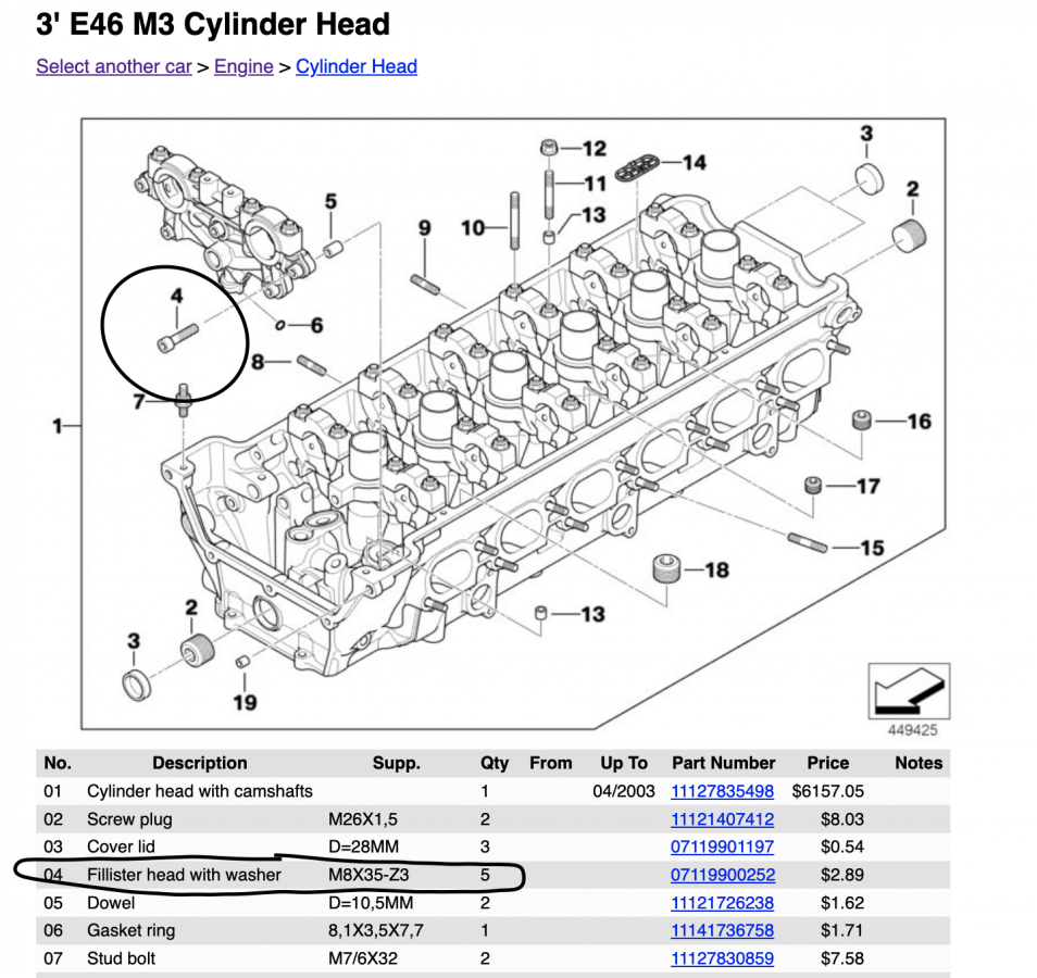

Hi all!
These are M8 bolts with a spring washer. There are 5 of them. I could not find the torque spec in the TIS. Looking up online tells me M8 should fall between 28-32NM. This seems terrifying-high as they thread into aluminum. The spring washer tells me they need less than that...
Does anyone know?
Image is attached for reference. many thanks!
