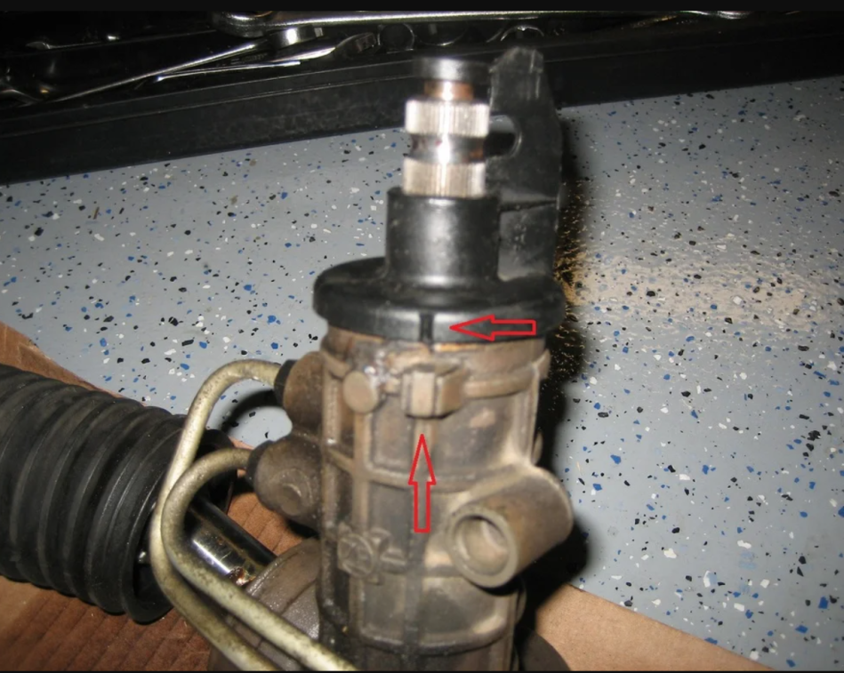

                I need to make sure I am doing this correctly, if you could help with one question.
                I have the steering centered with INPA and locked.
                Removed the old rack and ready to install the new LUCAS Black edition rack (LINK)
                Rack is centered with 75mm on both sides.
                Now the question is I need to install the plastic alignment on the spline. Will one or two tooth make a huge deal? I will align it center of the tab on the new rack (pic from other forum member).
                  It will make the steering wheel off center. Not a huge deal but hugely obnoxious to me.
                  If it's off you can of course re-do it. Just more work, and kind of a pain, since you won't know for sure until you drive it.
                    It's slightly noticeable if you're off by a tooth or two, but only at the extremes. If you're off, you'd reset with INPA anyways.
                    If you want to get the cap aligned and centered properly, you'd need to follow these steps (source: I've rebuilt 100+ racks now and have centered each cap):
                    1. Turn the pinion rod clockwise to have the tooth side of the rod go into the steering housing completely. You know you'd done this correctly when you feel a slight “click” and it stops.
                    2. Take the cap and align the single tooth on the cap to the REAR circle on the pinion tube on the rack, not the front. (The front is the side with the tag facing you, the rear is the side with the rack lock)
                    3. With the cap pressed onto the pinion rod, turn the pinion rod and the align the single tooth on the cap to the FRONT marking on the pinion tube.
                    You'll center the rack every time using this method.
