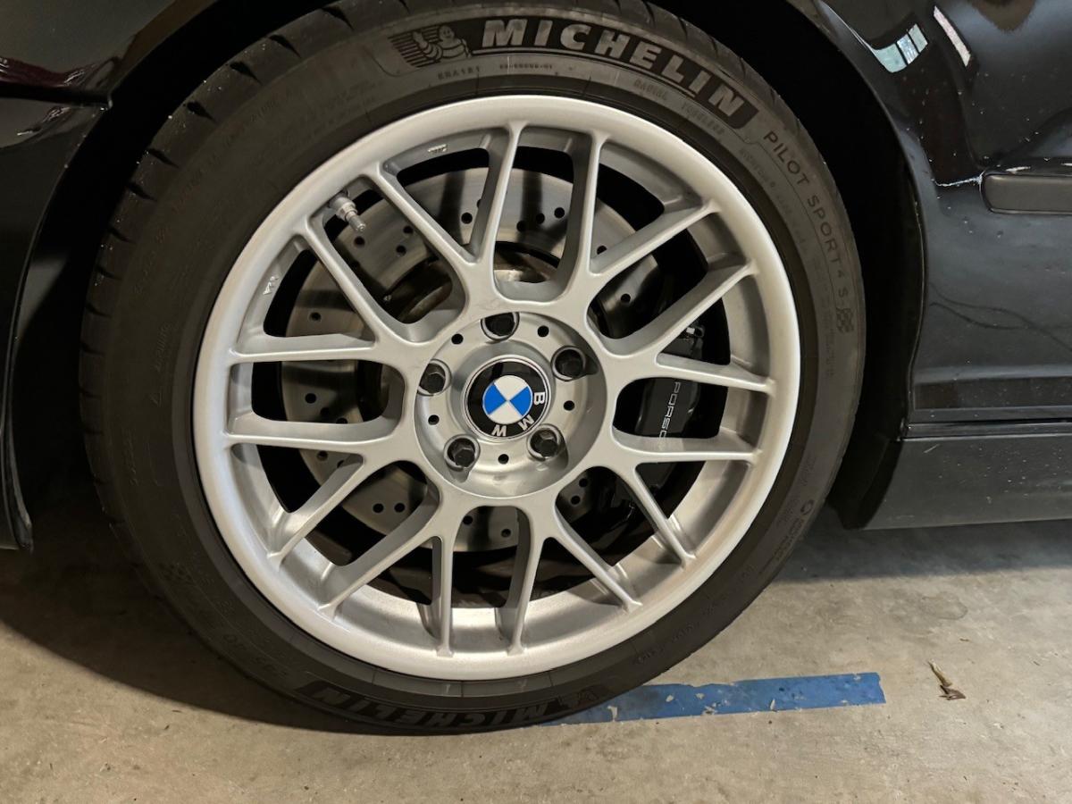

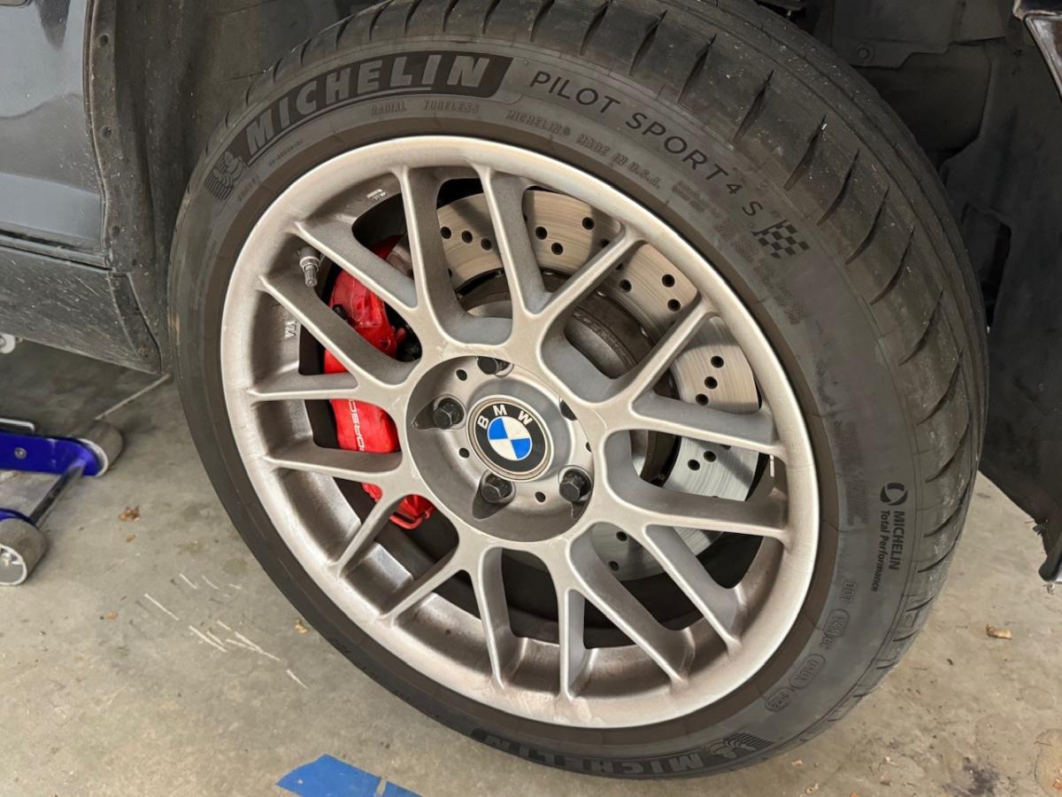

                      I run 9” ARC-8s with et46 (et52+6mm spacers) and 996 calipers, so it can be done! Just have to be real creative.
                        I don't see how that's possbile - the 996 big reds are huge! Maybe the different spoke profile or did you scallop them out further? Or mill down excessive alloy material on the calipers' outside :P

                          Here ya go! Just under 3mm clearance, no machining (other than the standard machining to fit) required. These are 17” diameter too, even tighter
