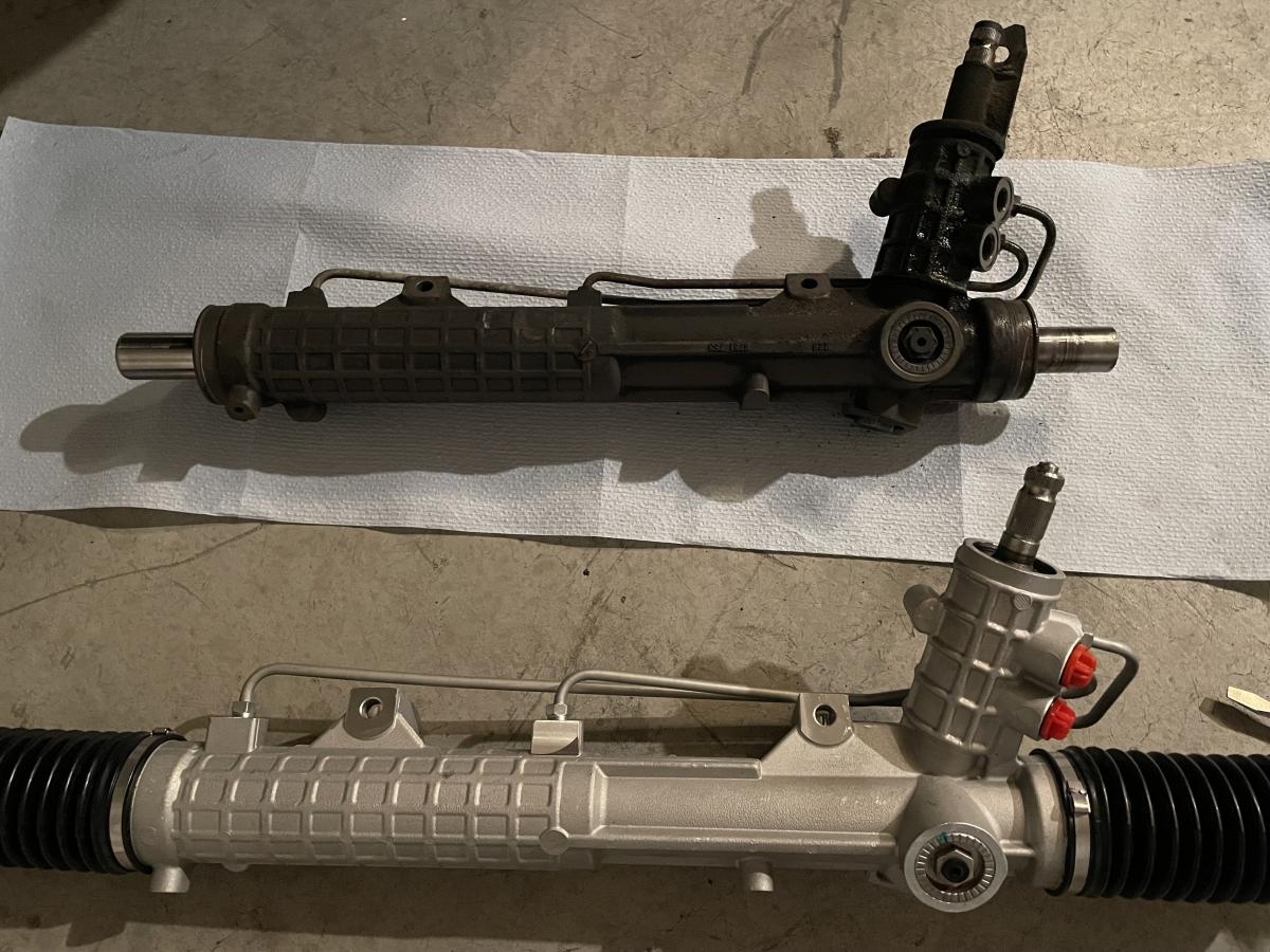

              I got my rack this weekend and started installing it. The rack seems to be a high quality item, the exterior housing is almost a 1:1 replica of the OE design. Fitment is perfect and all clearances are same as the OE item
              the only negative I have with it is the pinion dust cap, which is a very flimsy item, but the vendor I got it from was very nice and sent me an OE hard plastic one for a factory like setup.

                    You can see the OE rack and the BT rack together, on the outside they look very similar, the casting quality is rather good with some areas showing more rugged surfaces.

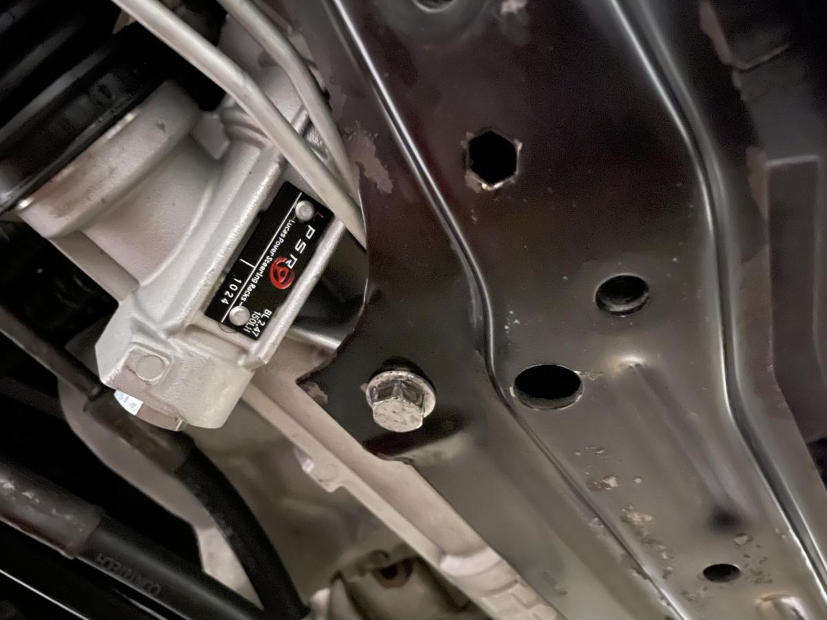

                    Click image for larger version  Name:	IMG_3106.jpg Views:	0 Size:	167.8 KB ID:	353496
                    this is when I installed it before I had to take it off.

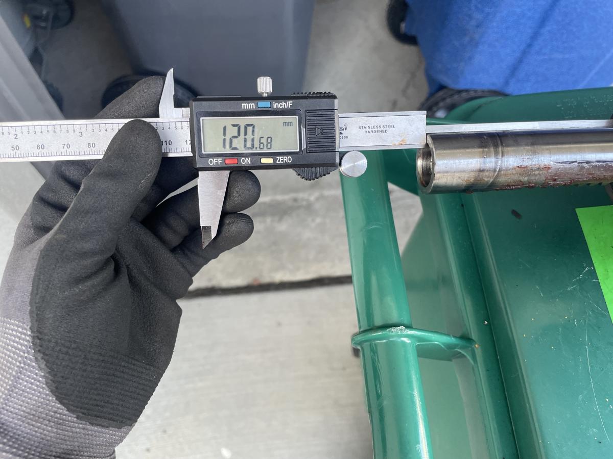

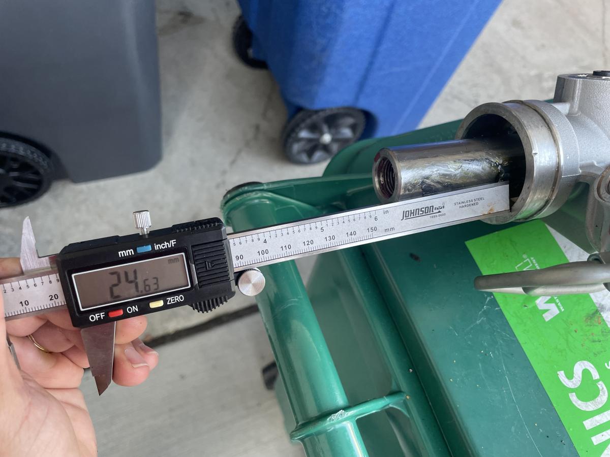

                      I measured the distance from the outer most edge of the rack housing to the inner face at which the inner tie rod bottoms out, the black tag measures 24mm and the OE rack 19. Is tough to say the exact measurements as is impossible to line up the caliper perfectly every time, so let’s say is 5-6mm more on the BT, which means the limiters on the Z4M rack are between 5 to 6mm
                      i suppose the BT rack is the same as any other E46 as the Z4M’s 2.8 turns lock to lock must come from these built in limiters.
                      the rack displacement per turn is 50mm, the value below is 70 and change when centered. So, the Z4M rack itself is not faster than the CSL

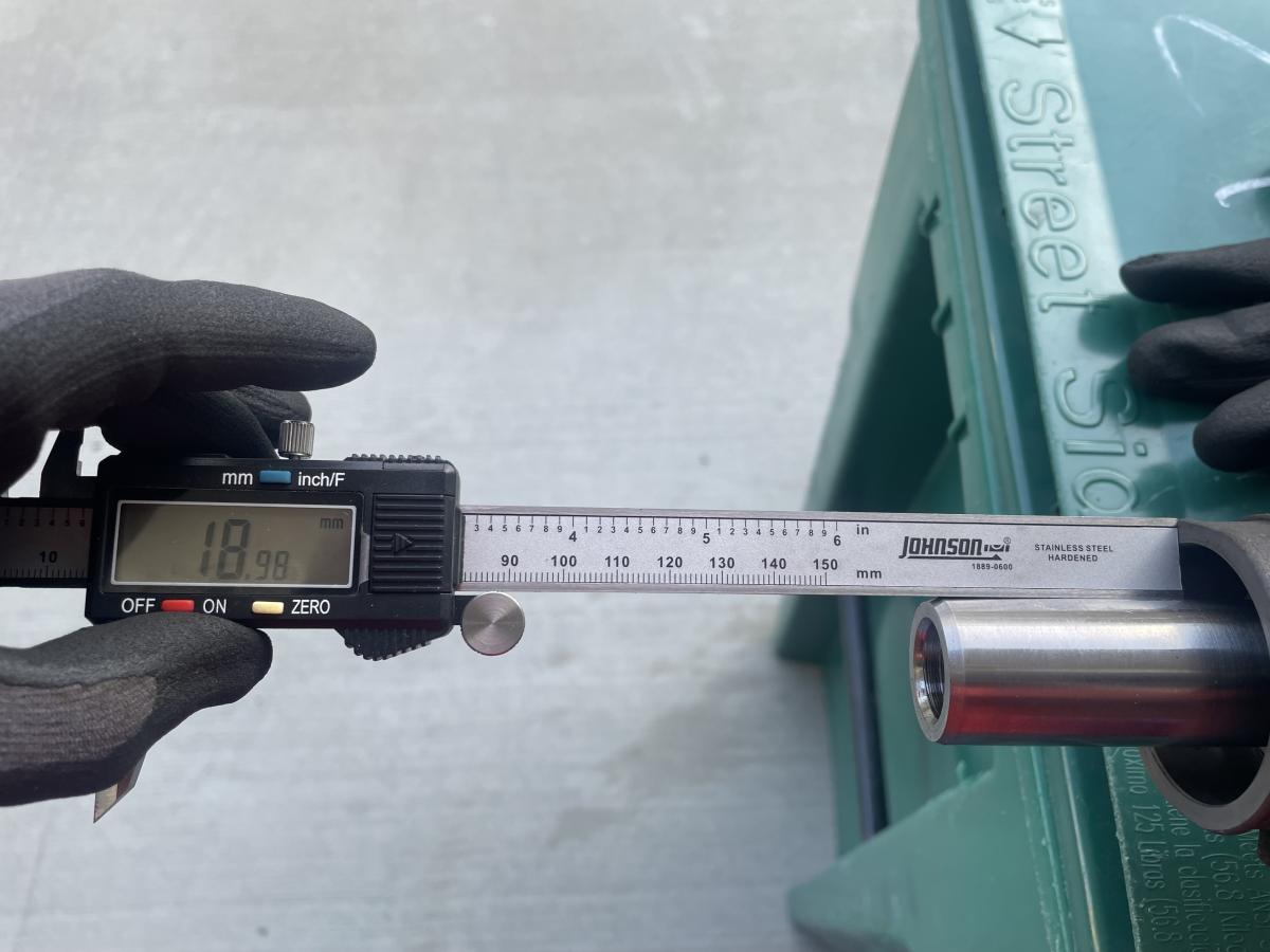

                      Click image for larger version  Name:	IMG_3138.jpg Views:	0 Size:	112.2 KB ID:	353542
                      The below image shows the depth to the surface that stops the inner tie rod
                      Click image for larger version  Name:	IMG_3140.jpg Views:	0 Size:	106.0 KB ID:	353543
                      The same measurement on the Z4M rack is 19mm
