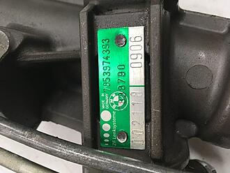

    Click image for larger version  Name:	E9B66C8D-74B4-4BDA-8AB4-CCE2225FB183.jpeg Views:	0 Size:	88.2 KB ID:	61994
    Measurements on a Z4MC green tag rack.
    Rack Rate = 50 mm/turn
    Turns Lock to Lock = 2.8
    Total Rack Travel = 140 mm
    Linear
    Also, the pinion shaft is taller than the gold tag E46 rack. Approximately 70 mm. The gold tag rack is 40 mm.
    I also noted that the rack has built in limiters, so while the rack shaft length is the same (575 mm) the Z4MC has 10 mm less travel. Which also makes the lock to lock look better than it is.
    Click image for larger version  Name:	04D07CA9-8756-41C5-ADB4-102624AB3673.jpeg Views:	0 Size:	62.7 KB ID:	61995
    Turns Lock to Lock = 3.0
    Total Rack Travel = 150 mm
    Linear
    Steering knuckle on Z4MC:
    Tie Rod Distance from Steering Axis = 130 mm

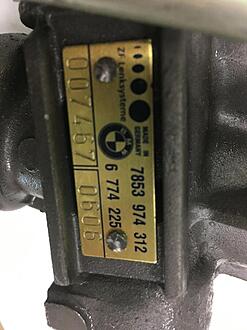

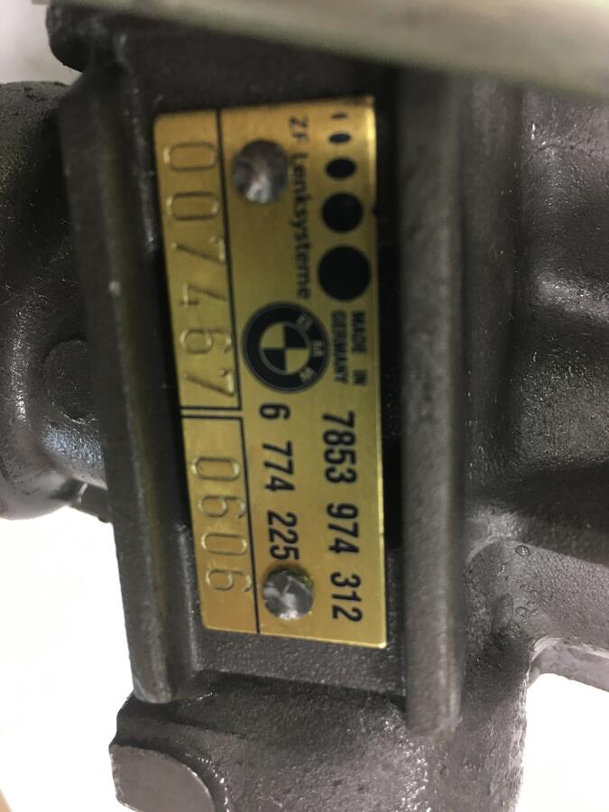

          I'm considering to buy a yellow tag rack from rackdoctor. As far as I can see, the inner rods are included in the price and the outer rods could be additionally purchased. Is there any difference between the inner/outer rods of the ZHP and the M3 ones?
          Jet Black E46 M3
          ex - Broom Yellow Fiat Coupe 400++ hp 1.8 -> 2.0 16VT 👿
          R.I.P. Speed Red Fiat Coupe 2.0 16VT 👻
            #35
            Yes there is a difference can’t use Zhp putter tie rods on M3 only the inner are the same.
              #36
              Thanks a lot. So I'll purchase just the rack with the inner rods included and I'll buy the outer ones separately. I also know that there is a difference but when I've contacted the rackdoctor and ask them if they can sell the rack with outer rods for m3, they answered that the outer rods are interchangeable among the e46 platform. Thanks for the confirmation.

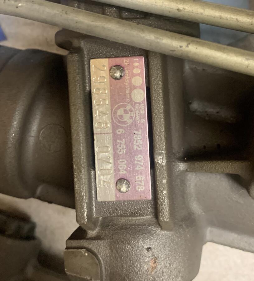

                It turns out that there is alternative to ZHP Yellow tag rack, The 7852 974 678 Purple Tag has the same exact spec as ZHP 712 Yellow tag, check out comparison video between the two.
                Purple Tag
                ​​​​​​Rack Rate = 50 mm/turn
                Linear
                  #38

                      The ZF .678 "purple tag" was also installed on the 325/330s. It's not "exactly the same specs" of .712 "yellow tag". True it does though have same ratio (as other 325/330s). But does not have the same valving/boost feel, just like Terra stated.
                      Since '01 the non-M E46s been getting this 13.7:1 ratio standard.

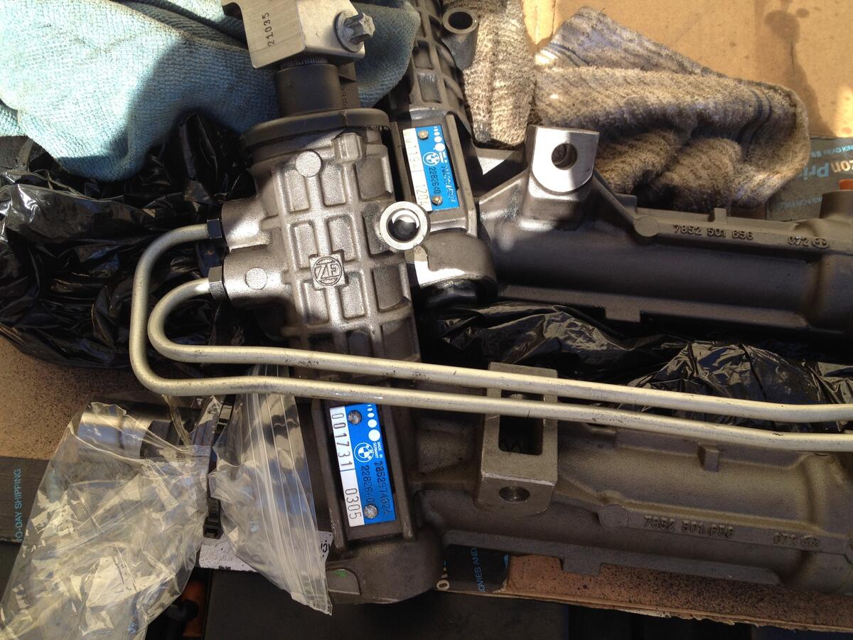

                        I was lucky to be a limited few who had two out of car in my possession back in 2013. Here are the numbers. It'll be a ZF and top row numbers end in .924 and bottom row ends in .640
                        Naturally if some how the internals have been swapped that another story. But doubt anyone would mess with the valving. You can measure and confirm the travel if needed.
                        ZCP rack

                            All 330s from April 2001 onward and all 325s from September 2001 onward had the 13.7:1 ratio, no exceptions
                            330s from 04/2001 to 09/2001 got the purple tag rack.
                            330s from 09/2001 onward got the yellow tag rack
                            325s from 09/2001 onward for the purple tag rack
                            This is for LHD markets. In RHD markets there was only a purple tag and 325/330s got the same rack. The tag being purple doesn’t necessarily mean it’s valved comparably to the purple LHD rack, but that would be my assumption since both purple tags came to be around the same time and the LHD-only yellow tag came later.
