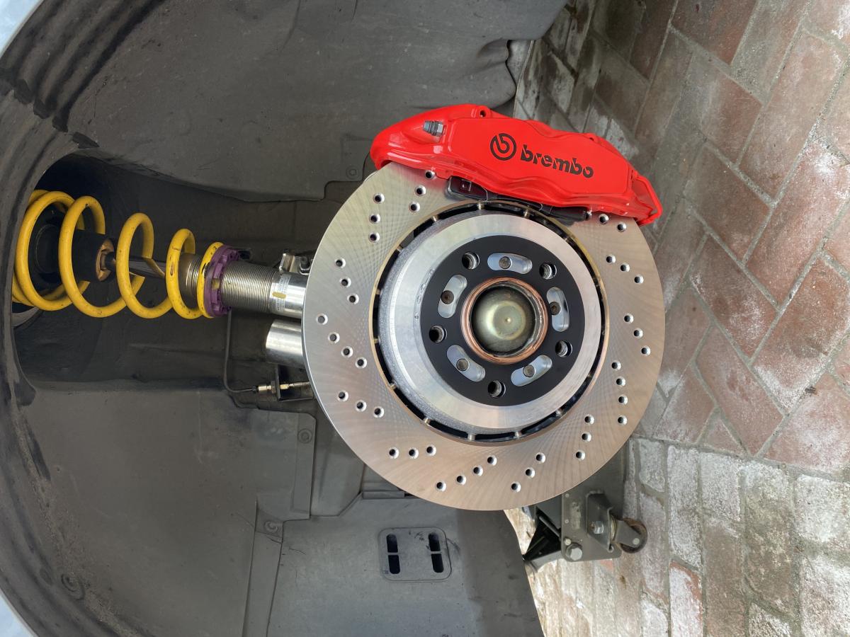

              I have OE CSL fronts (8.5J) with buildjournal's Brembo 4 pot calipers and I have clearance using 10mm spacers

                8.5j
                  Err, yes 8.5J
                    What CSL/ZCP rotor are you using with your 6 piston BBK caliper? On my kit, im using the E90x (360x30mm) which I believe has a thicker hat size than the E46 (345x28mm). I think im running the H&R 20mm Bolt-On Wheel Spacers on the front to clear my style 67 and 163. Im also lowered on KW3 with Turner motorsports fully adjustable camber hats.
