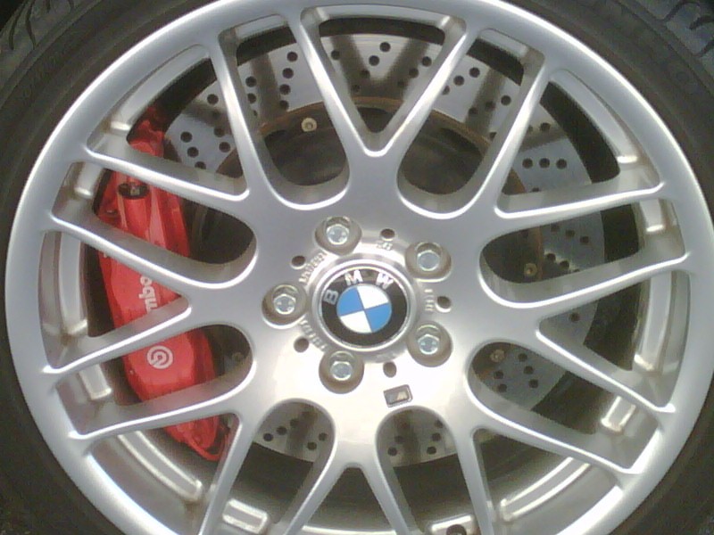

                    That's correct, I believe I had to go with 18mm spacers in the fronts to clear my Brembo 4 pots with ZCP wheels. And it barely clears it.

                      Thanks for your input and the picture. Calipers look amazing behind the wheels 😍

                        My pleasure. Fronts are 19x8, the true CSL fronts I believe are 8.5. I'm actually due for replacing rotors and pads. I wanted to try and go with Stoptech rotors for the fronts to try and save some money, but being I have the 380mm kit in the front I'm hearing the hats will not line up properly and have to stay strictly with Brembo rings. 😵

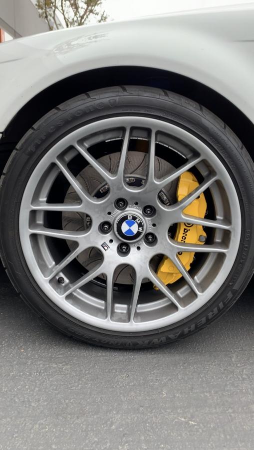

                          Quick update for this thread. I installed a 15MM spacer in the front and had ample clearance. According to the MM measure stick used to measure brake pad wear, I had 16mm of clearance. I could have run a 3MM spacer and been fine. I swapped out the 15MM with a 5MM spacer as they are readily available and I didn’t want to cut it too close. Overall the clearance is great. Thank you all for your input.
                          This applies only for OEM CSL wheels running a 6 piston kit in the front. The 6 piston calipers are thinner than 4 piston calipers so you likely need a larger spacer if you’re doing the 996 retrofit (12-15Mm per tbonem3)

                            Am I crazy or are there heaps of wheel weights on your wheels lol

                              I was going to say the same thing.
