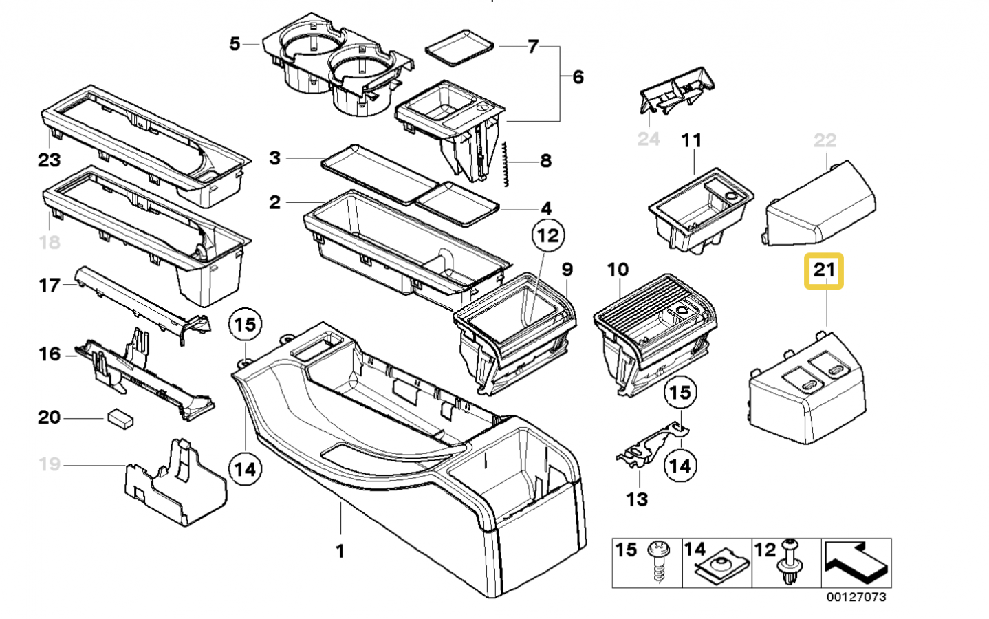

    The armrest delete center console trim comes with a template intended to cut the back of it, but the original center console trim piece (the one with the armrest) isn't cut in that way. Also, the template cuts out 21 mm in height off the trim piece, which seems like a lot. The template has a writing on it saying E46/2/3/4/5 which I cannot interpret (is it 2002- through 2005??) ... But fitting the piece onto the transmission tunel, there is a big gap on the sides which makes me think I should cut the piece using the template.
    Bottom line of my question is: do I really need to cut the trim piece or is it intended to be used with other models than the M3?

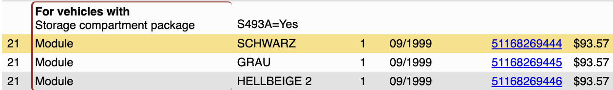

    I did this conversion twice so far. This template was included in the box both times.
    I did not cut it, and you shouldn't have to! I think it's for the option package where you have 2 extra 12V sockets for the rear passengers, but not 100% sure.
    E46/2/3/4/5 references coupe, wagon, sedan, etc. E46/2 meaning Coupe.

        I have armrest delete, and didn't cut anything.
          Yeah that cut is only necessary for the S493A option, which is the rear 12v sockets, as mentioned above.

          If you don't have that, then no need to cut.
            I have armrest delete and also did not cut anything (I have a coupe). I vaguely remember some difference between coupe and vert affecting the install though.

                      The cutout is for convertibles.
                        No, not the one from the image I published. That one is for coupes with option 493 according to what was said by others.
