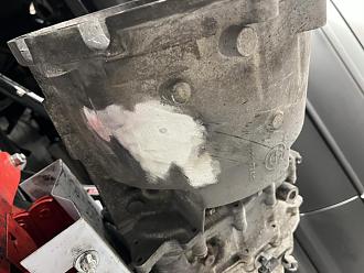

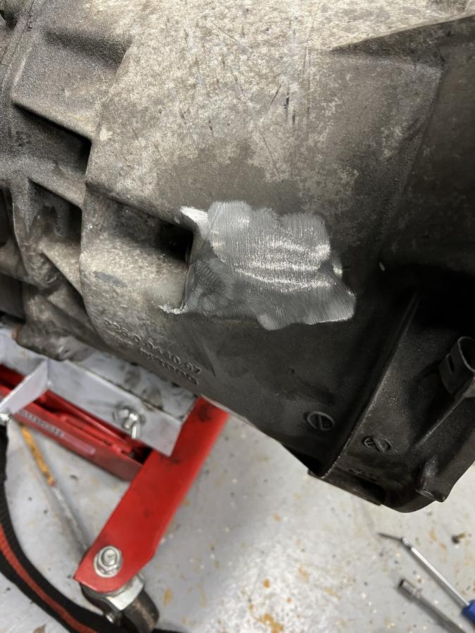

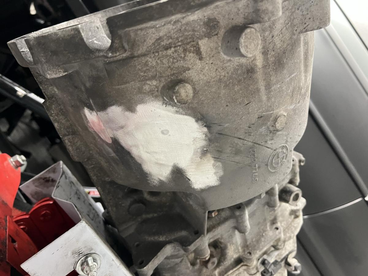

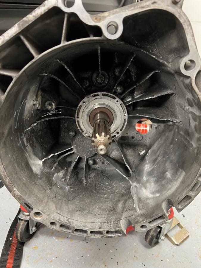

                        Well just to close the loop, had the BH welded. My friend ended up not wanting to tackle so cost me $300. Guy found a few more cracks underneath the grime once he cleaned it up. Apparently this is a common job for him. Everything went back together smoothly and car is driving fine. We'll see how it holds up come track season.

                          Originally posted by bimmer View Post
                          Everything went back together smoothly and car is driving fine. We'll see how it holds up come track season.​
                          Nice!
