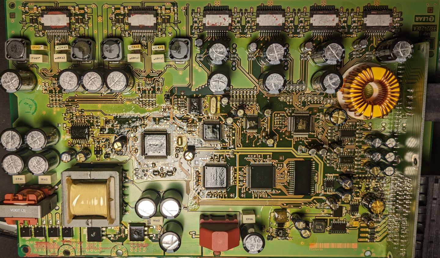

    I looked into the DSP2 unit and verified that its a 10-channel amplifier with 8 normal channels powered by four TDA1565TH with 2x40W each and two additional 30Vrms channels powered by two TDA8926TH in bridged mode for 100W each. These "high voltage" output are driven by an additional internal voltage supply that boosts the supply voltage to around 27V. Because the TDA8926THs run in bridge mode, they are only stable at 8-10 Ohm loads. The two 6.5" Carver subwoofer chassis are rated to 100W at 10 Ohm and have a MASSIVE magnet compared to their overall size. They are designed to work in a 10L unvented chassis each for best efficiency.
    Here is a photo of the whole PCB:
    DSP PCB​

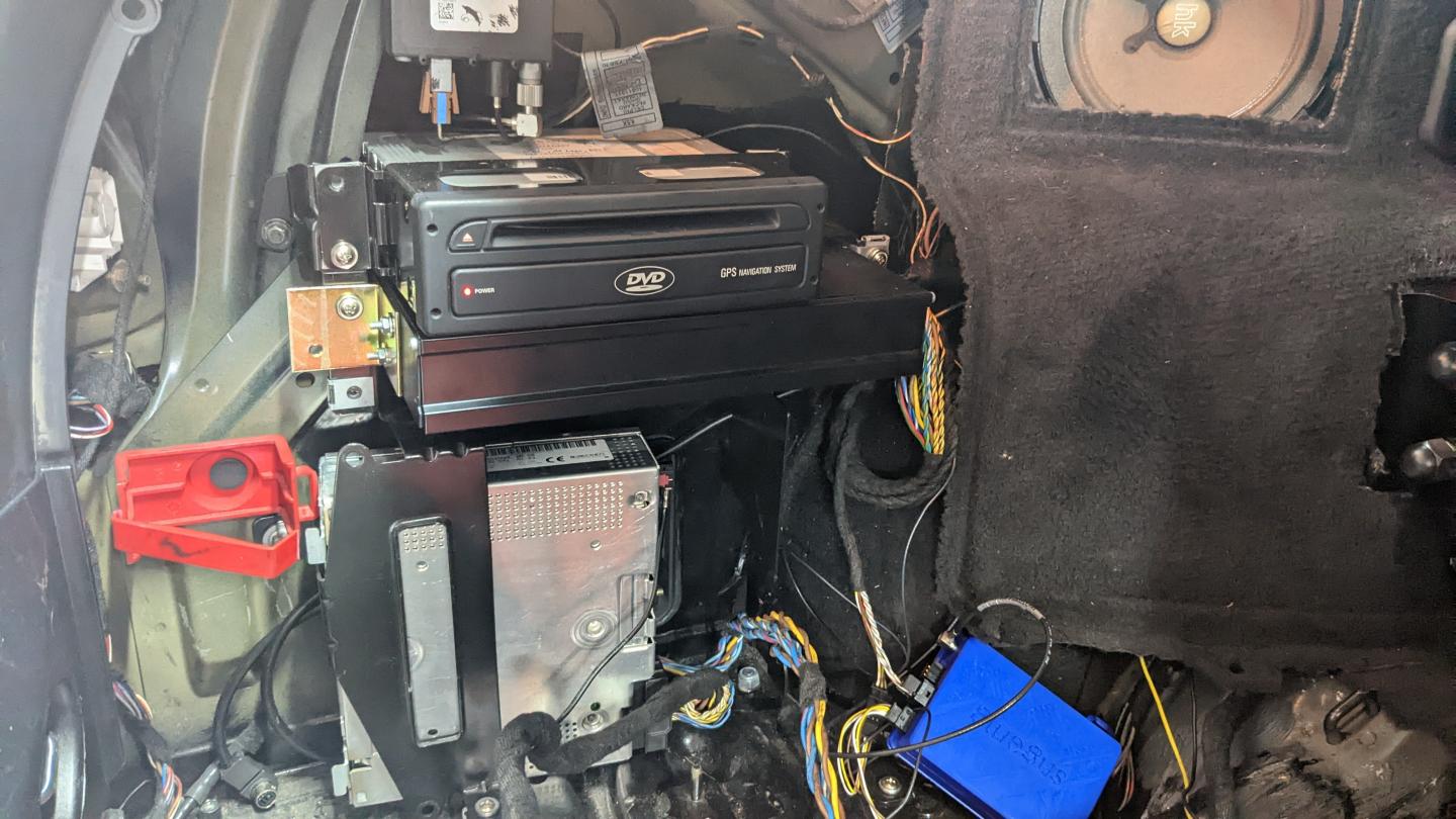

    The DSP2 amplifier utilizes the same connector as the E46 and share the same pinout except for the high voltage outputs which are wired to the rear woofer pins. So I simply connected the DSP amp to the original wiring and ... nothing. No E46 audio wiring harness configuration has the I-BUS pin occupied in the amplifier connector, so the headunit doesn't know about the DSP being connected and the DSP doesn't know when to turn on. I solved that by hijacking the IBUS signal from the CD changer cable and it worked, volume control was working again and the DSP option immeadiately appeared in my monitor menu. In the meantime, my BlueBus module arrived and I connected it using the digital input on my DSP unit.
    To mount the amp I made a small mounting bracked to store it in the orignal position where the CD changer used to be. Almost looks like it was made to sit there!
    Click image for larger version  Name:	dsp_installed1.jpg Views:	96 Size:	163.2 KB ID:	192301
    Success!

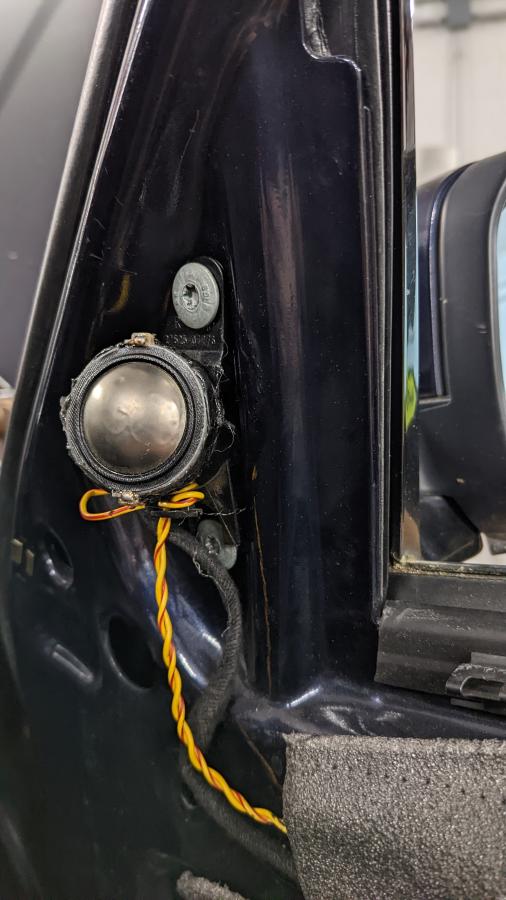

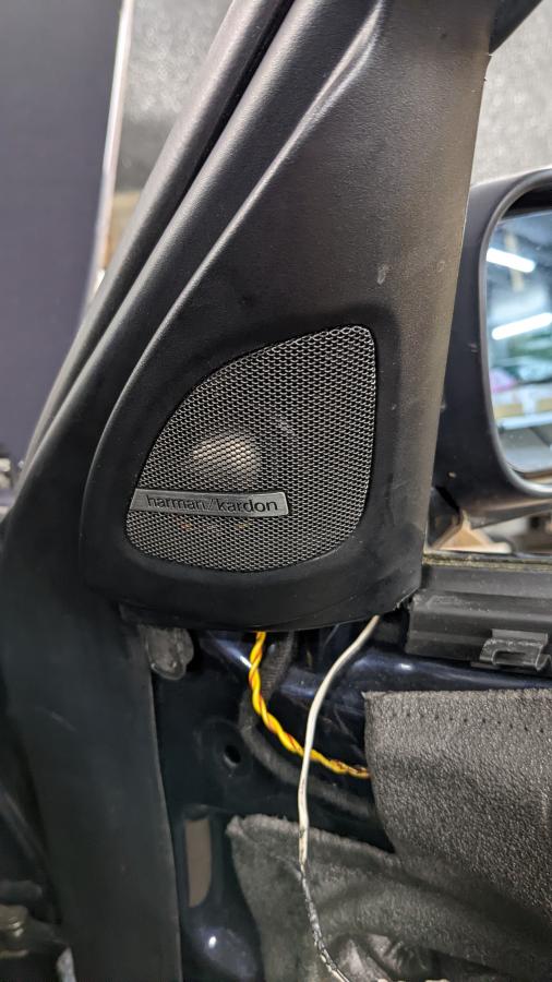

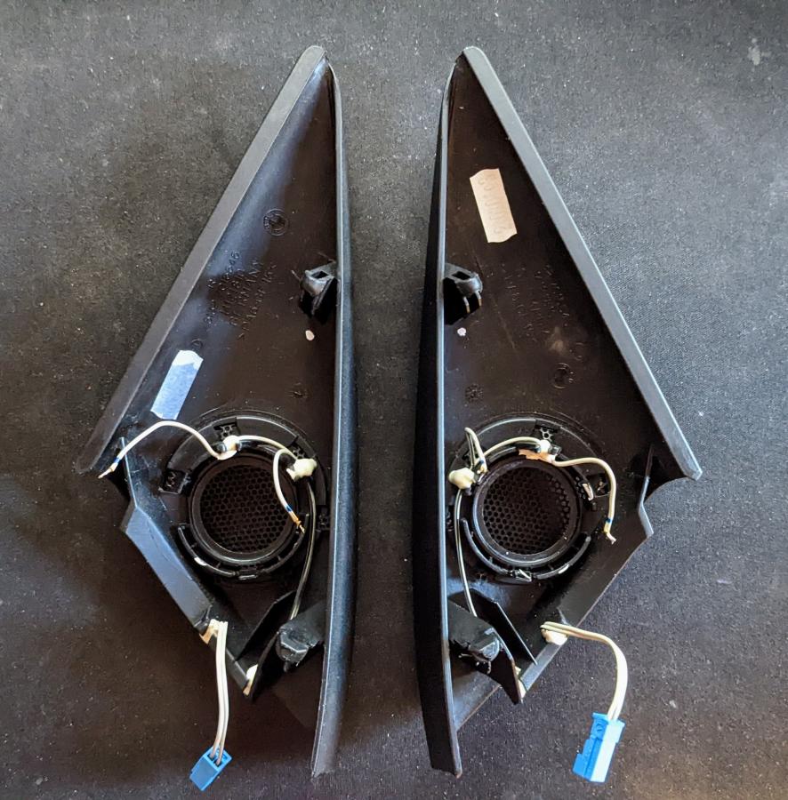

    I removed the tweeters from the Z4 plastic assembly and glued them into some old mounts from salvaged E46 tweeters. Perfect, now the highs are softer whilst more precise and match a lot better to the volume of midth and lows.
    Click image for larger version  Name:	tweeter1.jpg Views:	94 Size:	134.5 KB ID:	192298 Click image for larger version  Name:	tweeter2.jpg Views:	93 Size:	62.2 KB ID:	192299 Click image for larger version  Name:	tweeter3.jpg Views:	94 Size:	68.0 KB ID:	192300

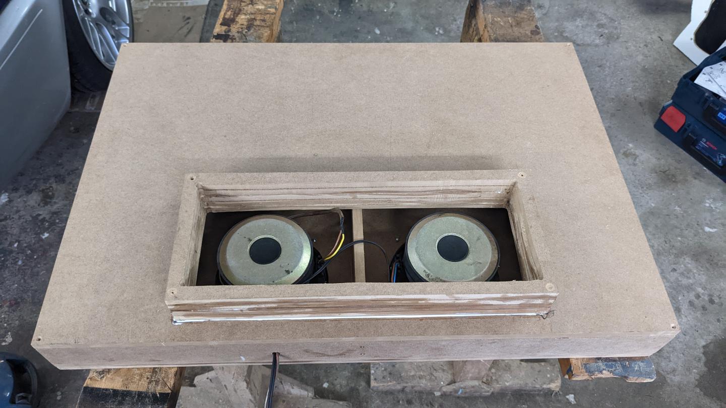

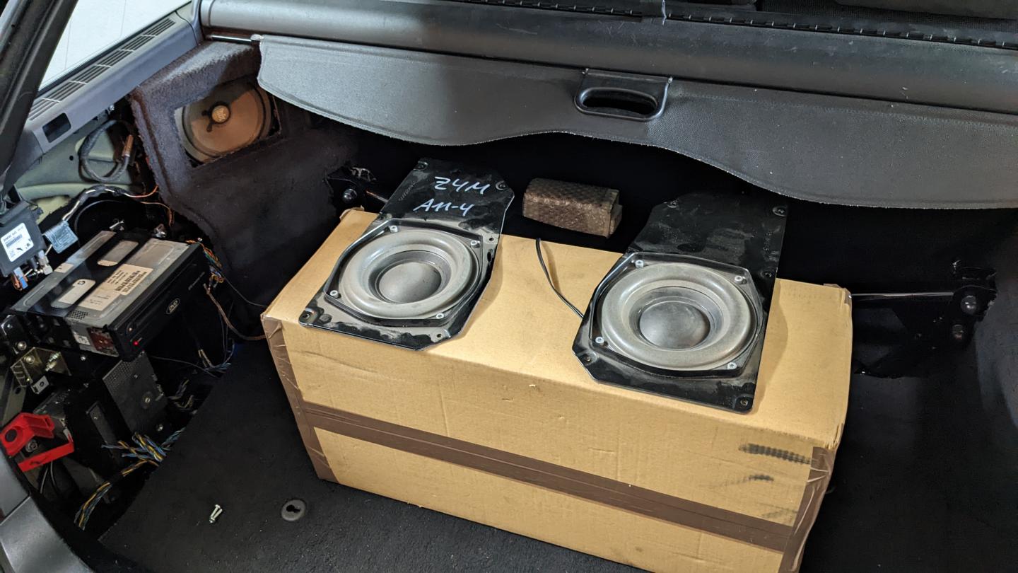

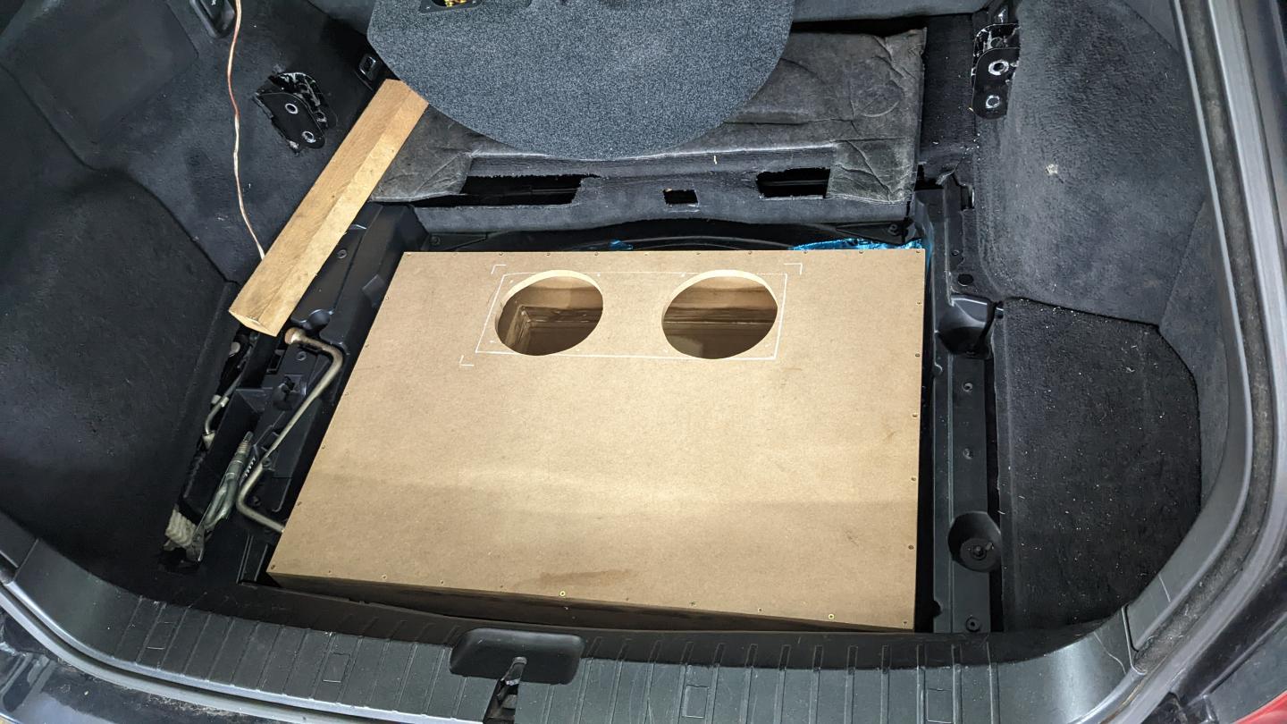

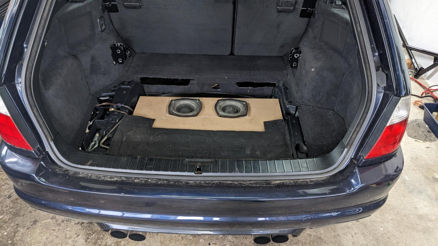

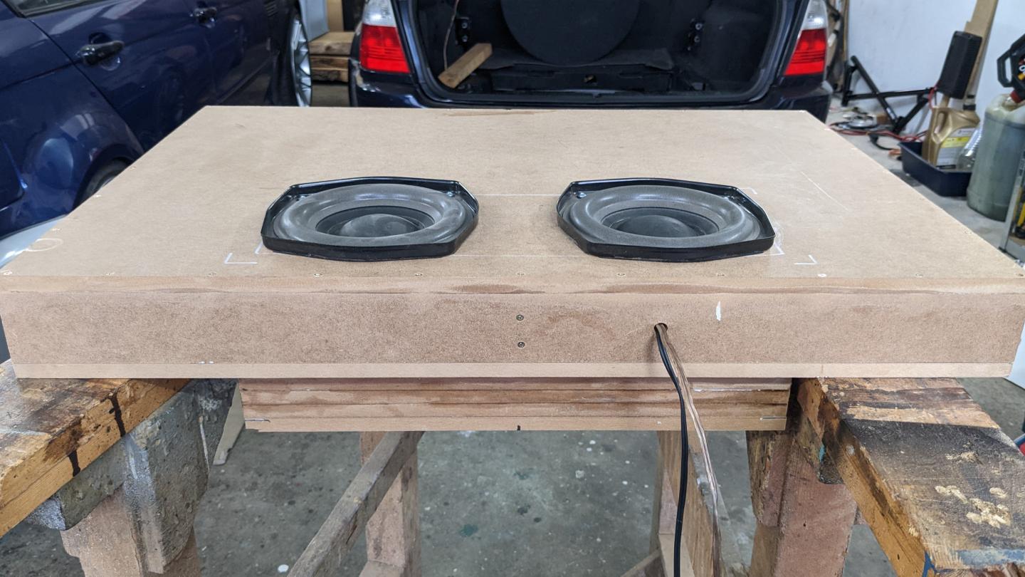

    Rear subwoofers are quite a task because of the M3 trunk floor. As mentioned before I had a small 15L closed subwoofer enclosure for my ARC Audio D4, because that was the only subwoofer I could fit into the half moon shaped M3 trunk floor. With the two Carver subs I have to gain an additional 5L volume and fit a second chassis with a long magnet, not the easiest task, but I got there.
    This was the initial testing of the woofer chassis, playing into 25L of finest cardboard
    Click image for larger version  Name:	subwoofer1.jpg Views:	96 Size:	145.3 KB ID:	192302

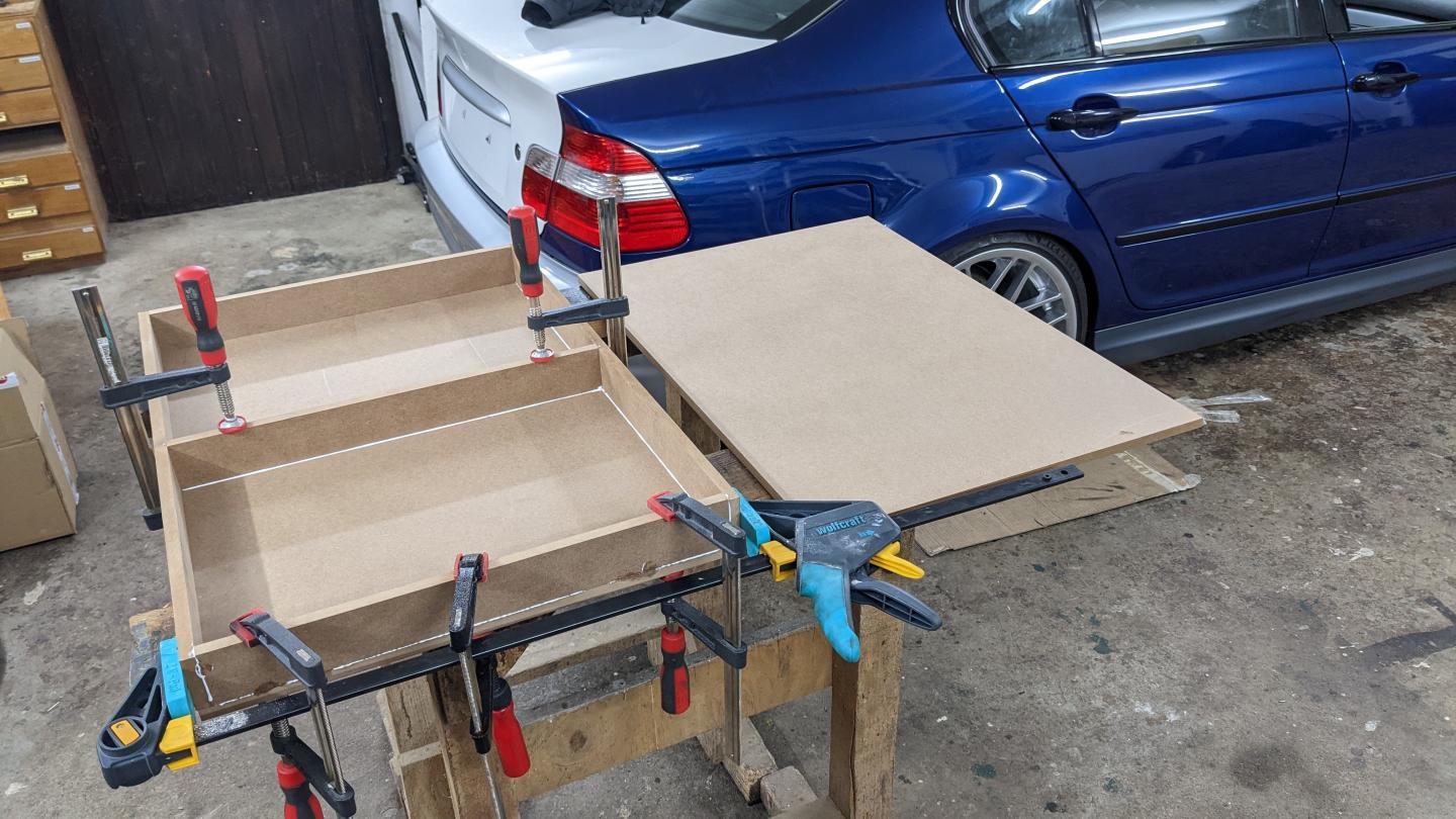

    After some measuring and calculations I am now left with 10.2L of resonance volume for each subwoofer and the floor can still be installed
    Here are some pictures. of the build process
    Click image for larger version  Name:	subwoofer2.jpg Views:	0 Size:	181.7 KB ID:	192880Click image for larger version  Name:	subwoofer3.jpg Views:	0 Size:	155.3 KB ID:	192881Click image for larger version  Name:	subwoofer4.jpg Views:	0 Size:	171.4 KB ID:	192882
    Click image for larger version  Name:	subwoofer5.jpg Views:	0 Size:	162.5 KB ID:	192883Click image for larger version  Name:	subwoofer6.jpg Views:	0 Size:	157.6 KB ID:	192884Click image for larger version  Name:	subwoofer7.jpg Views:	0 Size:	178.2 KB ID:	192885
    Please excuse the dirty trunk I had the Yurcan X-brace installed and removed it because im moving to another home.

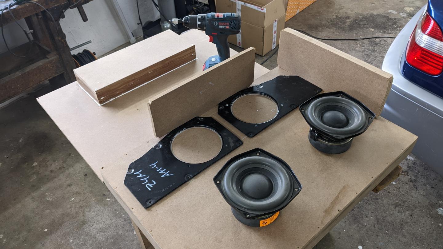

    • Definately have to fit the bass and midtone speakers, but I have an idea how to do that.
    • I bought two E90 door panels and stole the speaker mounts from it. Hopefully I can make them fit and still have the cover installed for a clean factory look.
    • Z4 Bass speaker in the front doors should be easy too. I just have to install the MDF mounts and open the door panel. Maybe I give the original HK speakers another try, before doing that.
