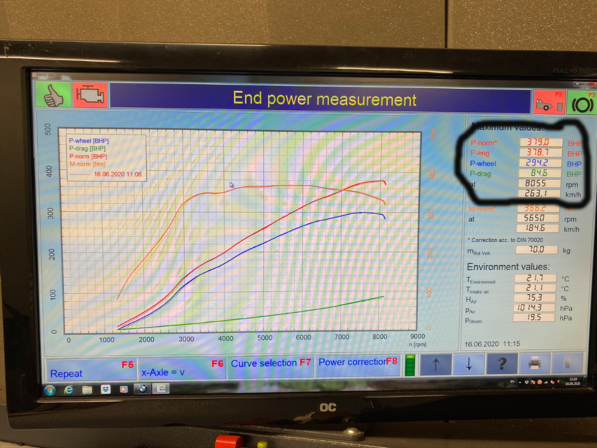

    Originally posted by Anri View Post
    Stan,
    My Man, you keep confusing based on what you are used to see on Dyno-Jet.
    Again, follow the logic here, UK will rate BHP crank HP much lower than BMW
    AG advertised the S54 at 343 DIN HP Crank.
    In this exact case, you do have the saying.... "Dyno is a tool to see the improvements from the parts being installed"
    aka Before and After. So if Martyn's S54 base run is 200rwhp and after tune box etc makes 230rwhp
    you have 30hp gain over the base run and that's it don't keep looking for logic to compare to DJ
    Accept the European Dyno services again as tool for "Before and After"..don't try to search for logic of
    what you and I are used to see.
    Like I mentioned before never been fan of this hp presentation. I am also pretty much sure that Dyno-Jet
    will have much stable weather factor calibration, I have seen the Dyno-Jet too change from different days
    from 14% down to 13%. So very little % in weather factor changes.
    Regards,
    Anri

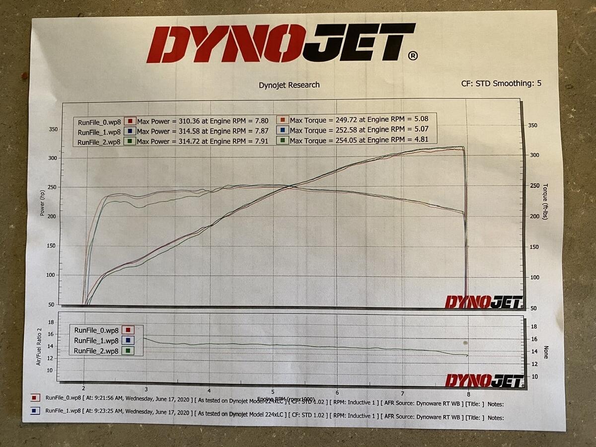

    Ahhh sh*t balls then, thought I was really on to something. Sooo, there is absolutely no way to make any type of comparison between EU BHP numbers and a Dynojet—got it! I thought that you were just saying that the driveline % calc was off...but it just doesn’t flush.

    I think I’m following...so, his car made 378BHP, and 294WHP...based on a 22% driveline loss vs. the more normally accepted 14-15%—correct? So, if we extrapolate, and figure the WHP based on say 14%, his actual WHP would be closer to 325? That seems a bit low to me (for the mods) vs. what I’m used to seeing. Typically, cars w/cams air boxes & supporting mods are in the 340-350WHP SAE on a Dynojet.
    Stan,
