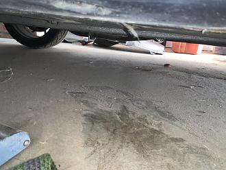

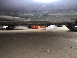

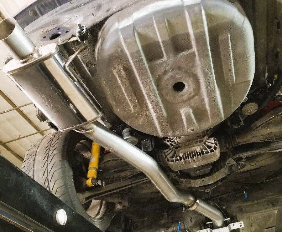

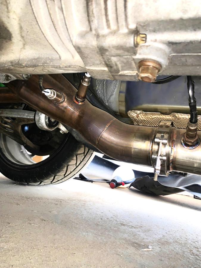

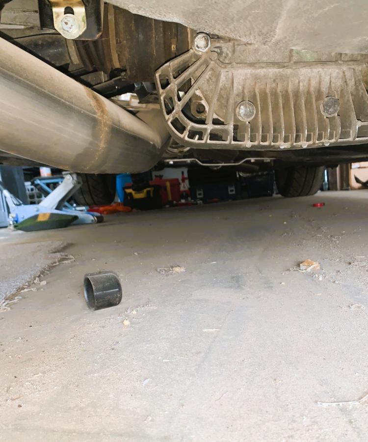

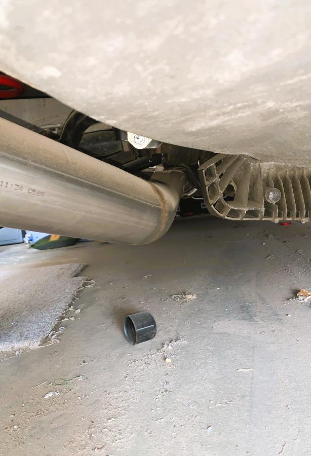

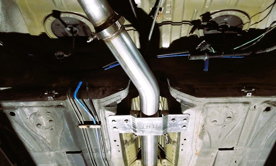

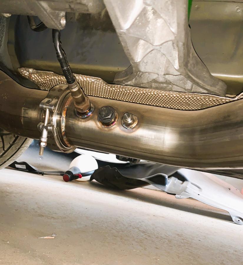

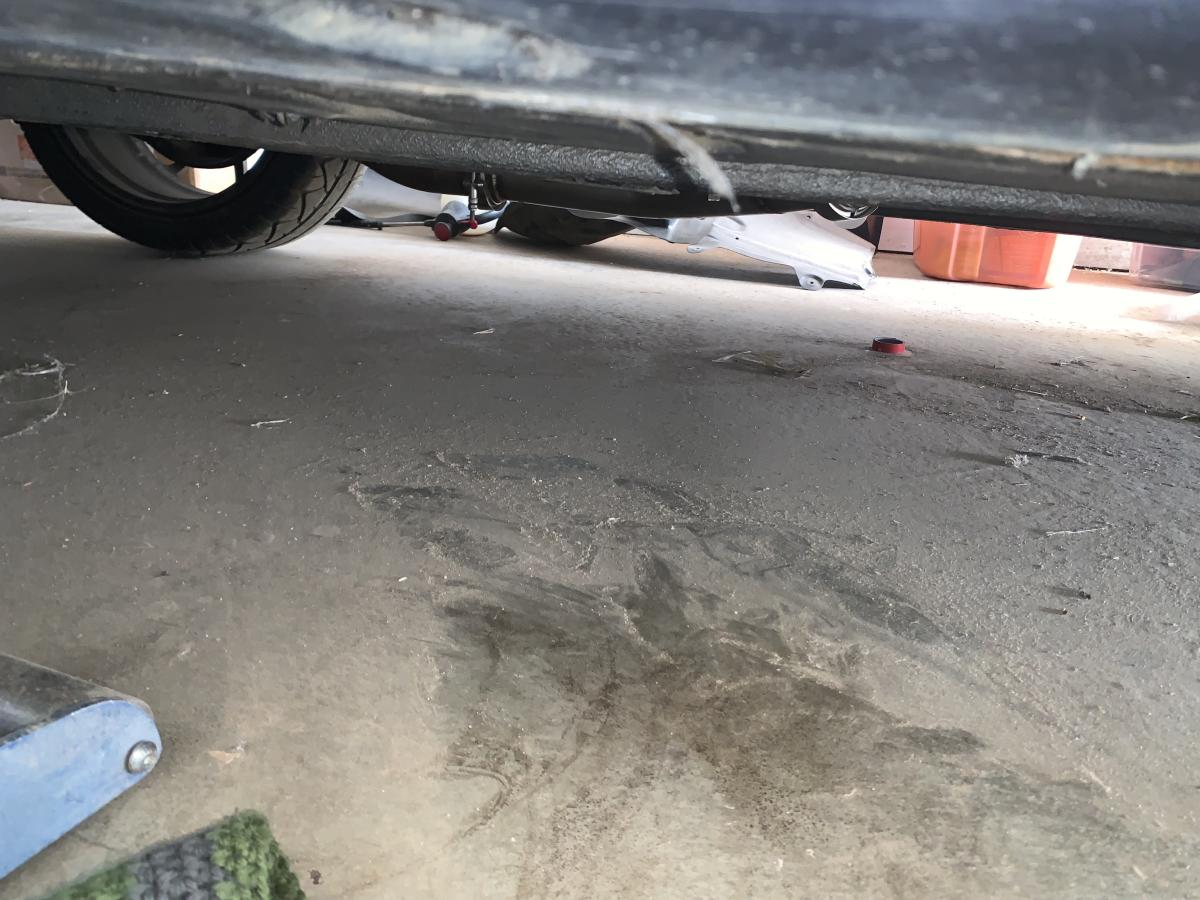

          Click image for larger version  Name:	ARH 3.0 to HHR 3.5.jpg Views:	0 Size:	94.4 KB ID:	300317 Click image for larger version  Name:	HHR 1.jpg Views:	0 Size:	94.7 KB ID:	300318 Click image for larger version  Name:	HHR GC.jpg Views:	0 Size:	131.6 KB ID:	300319 Click image for larger version  Name:	HHR to BW 3.5inch GC.jpg Views:	0 Size:	116.9 KB ID:	300320 Click image for larger version  Name:	BW 3.5 inch.jpg Views:	0 Size:	66.8 KB ID:	300321 Click image for larger version  Name:	BW 3.5inch.jpg Views:	0 Size:	88.2 KB ID:	300322 Click image for larger version  Name:	BW to HHR Full.jpg Views:	0 Size:	147.9 KB ID:	300323 Click image for larger version  Name:	BW 3.5 Rear Exit.jpg Views:	0 Size:	201.7 KB ID:	300324
          From Left to right, ARH 3.5" to HHR 3.5" (two 02s). HHR 3.5" 3 Bungs, AFR, Back Pressure, EGT. HHR to BW 3.5" Ground Clearance. BW 3.5" Ground Clearance. BW 3.5" Diff Clearance. BW 3.5" Ground/Diff Clearance. BW 3.5" Center to Non Resonated. BW 3.5" Straight Pipe Diffuser Exit. This system is considerably lighter, than any other on the market. Unless you have a full custom Ti exhaust, Flame away. 3.5" = 9.62, Dual 2.5" = 9.81. Difference 1.9% 🧙‍♂️
