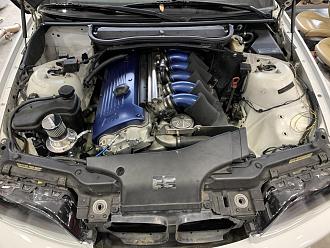

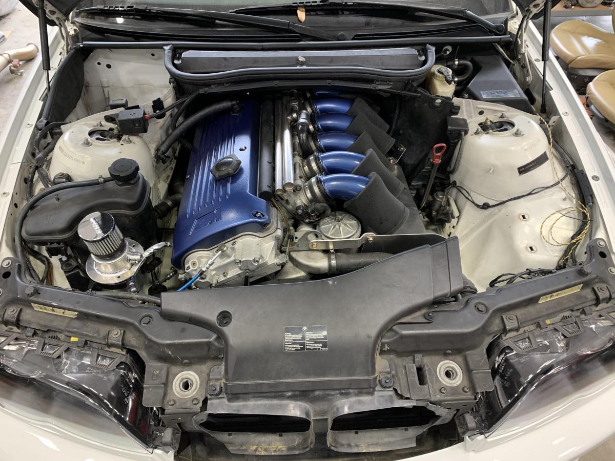

                      I had just stacks on my car for a little bit as they are certainly fun. At that time I had the IAT mounted on the strut tower. I found that after coming from a stop that the IAT read much higher than ambient, but would eventually make it down to just slightly above ambient. So if I was cruising down the highway for 2 miles and went WOT the stacks were not sucking a ton of "heat" as read by the IAT.
                      I had a Karb plenum on my car and when I was drag racing it if we hot lapped it we could see the car slowing down, taking the hood off netted me 3 tenths in the quarter. Maybe some of that was inconsistency in the driver, but still my takeaway was that an unducted CSL style plenum is not THAT much better at controlling under hood heat ingestion from a stop.

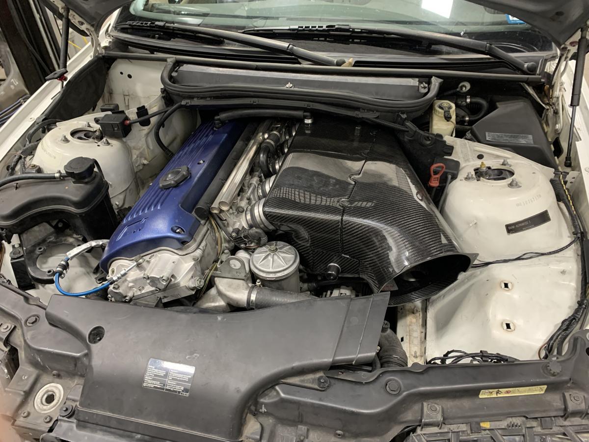

                          Yeah, done this test a few times in a few different ways. You just won't beat the CSL airbox with any sort of open velocity stacks, even for peak power. It gets even worse if you then add individual filters for each stack. The absolute worst thing you can do is run those "rock stopper" stainless mesh filters on each stack. Not only do you have almost zero filtration, you actually have very little flow surface area. The filtration surface area of the CSL filter is massive in comparison, and remember that only one cylinder at a time is in the meat of its intake stroke, so you essentially have the entire CSL filter area providing airflow for each cylinder.
                          Recently had a pretty serious S54 on the dyno 12:1 (limited by racing class), 296/288 high lift cams, Emtron standalone ECU. We made a genuine ~385whp SAE @ 8600 RPM with a Turner airbox on this car. Since it's a proper race car, we knew we'd never run actual open stacks because that's just silly unless it's a show car when things like carbon airboxes exist, but we WERE interested in figuring out if there was a better trumpet length for this engine setup than what the Turner CSL box comes with, so we decided to dyno the car with various length open trumpets, starting with one that matches the CSL box length. Each time I adjusted the tune to match the trumpets. The results were so bad that I didn't even bother to take pictures of the dyno graphs. Peak power with the open trumpet "CSL length" was almost the same, but low and midrange torque suffered significantly. Additionally, both the shorter and longer trumpet lengths not only lost low/midrange, but the top end was also worse, showing losses between 5-10whp depending on the configuration, and up to 20 ft-lbs. We were shocked as we expected the shorter runner length to provide some top-end benefit at the expense of low-end. It either told us that the open stacks are just straight up worse in every way, or that there was no advantage for the RPM range we're running in to go any shorter than the Turner CSL runner length.

                              I don't believe the airbox detracts when done correctly and in reality provides notable benefits. Also 6 cyl on a common plenum vs 4 is different animal.
                              Years ago i tested itb with open trumpets vs itb with identical trumpets with a large airbox with open hood (not on a s54) the airbox wins simply due to density improvements from being able to to duct cooler air.
                              the gains on the street are even more notable because the hood closed exacerbates heat issues. i know of two others who have found the same thing.
                              The airbox needs to be large so it basically acts like open trumpets it is not introducing large pressure variations (i.e. no plenum volume tuning effects as with 6 cyl drawing from a common plenum its almost a waste of time due to too many closely spaced pulses) and in effect the airbox is just a large shield keeping air from the rad and other heat sources from being ingested.
                              I cant say I've ever seen a high end pro race team running ITB with open stacks they seem to have quite elaborate CF ducts that are enormous.
