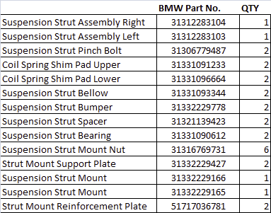

            It's looking most likely I'll end up with the Koni/Eibach kit.
            Are all these parts required for the fronts? If so, I might as well refresh them...

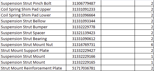

              Looks about right other than 1st two items. I would also maybe order some new bump stops.
                  Definitely new bump stops
