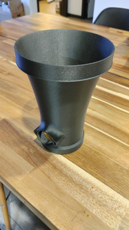

    1/18/23: I splurged on the stiffest strongest filament I can reasonably print, 3DXtech Carbon Fiber polycarbonate.
    This is several times stiffer than pure polycarbonate, and stiffness made a fairly significant impact on sound.

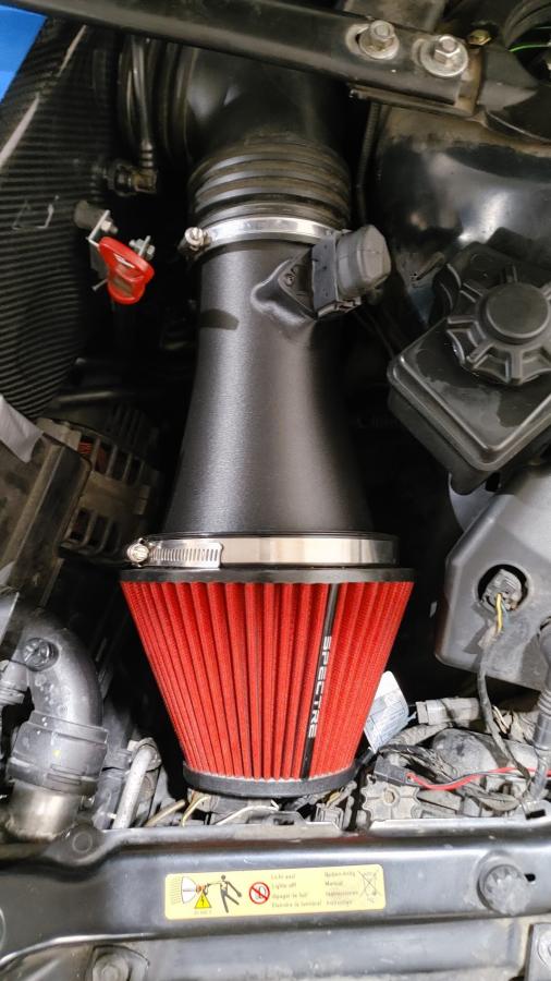

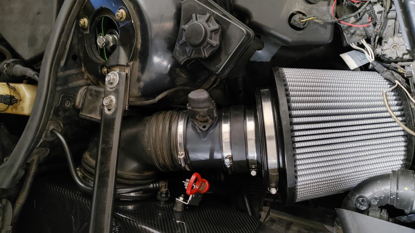

    Got tired of my K&N running funky and decided to 3D print a MAF housing to perfectly transition from a velocity stack to MAF to OEM elbow.
    Result: It no longer wavers at idle!
    Bonus, WAYYYY larger surface area (Part: aFe 21-91035)​, and a smoother transition into the MAF.
    Was super happy that the MAF opening design I did made for a perfect friction fit with the O ring and the offset amount on the screws was perfect.
    Sound is slightly so different from the K&N, similarly loud but a tad more sonorous?​
    Next steps:
    • I accidentally offset the MAF screws backwards in Fusion towards the elbow instead of toward the intake, so will be reprinting with that fixed.
    • Am also waiting on a CF bellmouth (Part AF64-4971)​ to come from Australia to shave down a bit of weight and have an elliptical bellmouth profile vs the circular on this cheap Spectre (Part: Spectre Performance 9605).
    • Will try for a silicone elbow, too. The flex in the ribs are actually pretty nice actually!
    • Redo the air blockoff because between the CSL SMG fluid tank and this new filter, the K&N shield isn't even close to fitting.

    Quick pic, feel free to laugh at my awful sense of direction on both the photo and the maf screw offset.

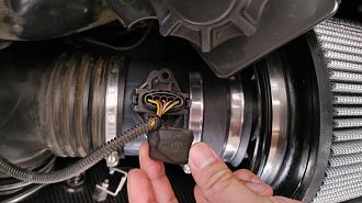

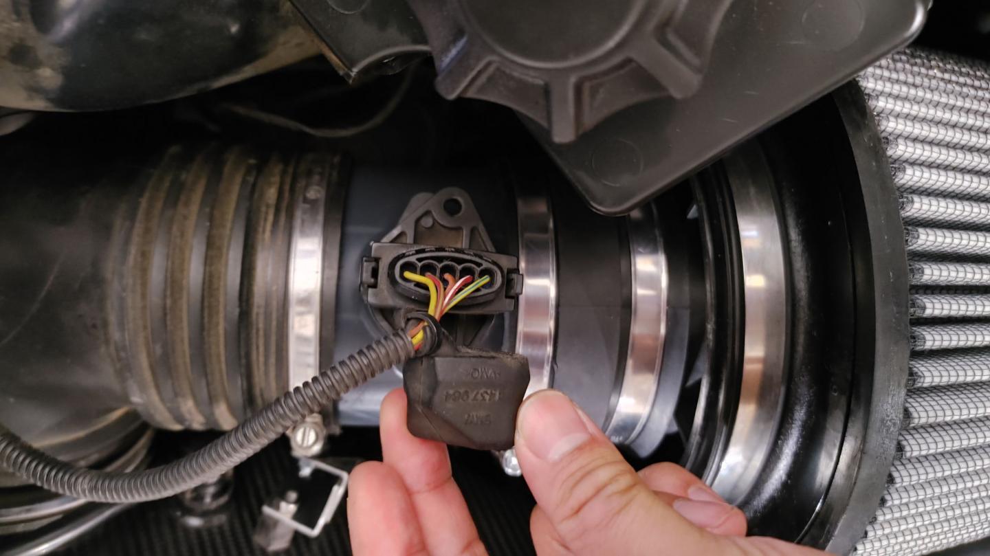

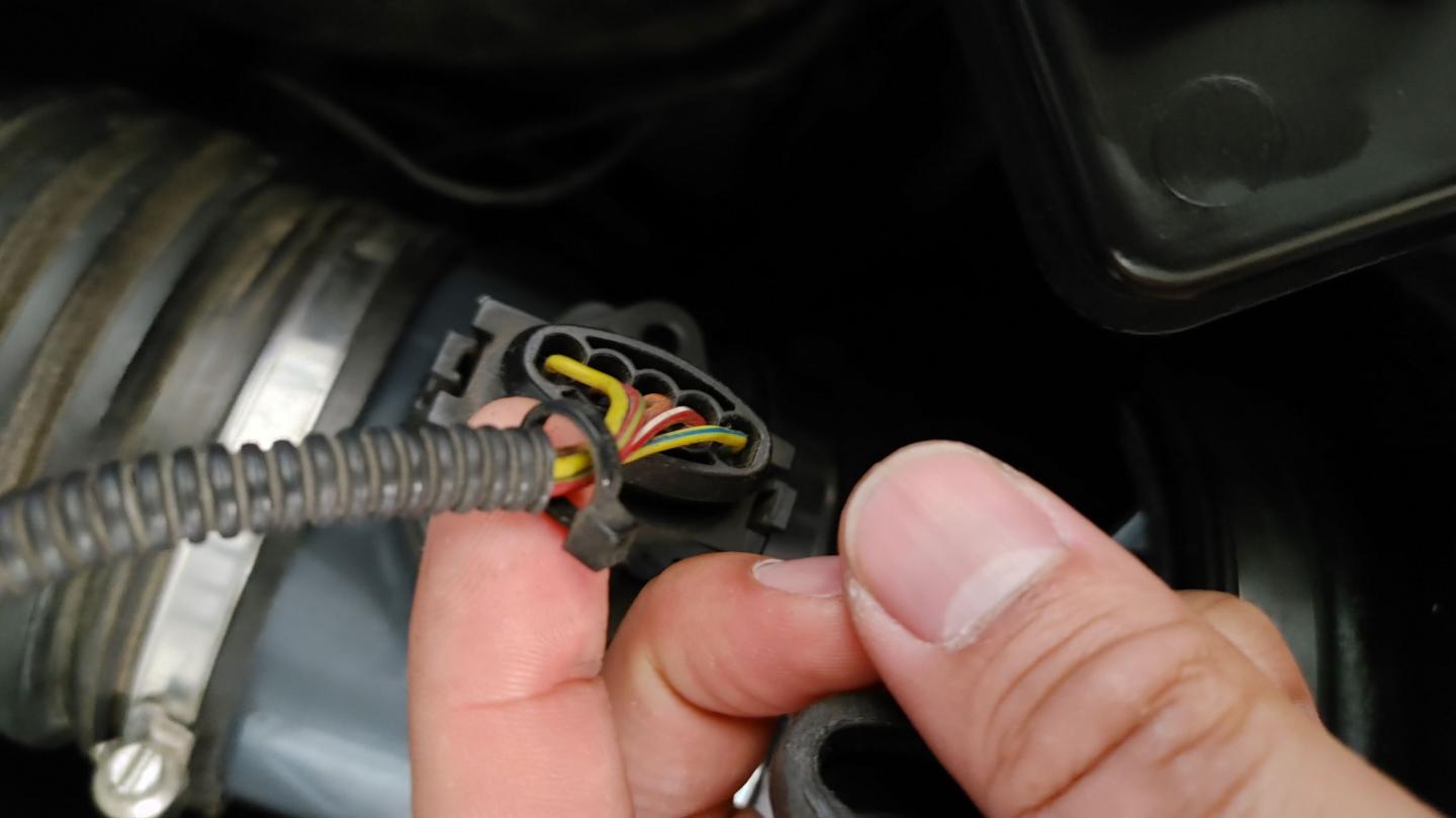

      Are you sure MAF is pointing in the right difection? Looking at MAF harness, you should rotate 180 degrees
        I used a resin printer! So it cures by UV and can go well over 100C (Def won't get that hit there)

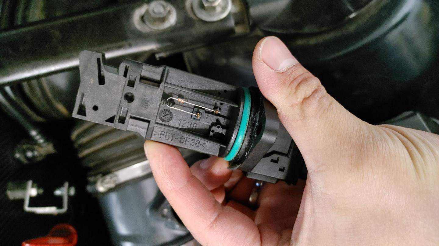

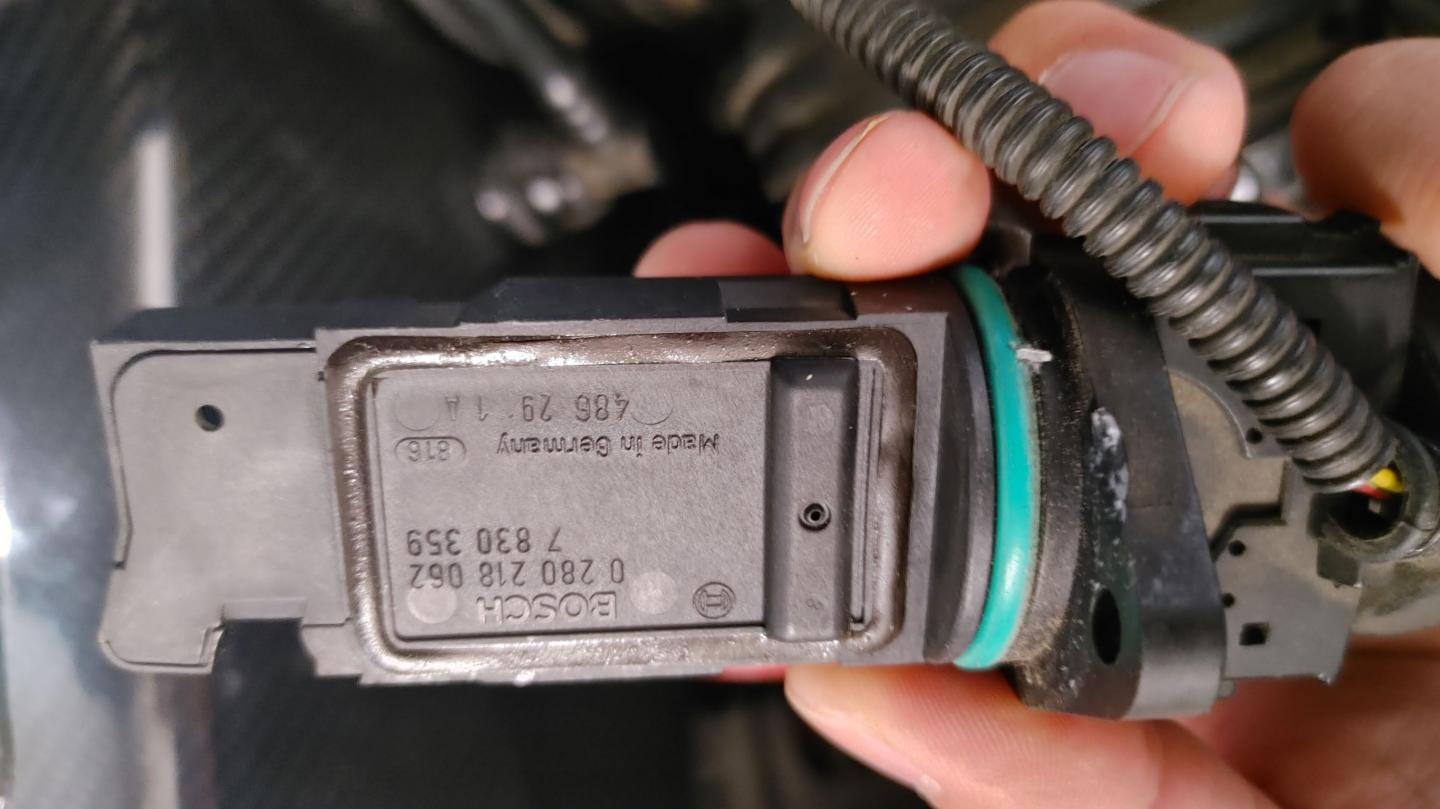

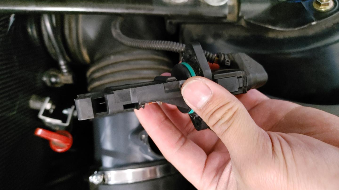

        Shit, you're right, so the maf sensor plug, the tabs, after checking are the right way, but perhaps previous owner installed the harness on the sensor backwards???
        Edit:
        Checking my spare maf, the plug is very directional! So unsure how this happened.
        From pictures and the OEM sensor, my plug orientation as it is matches: offset tabs are towards the filter.
        Very puzzled right now

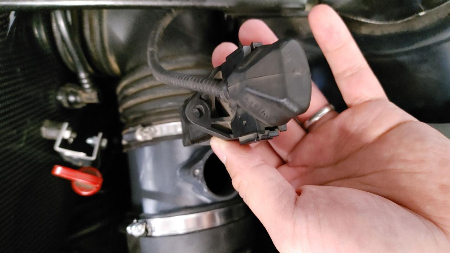

        Ok, took it out and checked, still perplexed, because the harness is definitely in the plug the right way (no way to put it backwards) and from pictures, it DOES look like that cut out notch has to go forwards towards the filter, right?
          Ok, fixed it by turning the boot around

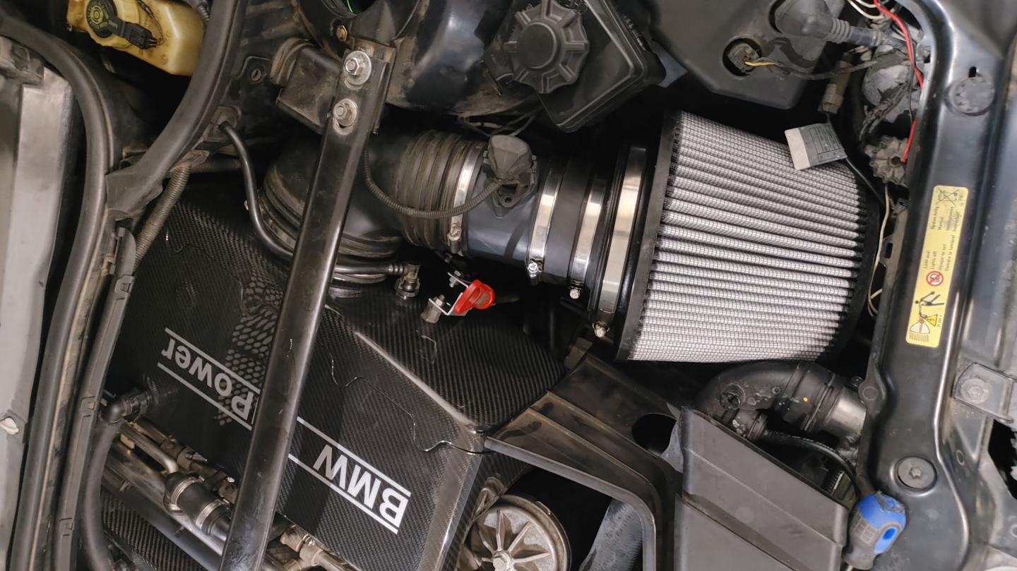

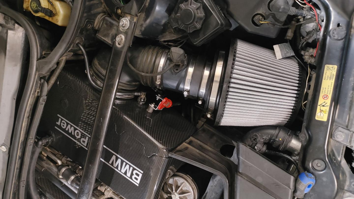

                  Updated my printed MAF to have the right screw orientation and swapped to a CF bellmouth that has an elliptical inlet curvature instead of a constant radius one. Also, used some clear resin instead, and made the housing shorter.
                  A part of me wants to just use the old K&N 4" ID filter just for simplicity, but love the sheer ridiculousness of this thing. It's massive.
                    Looks like you have the stock Karb box as well
                    Sound clips?
                      I have sound clips in the Karbonius thread but stopped sharing because my phone mic doesn't actually do the changes justice. It made all the volumes sound the same at the end.
                      I'm still working through some revisions, and making sure air flow is smooth and MAF readings are accurate. Might put together some kits eventually. My goal is to switch to printing this from ASA to make them less brittle and build in a 5" velocity stack, instead of using an expensive CF adapter (6" is a bit ridiculous...). Dunno if there's any interest though.
                      Also, still looking for someone who can lend me an Eventuri. Just the housing and MAF piece really. I'd love to have a comparison between them and log some numbers too. Will give my old plastic bellmouth and maf housing as compensation for the troubles.
