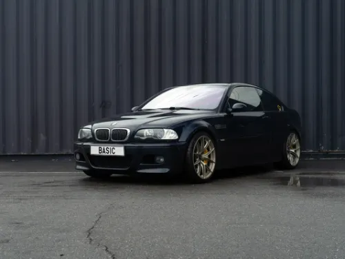

But now I would really appreciate some more tailored advice to my situation right now.
I want to use Apex Black Friday sale for some lightweight 18”. But I am not really certain of the ideal spec and also I am concerned about fitment.
As for reference, my car is weekend car, road trips, mostly spirited driven street car with intention to attend hobby track days, hill climbs, nordschleife trips etc.
I want to retain certain civility of the car, currently in progress of weight loss( recaro pp, lithium battery, carbon roof, custom rear seat delete, etc).
Suspension setup now is progressive springs KW V3, with KW camber plates, brake setup is ST40 355 4pot all around. Currently on heavy ass 19” CSL, but the car is terrible on them. I know this suspension runs into clearance issues with wider fronts.
i have never run square setup, I wanted to try that.
I want to use one set of wheels, Debating between
staggered setup 9j et30/ 10j et25 with 245/265 semi slicks cup 2’s or A052, more conservative and less flexible setup
square 9,5j et35, when I would be free to try and use 255 or 265 square setups and even stagger back to 245/265 if I did not like square. Apex guide says 5mm spacer up front and 12mm rear should do the job with “at least 2degrees of negative camber”. But my local bmw alignment guy is skeptical about square 9,5j setup clearances because I have progressive springs and recommends stagger. I also would like to avoid crazy front camber as the car is used on the street too. Currently on 2,5 negative front.
what would you guys recommend with my status quo?
thank you very much for your insights 🙏
