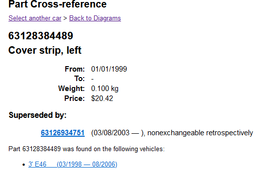

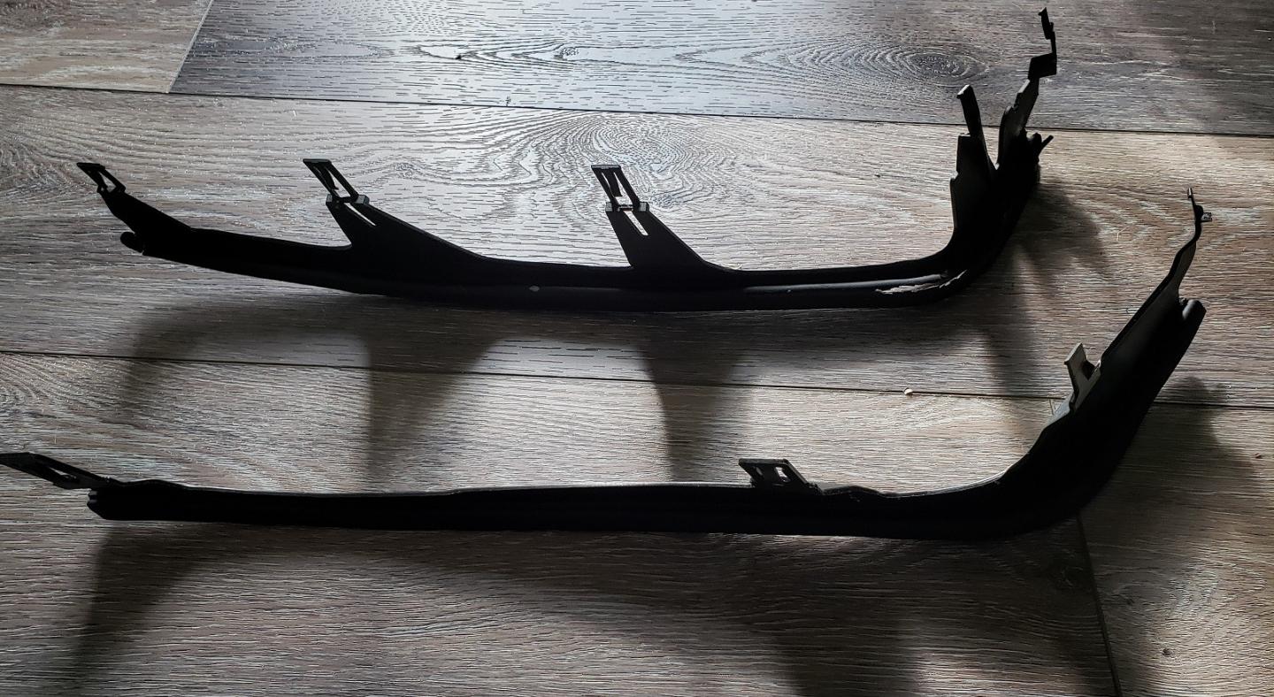

    When simple things aren't. I ordered cover strips for my 06 headlights. Looked up in Realoem, results below. Covers are way off, the connectors don't match up at all.
    Original top, replacements below. Anyone run into before? TIA.

      Might be for a facelift coupe headlight that came on the non-Ms.
      The M3 has the same headlight as the pre-LCI coupes (pre 09/03…I think).

          These are wrong part #s. These are post facelift coupes, never used on E46 M3.
          The P/Ns you are looking for are 63128384489 and 63128384490.

              So was RealOEM wrong? Or did I not read correctly? I thought "superceded" meant that's the new part number.

                    It looks like OP ordered 63126934751 which is the standard 3-series facelift part.
