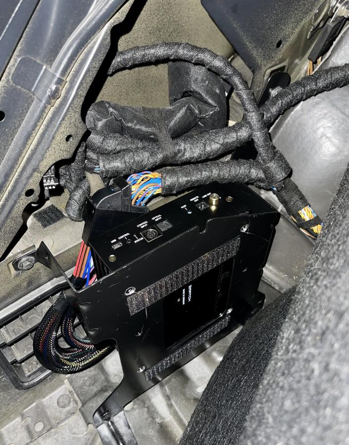

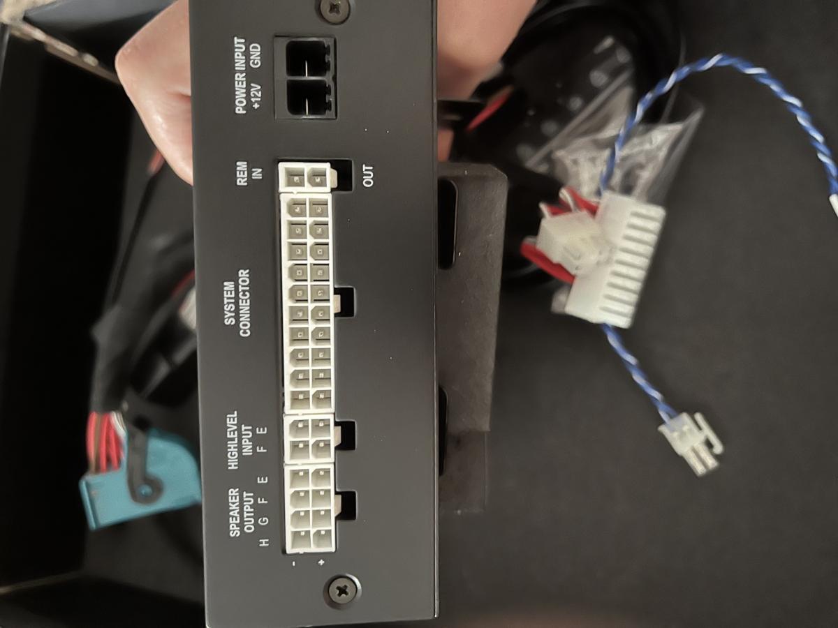

    Well even though it is a way better experience the sound wasn't amazing and the power for the interior speakers was lacking. I kept trying to read about people upgrading the factory amp to a JL audio or AudioControl amp however I didn't want to cut any of the factory wires to make that work. And not many posts with upgrading the Hi-Fi system most were with the HK. Then I reached out to Audiotec Fischer and asked if they had any plug & play amplifier upgrades for the older E46 platform that uses the Hi-Fi 676 option. Well they forwarded my email to the USA side of their business and it said that the Match UP7BMW amplifier would work without any issues. It’s expensive at $1100 however I used to work at a dealer and a friend that works there got me a better price. I took the chance and today after installing it and uploading a pre-made sound setup file this thing is amazing. The power is unbelievable for such a small digital amp. I will need to learn more about tuning it however I might just pay to have it done next year. Hope this helps someone in my situation.

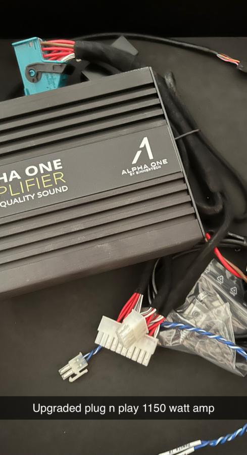

          I purchased a match 7 dsp amp for my 2022 X5 and was sent an upgraded match 8 dsp amp. I’m not exactly sure if there more power in the 8 vs the 7, but lemme tell you this amp kicks a$$!! What an upgrade to my X5 hi-fi. It was $1350 well spent from Bimmertech.

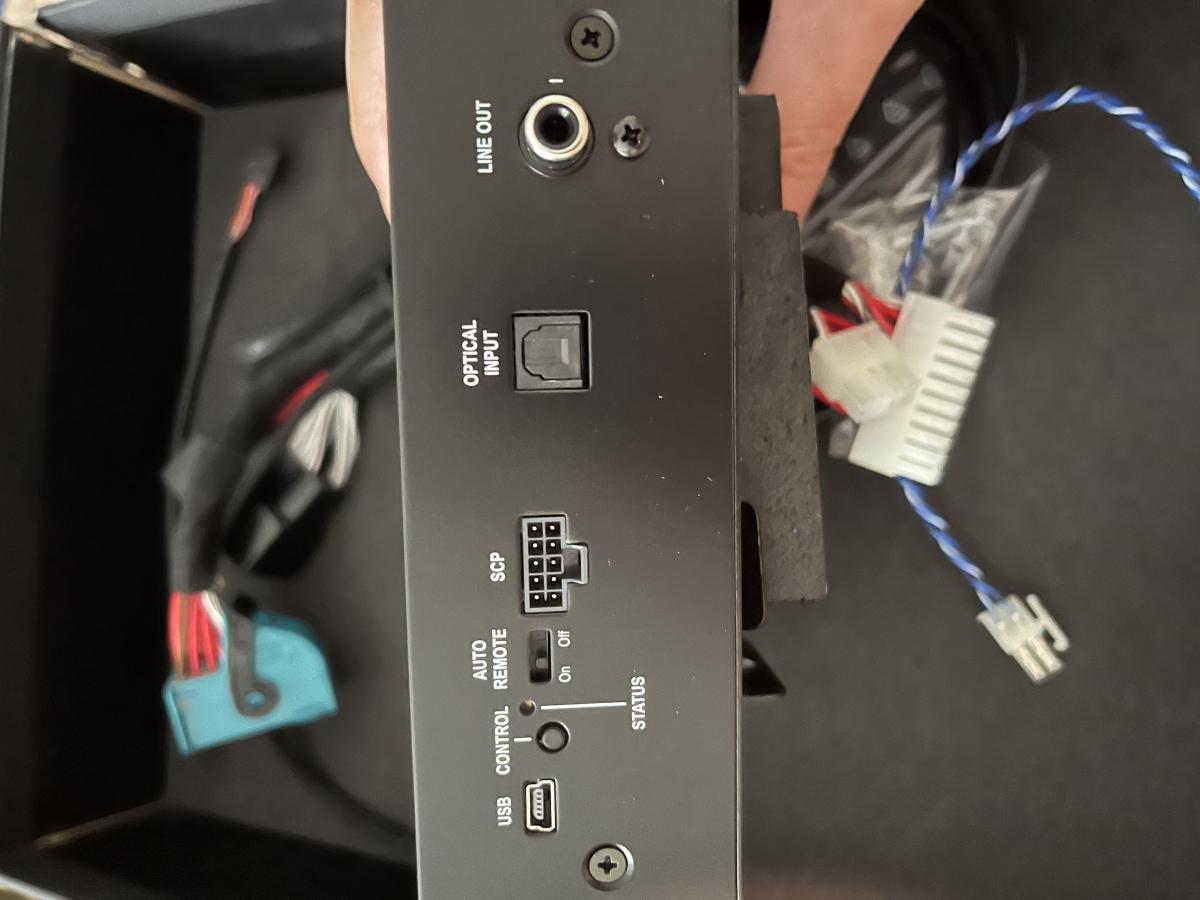

          Op, did yours come with a usb cable that connects to the amp? You can go to the audiotec fisher de site and look at the drop-down box for “tools” and download the correct adjusting tool. This is an EQ and I would recommend adjusting it little by little at a time. This is what all the X5 guys on bimmerpost said. The adjustments really do make a big difference. This amp peaks at 1150 watts and 650 watts rms.

            Yes mine also has the software and usb cable. I just loaded a stock file from their site to get me going. I will need to try and learn a little more about adjusting the EQ and timing delays. If not depending on cost I will have a local shop do it professionally in the spring. So far it sounds light years ahead the stock amp.

                  Yes however just check with them for the HK model that will work. It took me longer to mount the amp then getting it to work. The power output is way higher and cleaner than the factory amps. I love it so far. Just need to learn how to tune it so I can dial it in better.
