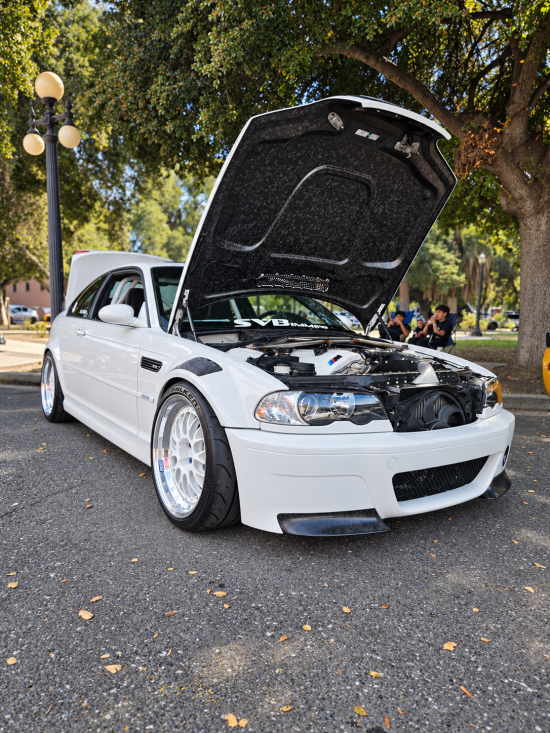

      The forged one they show on the website is my actual hood... I'm the only forged one they've ever made.
      Fitment is good, but as to be expected, there is fitment required. It's carbon fiber.
      I also fit carbon fiber fenders, and a carbon fiber bumper at the same time.... so my entire front end is carbon, nothing is factory.... so, I have many hours of labor to my body shop getting them to fit well, and I still wouldn't call it 100%.

      If you're asking this question, you should probably pass on carbon fiber. It's not going to fit like OEM panels would.​

        Looks sick but your comment on fitment is a little disappointing.
        Although I wonder if fitment is less of an issue when pairing the Karb bonnet with stock bumper and wings?

          It will definitely be less of an issue, yes.
          Karbonius is a premier Carbon manufacturer. They produce nice pieces. I just want to set realistic expectations. Carbon fiber is almost never a 1:1 fit, even when you talk about Karbonius, Adro, and Alpha-N ... they still need a body shop to massage them sometimes.
          This is especially prevalent as you start to reach the end of life on a mold.

            Of course and fairs.
            Although it begs the question as to how BMW are able to get the fitment on their F series CS bonnets on point…

              I think the hood is the easy part, when you start talking about widened fenders and CSL bumpers you're changing part dimensions.
              Also, these cars are more than 2 decades old at this point. I think over time, and mileage, panels maybe don't fit exactly like did at the factory 23 years ago.
              My car doesn't have any accidents on the carfax, but that doesn't mean it never got tapped.

                  BMW uses what appears to be steel tooling molds which would cost 10s of thousands to make...maybe more.
                  Aftermarket tuners usually use a composite mold which are economical but not as stable as metal. Epoxy produces a lot of heat when it cures which heat cycles the composite mold and can cause the slightest amount of warpage. As parts are pulled from a composite mold, fitment is likely to get slightly worse.
                  I think it would be smart to leave the edges unfinished and allow a body shop to do the final trimming and finishing which I think could improve fitment in a lot of cases. But most customers expect a bolt on fit so probably not acceptable.
