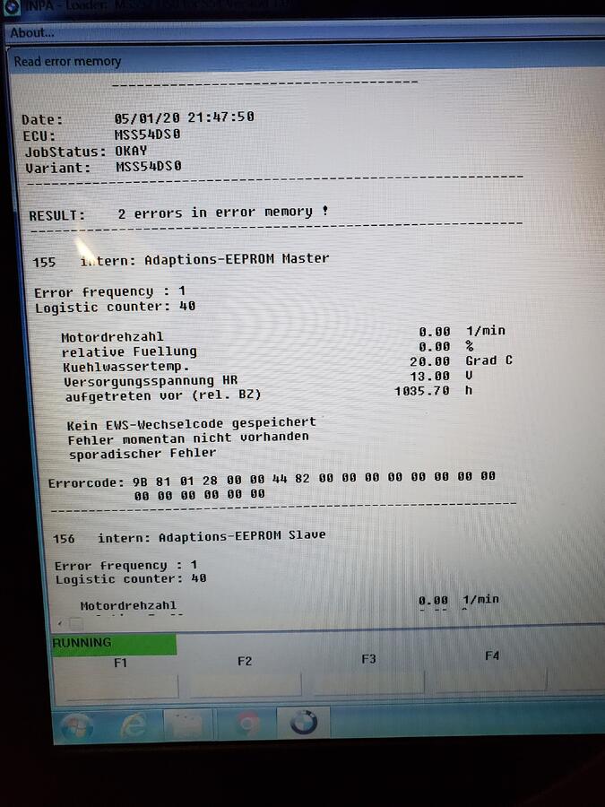

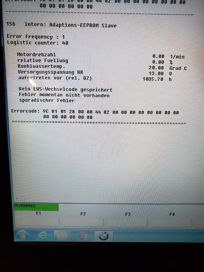

      Have these two error codes posted below. Kassel said something about re-syncing the EWS, what does this do and how is this done? I did see an option in INPA tonight that said something similar to "EWS Reset"

        It means the dme doesn’t have any EWS code stored at all. You can pair it with your EWS and undelete EWS if you want.
