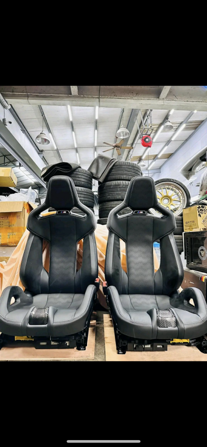

    Can anyone confirm if the G82 front seats would bolt into the M3 factory bolts?
    wiring diagram that I can use to wire them as well?
    pic for attention

    How much do these seats weight?
    Normally, factory seats weight a ton.
      I don't believe they fit directly because I know they fit into F8x cars but the F8x seats don't fit into the E46 without modifications.

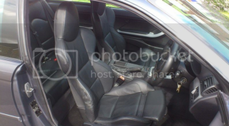

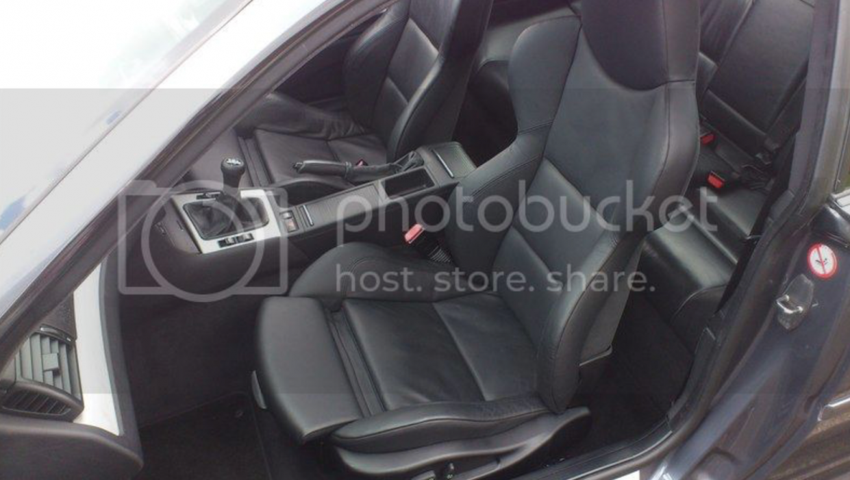

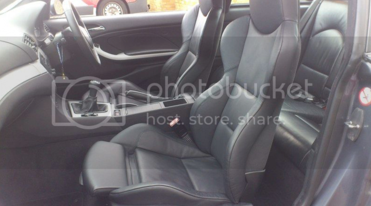

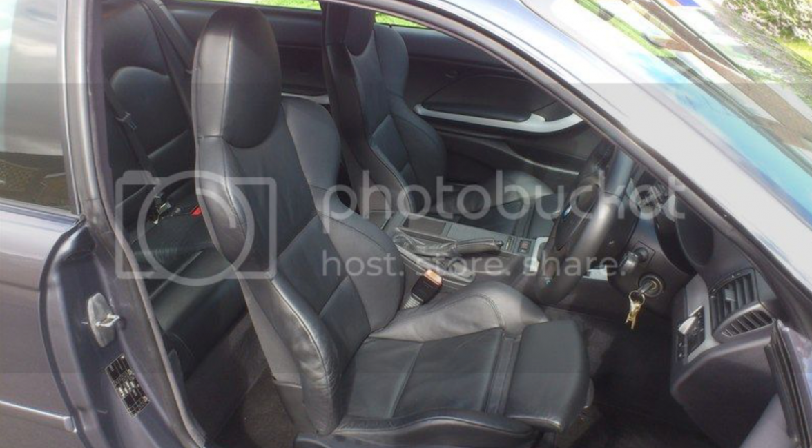

              One thing I was contemplating for my e46 touring are Z4 seats as they are almost CSL/Recaro shaped.
