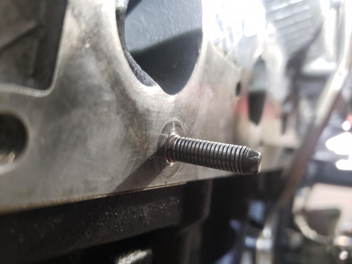

            Ok so I went forward and put in one stud, and the torn bit snapped of the head out of nowhere. Tried putting on the nut to get it off, and this is what it did to the threads.
            wtf???
              Homie, get the stock studs and throw those on. FCP has them on sale for $2.99.
