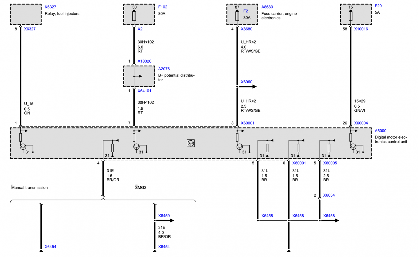

    DME supply (X60001):
    Click image for larger version  Name:	Screenshot 2023-01-20 at 5.35.27 PM.png Views:	0 Size:	372.9 KB ID:	201734
    I think pins 1, 7 and 8 are all on the same power plane inside the DME, but it's been a while. This would mean that K6327 (fuel injector voltage supply relay) gets switched on whenever the DME receives power. Can check later on my spare DME if it's helpful, but that's not really your issue here.

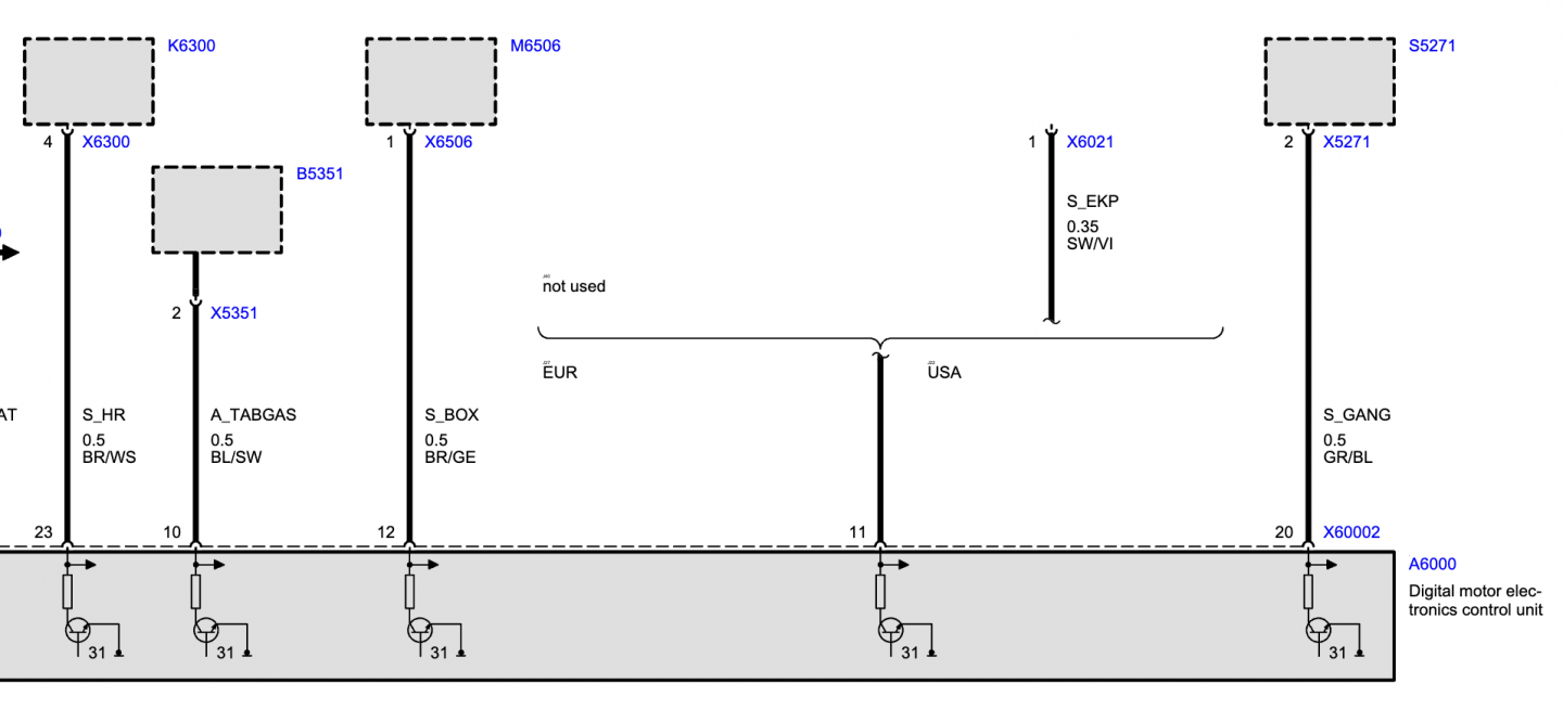

    Relevant part of DME signals (X60002):
    Click image for larger version  Name:	Screenshot 2023-01-20 at 4.59.31 PM.png Views:	0 Size:	324.2 KB ID:	201728

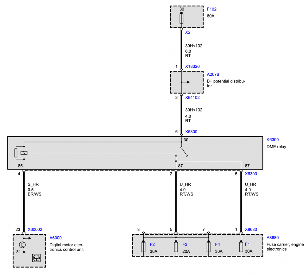

    I think K6300 is the relay you're referring to. Here's the wiring diagram for that:
    Click image for larger version  Name:	Screenshot 2023-01-20 at 5.00.20 PM.png Views:	0 Size:	361.9 KB ID:	201729
    Does the fuse box lose power when you disconnect X60002 from the DME? If so, then the DME is driving that signal pin for some reason. Otherwise relay is to blame.

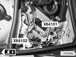

        Single red wire being X64101? You mentioned that disconnecting it turns off the relay. That plug powers the DME, so if the DME is off then the signal to the relay is gone too and makes it turn off. Try unplugging X60002, relay will probably turn off since that also removes the signal to it.
        Have a spare DME to swap in and test? Otherwise maybe some wire got pinched somewhere and is causing the signal to the relay to stay on.

            The red wire input to the relay K6300 in the wiring diag above, is always 12v un-switched, so it's normal, unless you're talking something else.

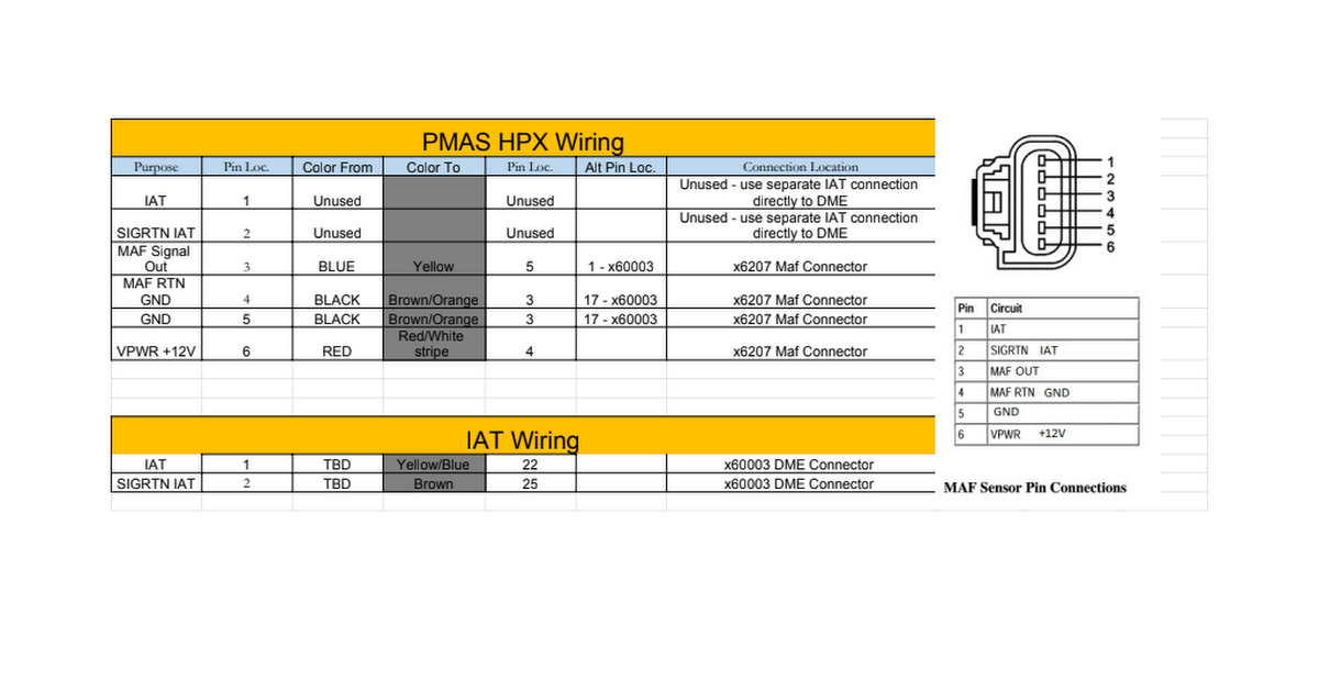

                    I think the issue might be in x60004 coming from the car. The ms45.1 has slightly different wiring than the mss54, however, I removed the wiring that did not correspond, specifically pin 5, 15, 19. I moved pin 28 to pin 34, pin 2 to pin 18.
                      For reference, see below excel for the differences. I wonder if not having a ground on pin 5 on x60004 is causing the transistors inside the dme to go nuts and not drain
                      PMAS MAF Wiring PMAS HPX Wiring Purpose,Pin Loc.,Color From,Color To,Pin Loc.,Alt Pin Loc.,Connection Location IAT,1,Unused,Unused,Unused - use separate IAT connection directly to DME SIGRTN IAT,2,Unused,Unused,Unused - use separate IAT connection directly to DME MAF Signal Out,3,BLUE,Yellow,5,1...

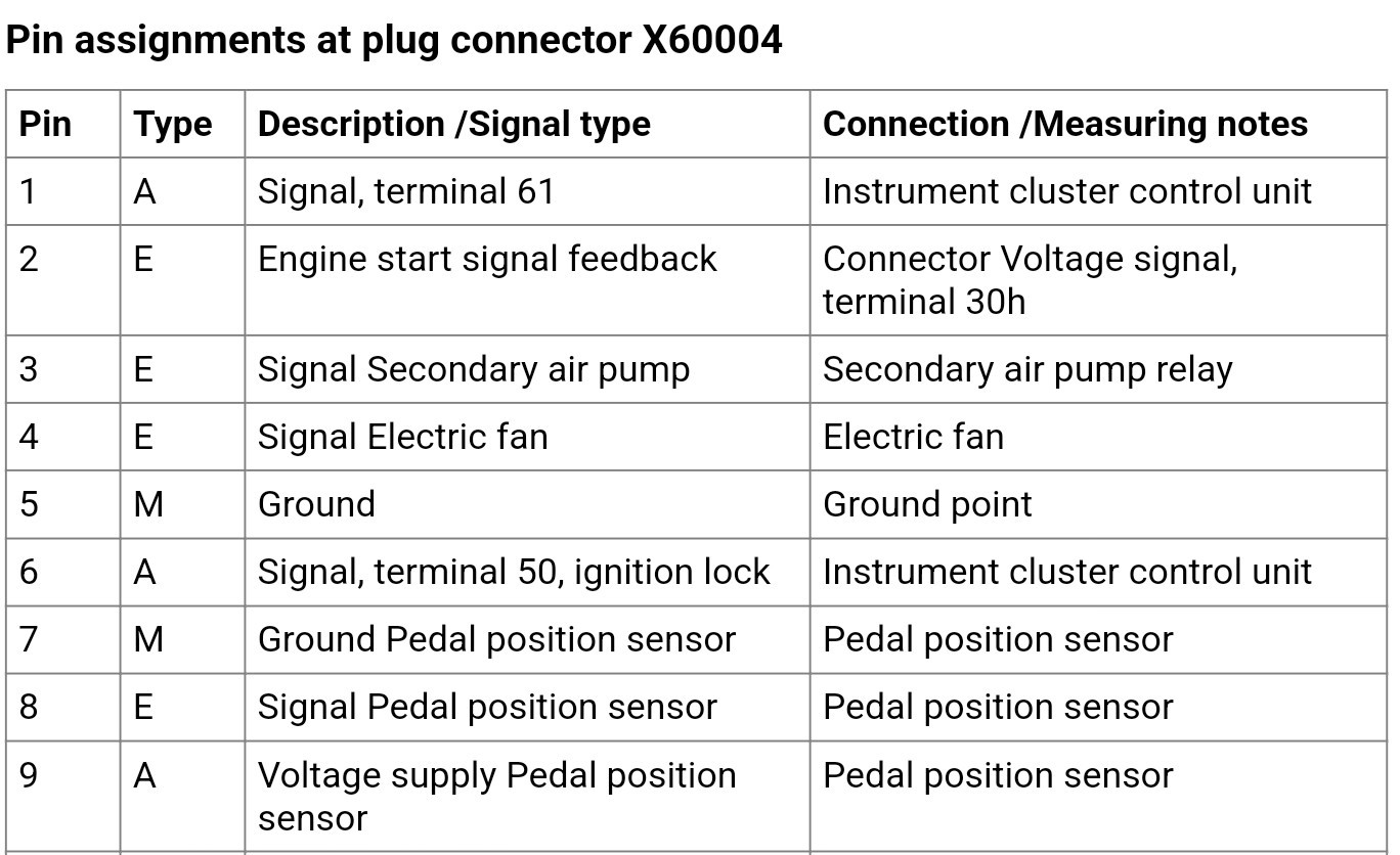

                          I added a ground on pin 5. No change. I ran to the dealer and picked up am ignition switch. That could manifest like this also. I couldn't find anything concrete that said that pin 5 on x60004 is actually populated. It does close to ground when the ignition is on however.
                            It is:
