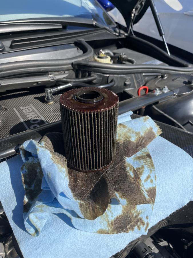

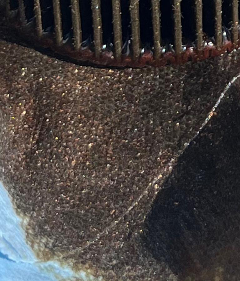

    Today, my mechanic came to inspect the car. We took out the filter, to find a considerable amount of copper shavings. See pictures below. Suffice to say, one or more of my rod bearings have failed. Surprisingly, when searching about this topic, I found VERY little. I will chalk this up to the old m3forum dying. With the lack of information/discussion on this matter out there, I figured I'd start my own thread.

    Option #1: Drop the oil pan, further inspect for damage, if the crank is not visibly damaged, plasti-gauge the crank to insure it is still within factory tolerances. This will set be back roughly $900. My biggest concern is that it will ultimatly be for nothing (damaged crank), and I will be throwing $900 down the drain for nothing. If by some miracle the crank is unscarred, simply install fresh bearings, and be vigilant about fully flushing the contaminated oil.
    Option #2: Source a core. Throw the fresh VANOS unit from my engine onto the core, throw rod bearings in, and install the core into my car.
    Option #3: Rebuild my engine, expecting a new crank needing to be soruced. Mahle Motorsport pistons, forged rods. Machined block. The works.

                I would try option 1. Take it apart. Inspect. The bearings are sacrificial, so if they haven't been chewed through to the point of scoring the crank badly it might still be fine.

                      How does the crank look? To me, that would determine my approach/options...
                        This is a discussion based on nothing - pull the bottom and see how the crank looks - THEN decide what you want to do.
